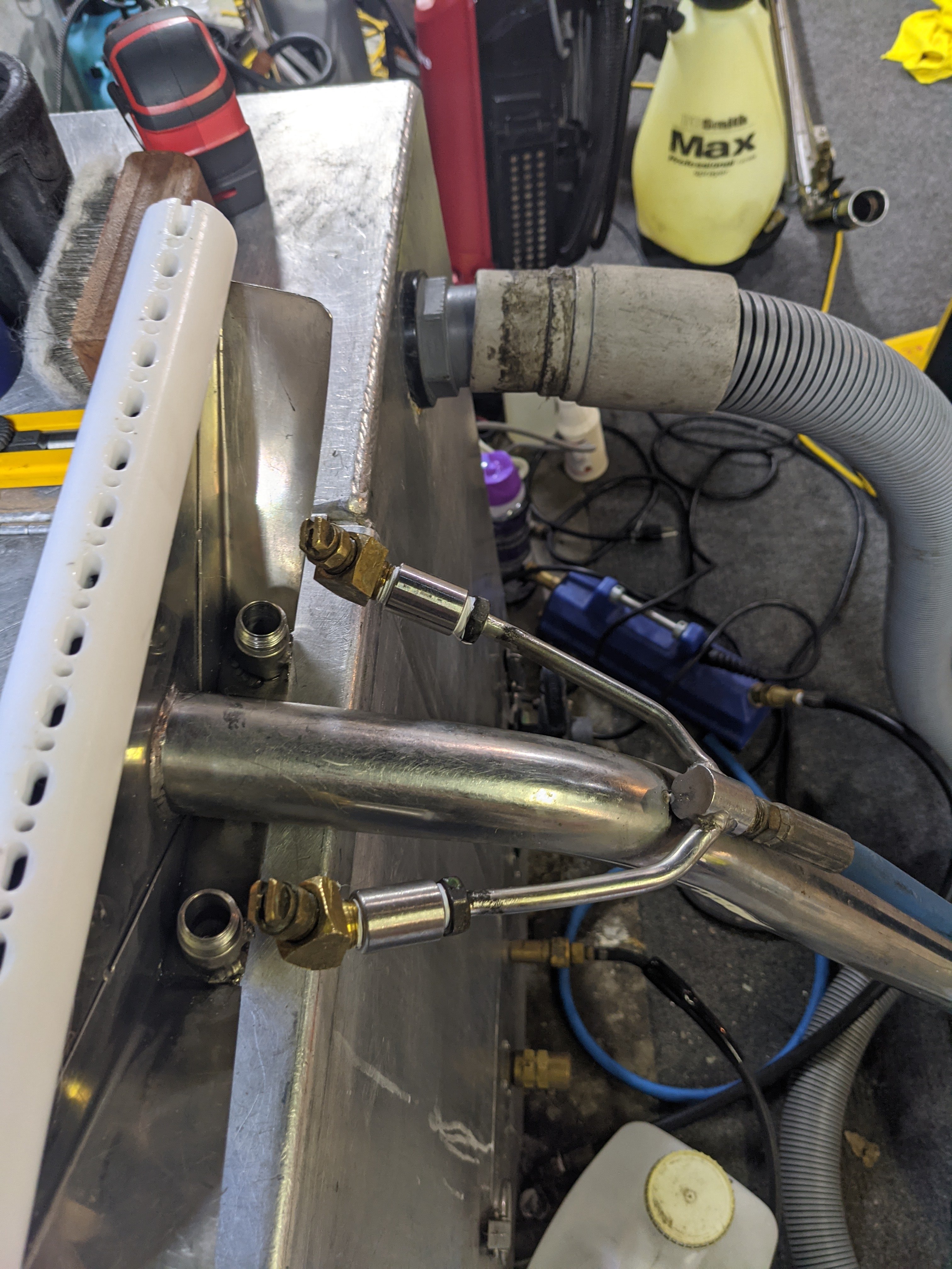

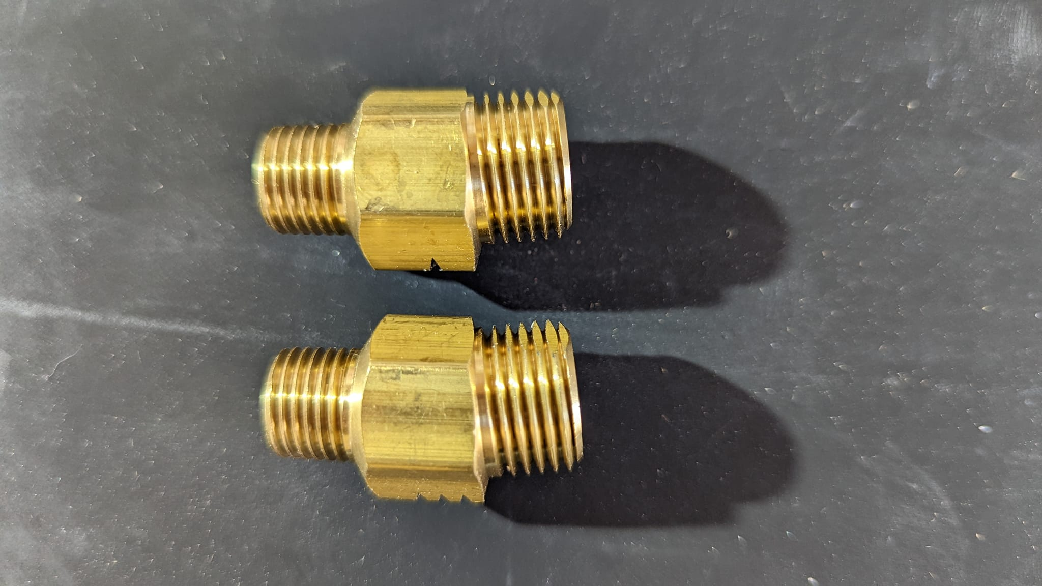

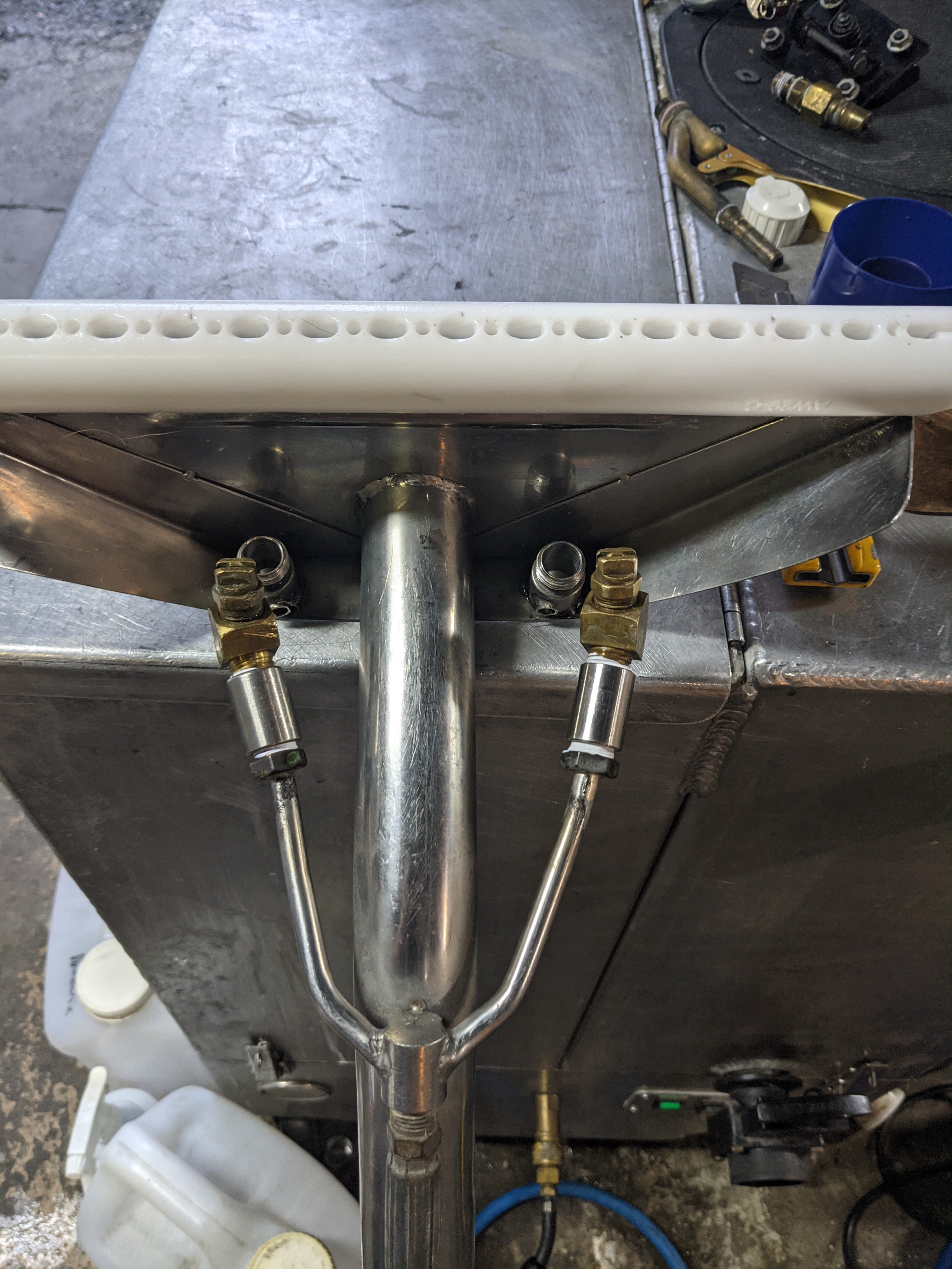

Got my AW29 back from my fab guy. Works great. Gives a sheer angle to just before the glide. I just need to pick up a couple of 11003 vjets. I have a couple of mismatched jets in there for the test and it looks great. I'll try to do a video when I get the new jets.

but I'm glad you see the sheer benefits
I'll be able to compare it to my other wand. They both are pretty well identical. I usually have one set for the truck and the other set for the portable. Now that I see how it works, I may attempt the other by cutting and using a flare nut fitting.

117,395
I have to wonder a few things..
will that Y vibrate, hum or whistle?
what is the cost for all those fittings?
how long will it stay true in your van?
are the jets as misaligned as they look in the 1st pic?
what size jets?
28,284
what size jets?
Going to use 11003 jets. So far, no humming or whistling. Those supply tubes are sturdier than they look and doesn't seem to vibrate. Everything is adjustable to get the right pattern.
