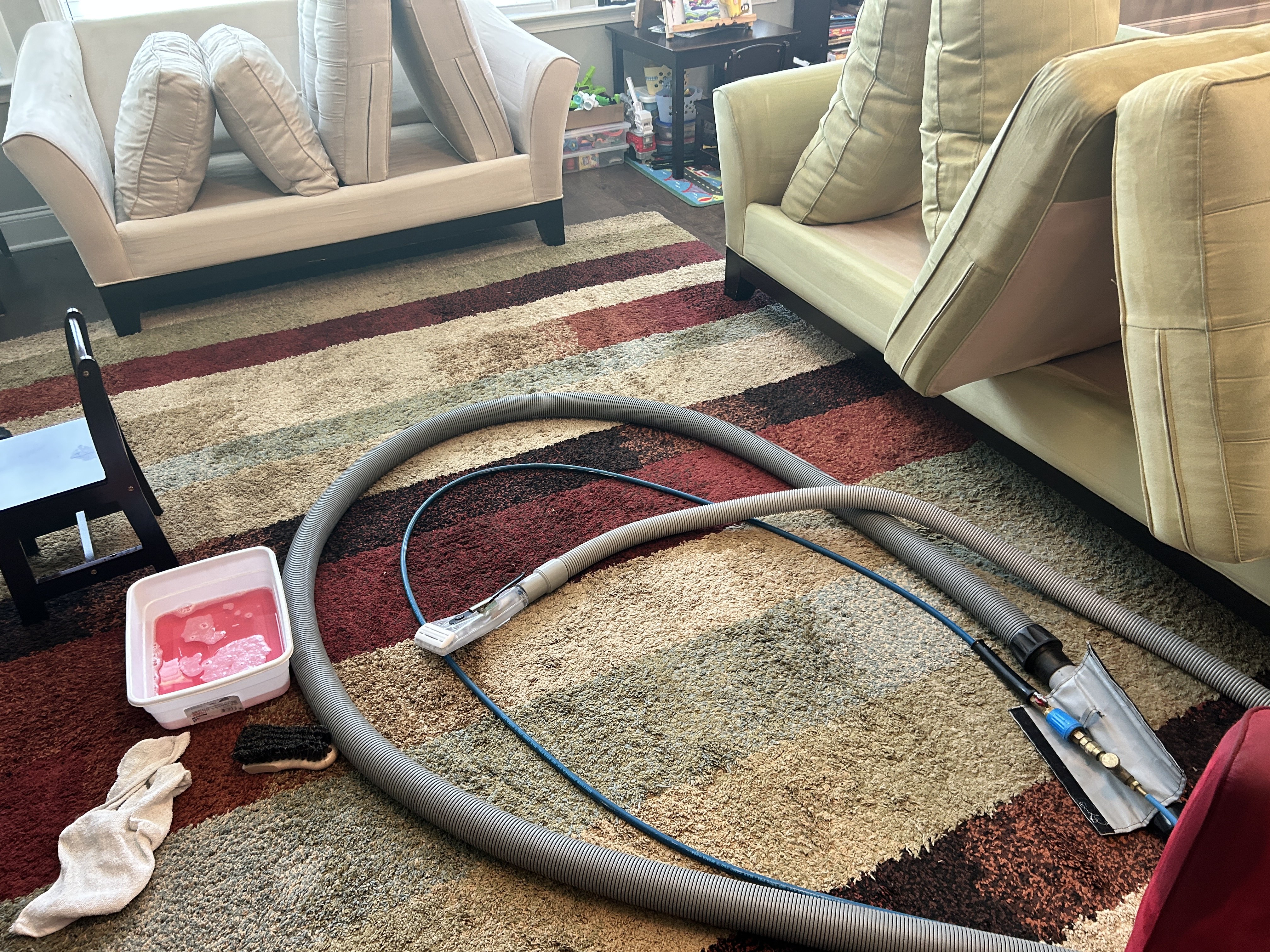

So today, I had to clean 12 white dining room chairs. Heavily soiled from dirt and food. I put on my latex gloves, grab a pack of microfiber towels, and scrubbed them all down with a peroxide-based cleaning solution, followed by another scrubby with AFR powder, then ended it with a dry towel scrub-a-dubba.
It has been my experience that this gives a better finished result vs HWE. Took me about 35–40 minutes to do all the chairs.

You can probably skip the Afr powder. Most peroxide encap products are acidic.

I'll never understand the logic behind spending more time buffing and sucking the chairs vs just going over it with a quick spray and upholstery HWE tool. It can't be any faster
Can someone show a real time video of this method compared to HWE it?
I was just being silly. But…
Theater seats/ Church pews / Office chairs/ Hotel Furniture I would definitely encap. No extraction. Just scrub and go. All other upholstery I would HWE unless I thought there was going to be a secondary issue after dying. Such as white chairs I did the other day. Which by the way I got a nasty chemical burn from even though I was wearing gloves. The customer gave me a $50 tip on top of a $300 invoice. I’m not bragging about the money. Just making the point that customers was pleased with the results.
Am I a VLM preacher. No. It does have its place though.
