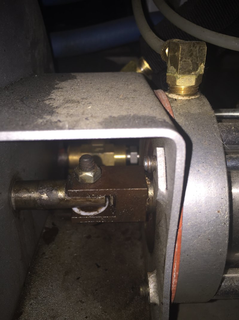

That Bimba valve is all the way out which is off. The exhaust is bypassing in that mode. I don't know what happens on the other end I haven't seen. I know how my last one worked and if the flex coupler was turning so was the diverter. Spend a few minutes and watch that shaft as it warms up. Is it moving in and out ❓
11,577
It never moves out of this position
D
dgardner
Gene, according to the diagram out of the manual (that I posted earlier), that position is bypass closed (full heat, not bypassing) which would match the symptoms Sam is experiencing.
D
dgardner
Sam, with the unit not running can you move the shaft in towards the hx with your fingers? I tend to agree with Tom it looks kinda gummed up and may be physically stuck.....

11,577
I actually greased it and sprayed some wd40 on shaft thats why it looks funky. no it wont budge but I have been doubling up on wd40 at the vacuum inlet hoping it will loosen it.
I'll watch mine this morning when I start. I swear I thought mine is there when off and goes all the way out when on. It would make more sense his is stuck on.

On all Sapphire units the divertor valve operation is as follows, IN - clevis stroked toward the back of the machine is off no heat, OUT - clevis stroked toward the front of the machine is heat mode, controlled by the temperature control.

Somehow I have it backwards in my head . You re right , At startup mine is towards the back of the machine. It pulls out to engage the heat. I would have already pulled the pin and checked that shaft if it's was mine. I'm quick to jump in. I'd check with sapphire before I twisted it with a pair of channel locks but I see if it will push in and out without the bimbo valve attached.
Gene
11,577
You can pull the pin from the fork on the shaft. Use a pry bar to see if you can move the shaft.
Actually I did what Gene said and wiggled the shaft and it move pretty freely just wont go back and forth believe its locked up on the bimbo valve side took the little hoses off and wate dripped out

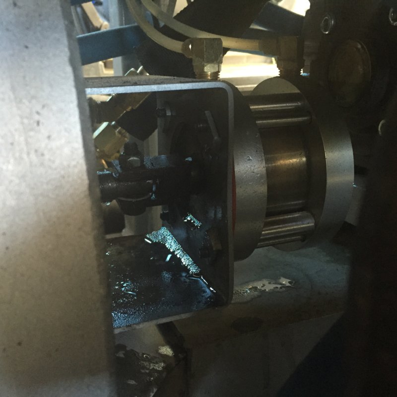

The bimba valve moves the shaft. If you pull the pin from the fork that holds the shaft you will bypass the bimba valve.
Use something that you can push/pull on the shaft. It should move in and out without a lot of effort.
11,577
Bimba valve full of water??? Cleaned it out putting it back on now. No wonder empire didn't want to mess with it!
You can never let your machine get full because the shut off doesn't shut off until water pours out the front of machine.
You have to have s pump out and make sure it works. If the bimba valve gets water in it it will get stuck

Even if water does pour out of the blower it shouldn't get in that bimba valve. The valve uses air to move in and out so if it got water in the line that can't be good. If it was mine I'd take it apart and clean it out and verify air will make the cylinder move before installing it back in. Mine looks like stainless but I didn't verify it. Hopefully the water didn't hurt it.

We put the bimba back in after cleaning put it in off position fired it up and pulled to on position heated up but won't go to off position stays on.
We reversed air lines and it stays off.
Sapphire is sending a new Mac valve hopefully that will belp
