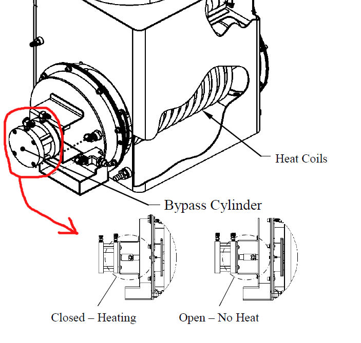

That valve when things are working correctly with the temp switch will go out to heat and when it hits its temp, it goes back in and is automatic and controlled by the temp control and mac valve, the bimba valve has 2 hose which come from the mac valve that operate by vacuum of at least 7 hg.
If you were getting no heat you could pull both hose off the top of the bimba valve easily and manually pull the piston out and the machine would heat constantly.
if the two hoses on the bimba got reversed by accident then the machine would stay in closed mode and not heat because the vacuum hg's that usually open it would be obviously closing it.

Well, If the divertor is not working, I would assume I have limited heat. It takes maybe 3 hours to get up to 195 degrees. It is working off of the liquid heat exchangers and that's it, so it doesn't hold consistent heat.

ya if you stick the divertor in bypassing most of heat, the machine if your lucky it hits 170.

I dont want to be a broken record but when I've had water come out the blower exhaust, I've taken both hoses off the bimba to hopefully let any excess water drain out and not into the bimba. because when my bimba frooze on it was full of water.
