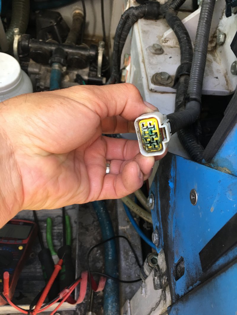

So I posted on Facebook a video with my 570 sounding like a lawn mower.
Ended up being the computer controller and computer harness assembly.
Procyon as a rinse in the jug and for some reason my guy is getting it every where.
The brass pins were completely dissolved.
Ended up replacing the ignition coil to.
And overnight shipping cost about 1k
Oh well.

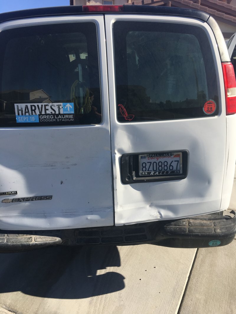

Got rear ended yesterday freeway became a parking lot and he stopped on time
But the guy behind didnt.
11,570
The good news is the back doors open
and close.
