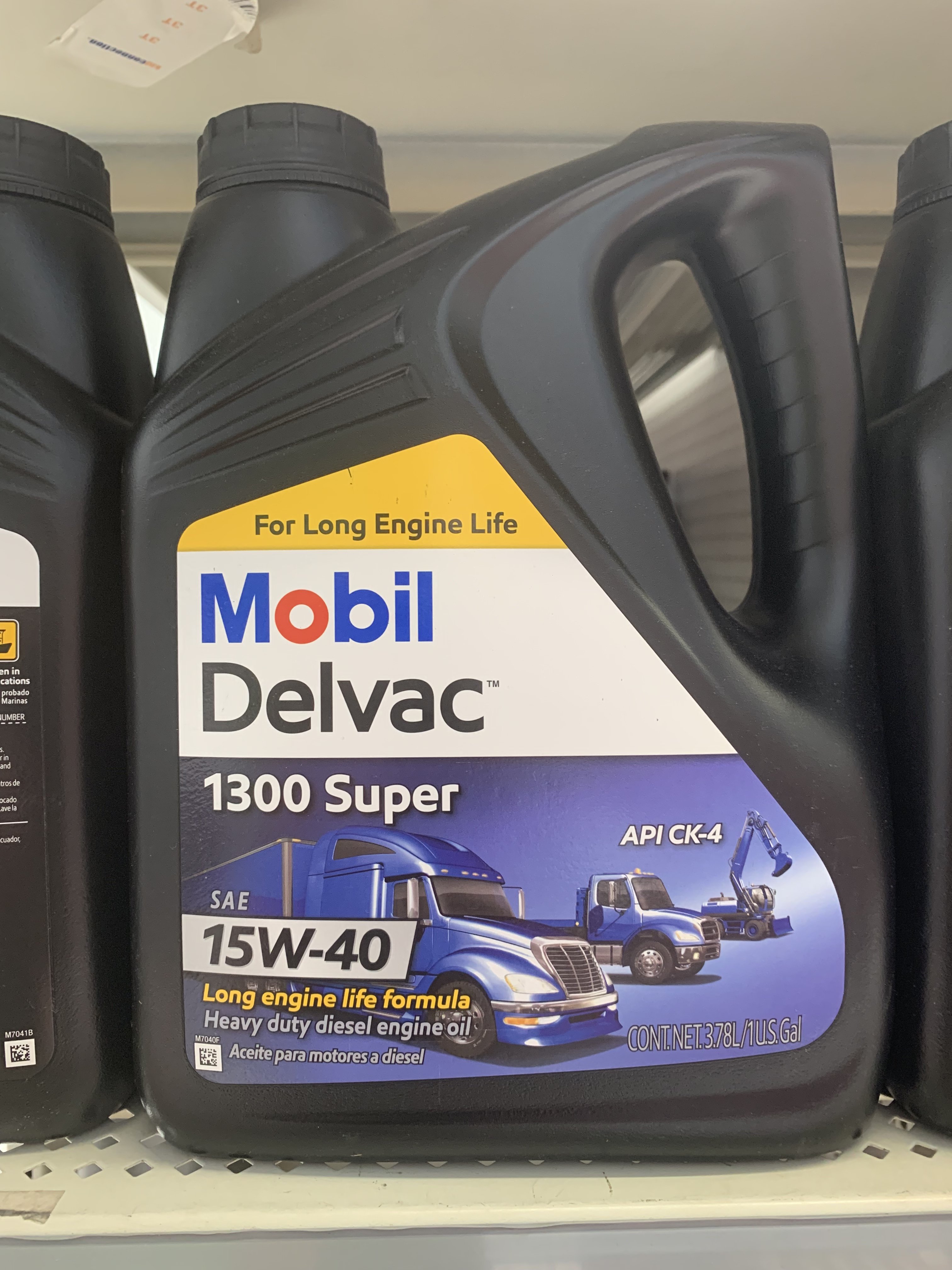

Jul 13, 2019 #1 W Wade A Member Joined May 15, 2019 Messages 40 Name Wade Is this good for 370 water pump
Jul 13, 2019 #2 jcooper Member Joined Oct 7, 2006 Messages 3,232 Name Jerry Cooper That's motor oil for a diesel engine... I believe the manual for a 370 recommends 30 weight oil. You should make sure(check the manual), pumps are not cheap! Reactions: Wade A

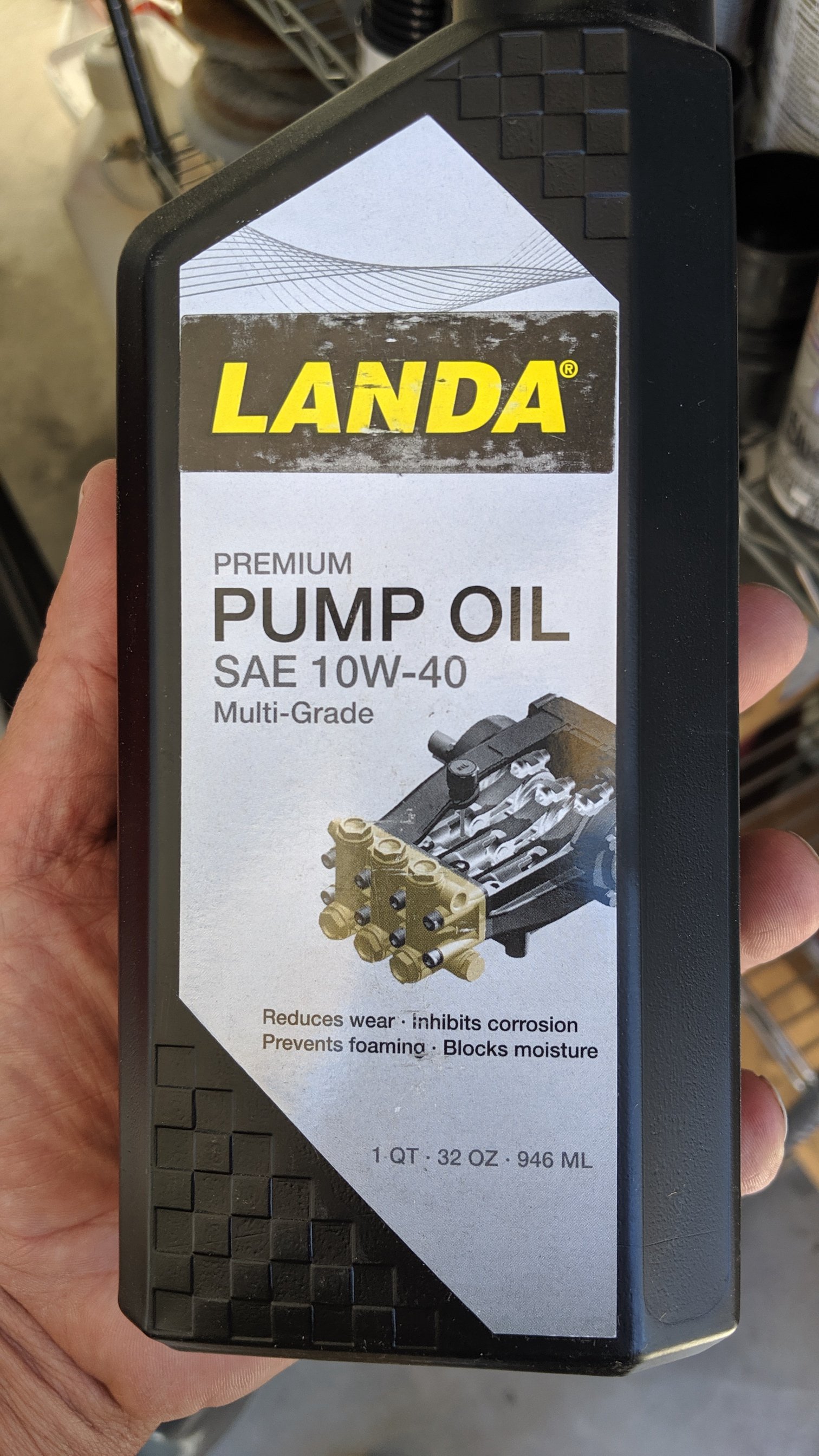

Jul 13, 2019 #4 W Wade A Member Joined May 15, 2019 Messages 40 Name Wade Mikey P said: Heck no. Click to expand... What do you use?
Jul 13, 2019 #5 Mike Pailliotet Administrator Joined Oct 6, 2006 Messages 117,378 Reactions: Cleanworks and Wade A
Jul 13, 2019 #6 W Wade A Member Joined May 15, 2019 Messages 40 Name Wade Mikey P said: View attachment 92179 Click to expand... Thanks Mikey
Jul 13, 2019 #7 BIG WOOD The Timminator Joined Feb 4, 2016 Messages 14,646 Name Matt w. I bet the manual says 15w40 just like mine did on my Titan. I used 15w40 for over 500 hrs with no problem Reactions: Wade A

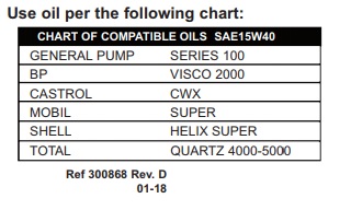

Jul 13, 2019 #9 F FB19087 Guest that delvac would be fine but if you want to use manufacturer specified oil (general pump right?) Reactions: Jim Pemberton, Nomad74, Hack Attack and 2 others
