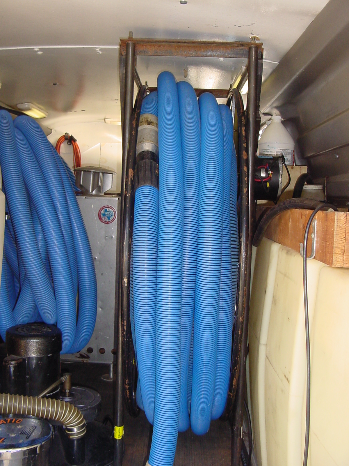

The 5 or 6 foot piece of 2.5" that is use from the unit to the filter just sits on the floor or drapes over the reel. I carry two 50' sections of 2.5". Not like handling 2" but my set up makes it painless. I turned my motorize reel upside down and mounted it on four lengths 3/4" pipe with closet flange screwed to the floor. This allows me to easily fit the 2.5 and 50' of 2 on the reel without it falling off the sides. I have another 50' of 2 hanging in the van. The 2" is only used inside and the 2.5" always stays outside. Most of the time I will just have one section of each off the van and even though it's probably not necessary it's just as easy to use as 2 sections of 2.
