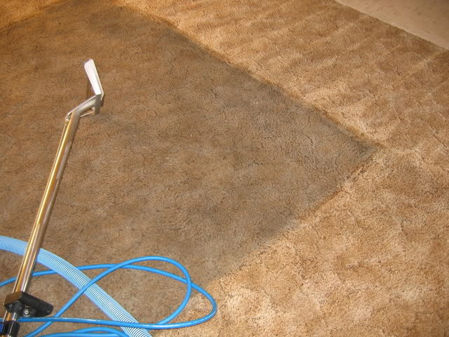

Do you remember the first time you really pre scrubbed a carpet?
I'm not talking with your shoe or a lame Grandi Groomer, I mean with a 175 floor machine or maybe a Cimex or CRB?
What was your reaction?
I did this back in my POG/Millers days but when I went to Coitus I sold the 175 off thinking a TM wouldn't need prescrubing.
Boy was I wrong.
I got by for many year without scrubbing by using way too much pre spray, heavy rinse agents and too many wand passes.
