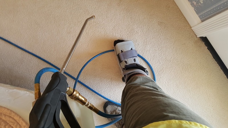

I'm no @Mark Saiger , more of a @Mikey P with a broken foot cleaner...

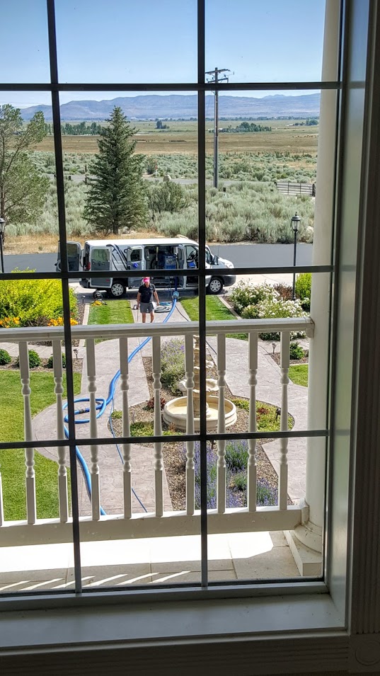

I'm no poser..
odYl8rB2-tsnbmOSWvcJQkmqqer0q7VgY459Ep21UNodynhrH4HkMKF1_EicxKTC36QtLH-tRtf2o5xJS9=w1699-h955-no.jpg
there's my Aron..
