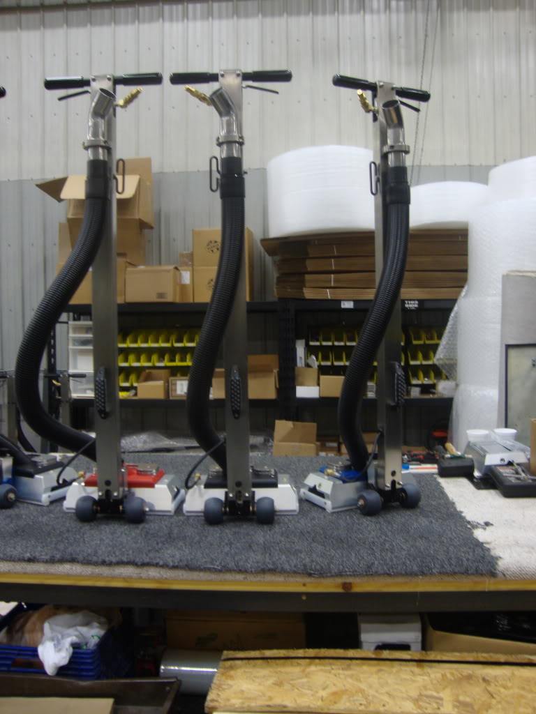

Better late than never!!

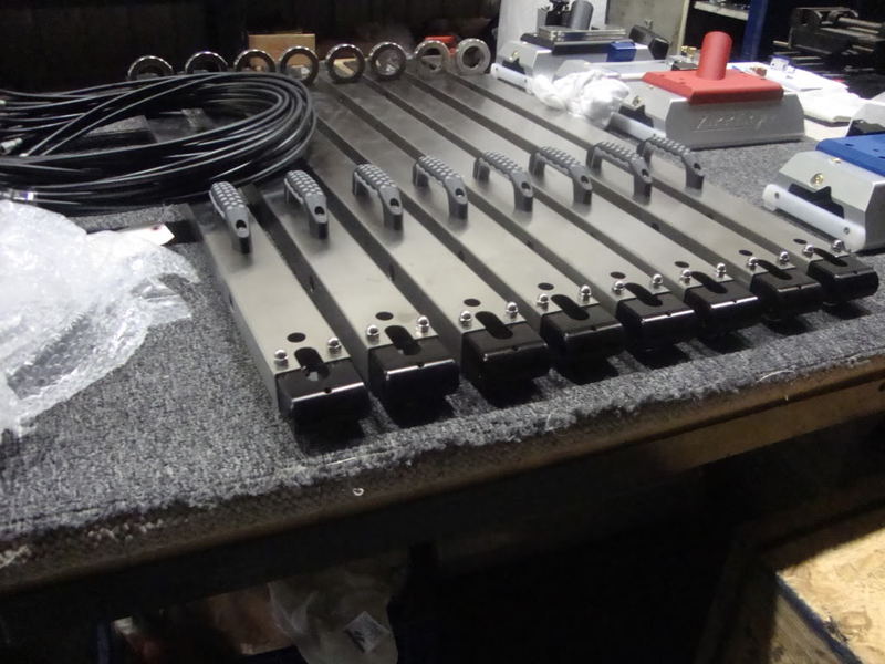

Thats funny :lol: It's a cardboard cover for the threads on the adjustment knob.

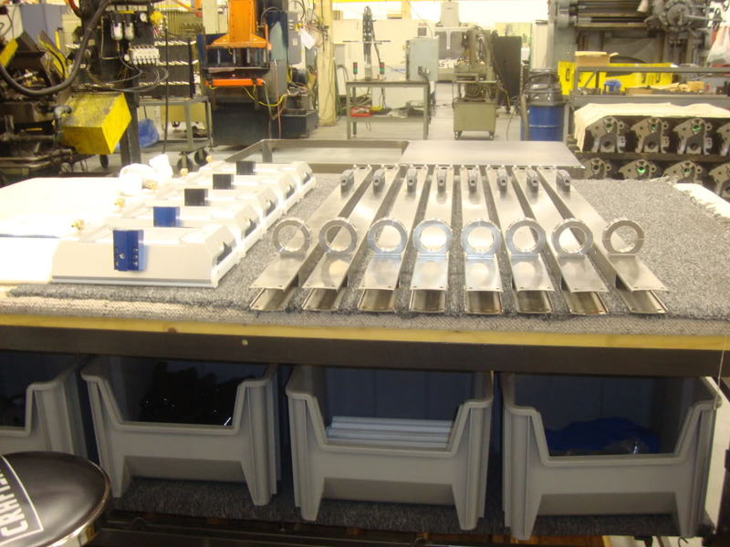

joeynbgky said:
Is that your shop? Its really nice, looks like you have everything you could ever need.
No, it's a customer of mine who has become a very good friend, a very gracious man. He has helped me through this whole process.

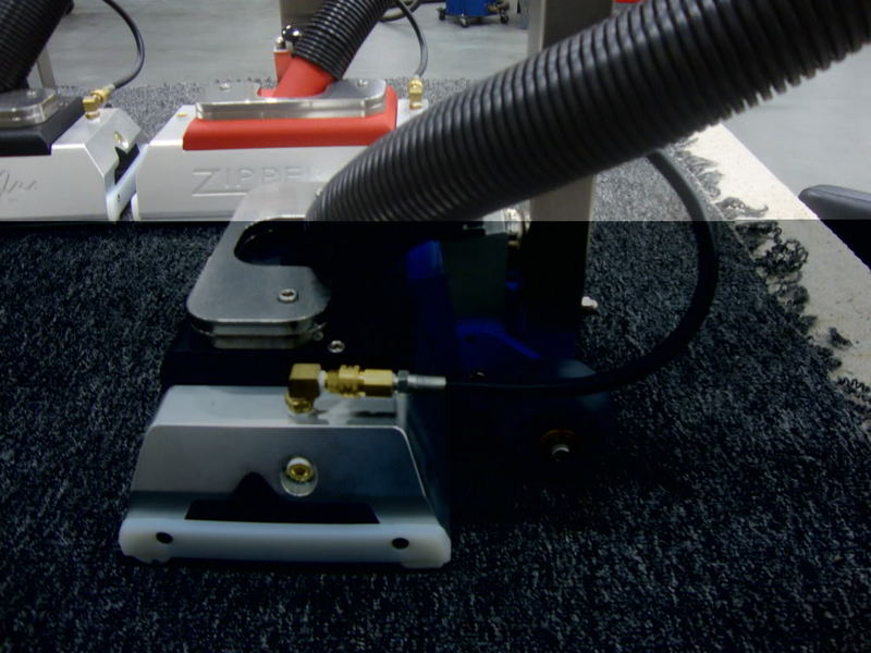

floorguy said:
I meant the white SS lip protectors

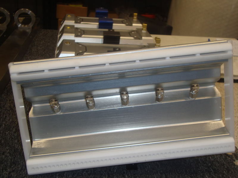

Oh, I thought you could see this on the other picture. As far as the teflon glides are concerned, my back hole glide (the one in question by HR) is square shapped on the bottom and is not reversible at this time. The bridges on the slot glide are recessed far enough into the glide that you won't wear the glide out enough so you will not leave bridge marks.

is that 2.5 hose i see?
great looking tool. def. cant teach the coach the chinese to do that one over the phone!
you know what would be sweet? if you used clear hose in it, RX-20 style.

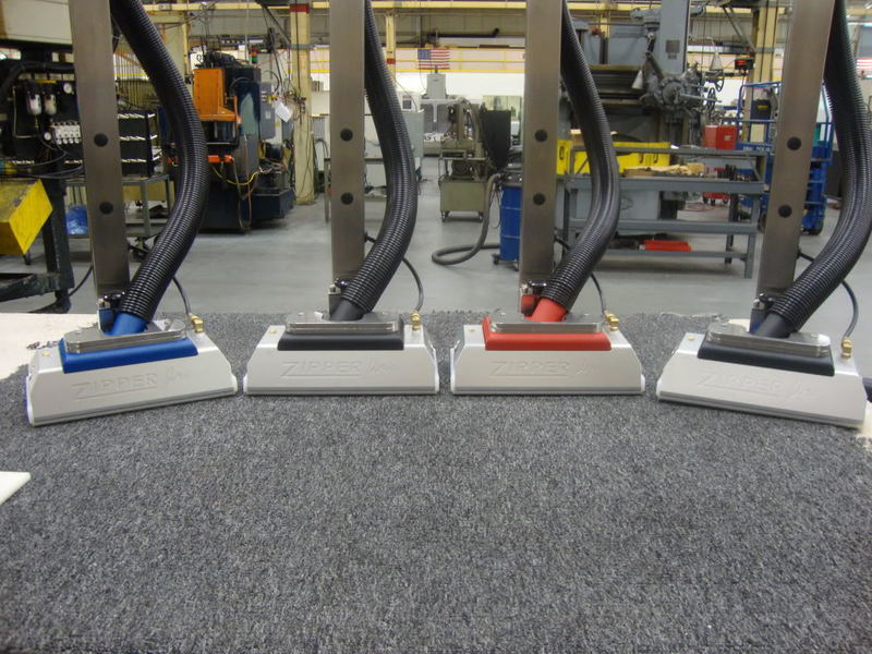

Looks very impressive.
Where would you rate it performance wise, against the rotary type extractors such as the RX20, DriMaster, SpinMaster, Rotovac 360i, etc;
Will you be demo'ing it at Connections ??
Tell me before I spend my money. :roll:

It's 2" hose. We have tried the clear hose, but it has very turbulent air flow, due to the hose not having a smooth bore on the inside. We use Amflex hose.

For commercial carpet cleaning, I would rate a rotary extractor at a 7 & the Zipper at a 10. It's faster & dries better. For residential cleaning on very trashed carpet, a rotary extractor does a good job if you want to take the extra time. On average soiled carpets that you would normally wand, the Zipper is faster & dries quicker with less fatigue on your body.
We will be at Connections this year, make sure you bring a big golf bag to take one home with you. shiteatinggrin

Don't forget that the Zipper has a more even jet pattern than the Ti wand. Just another advantage besides being able to clean in both directions and with a flexible arm.
