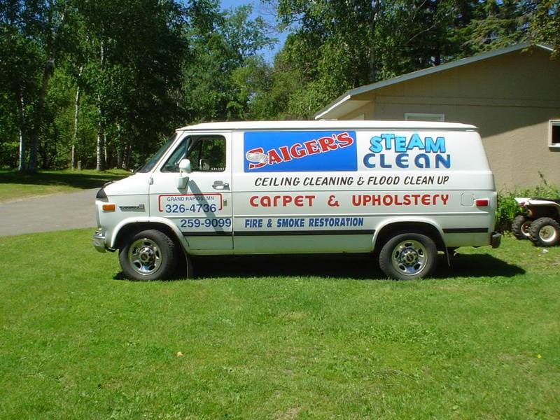

I have one of our old 93 GMC and Butlers showing up today at my shop. Over 260,000 miles on the van and original motor and drive Trane, as well as over 11,000 hours on the Butler unit. That's about 593,000 miles on that ORIGINAL motor. Transmission is also original.

My old High School Band director owns this thing now and cleans part time with it.

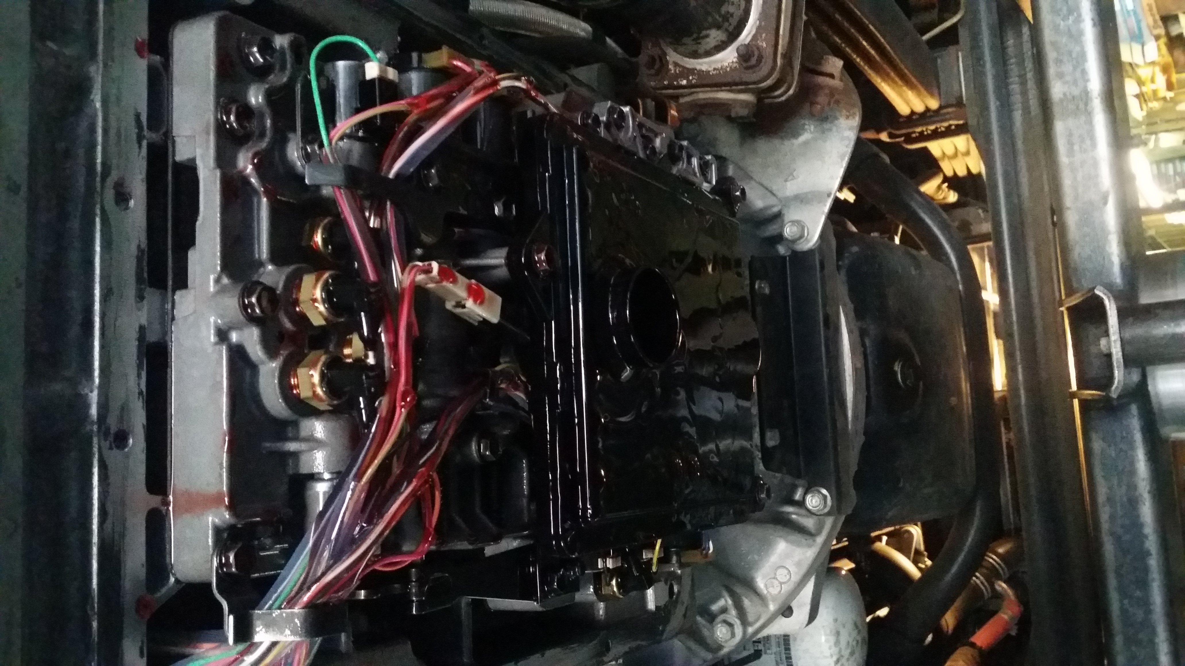

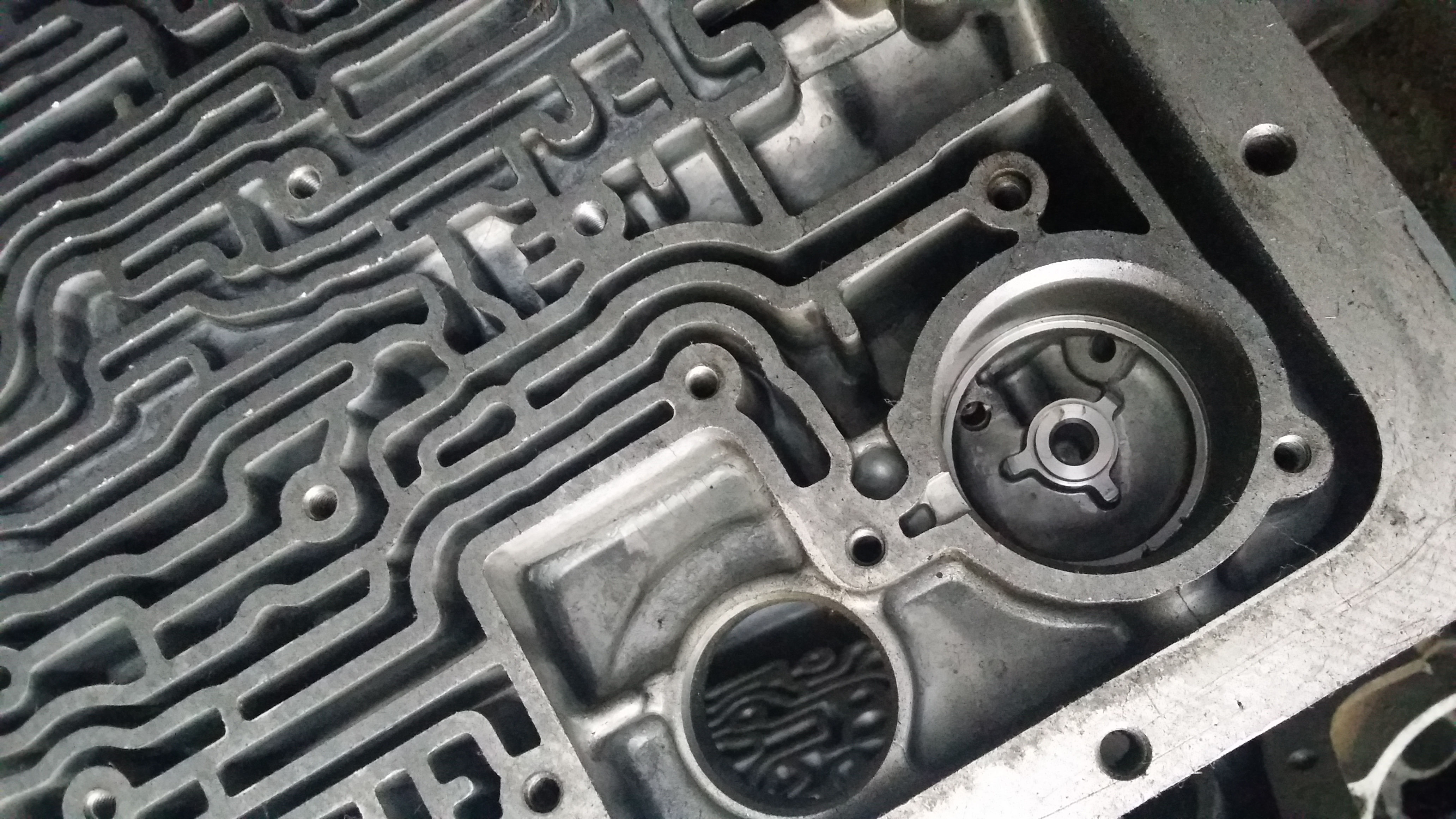

At the tranny guy now getting a full service, flush and filter
$250 worth of fluid alone..yikes
Ever seen inside an automatic transmission? (Not mine)
