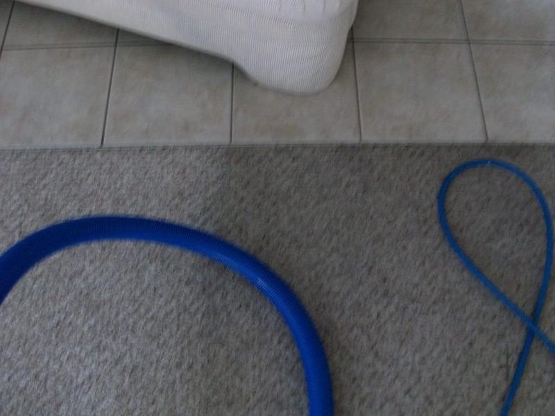

Huh? This is no prespray clean with a porty no scrub and just Ultrachem Extract powder emulsifier on dirty olefin. Looks like it cleans pretty good to me.....
