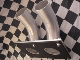

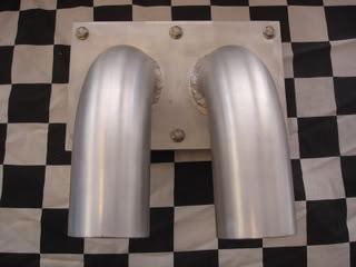

And to answer Steve Snail, on a #4 blower with a 2.5" intake, I think the law of diminishing return will kick in, so No I don't think you will notice a vacuum increase by bolting one of my 2.5" elbows on the tank, your stock twin 2" plastic fittings are fine.
