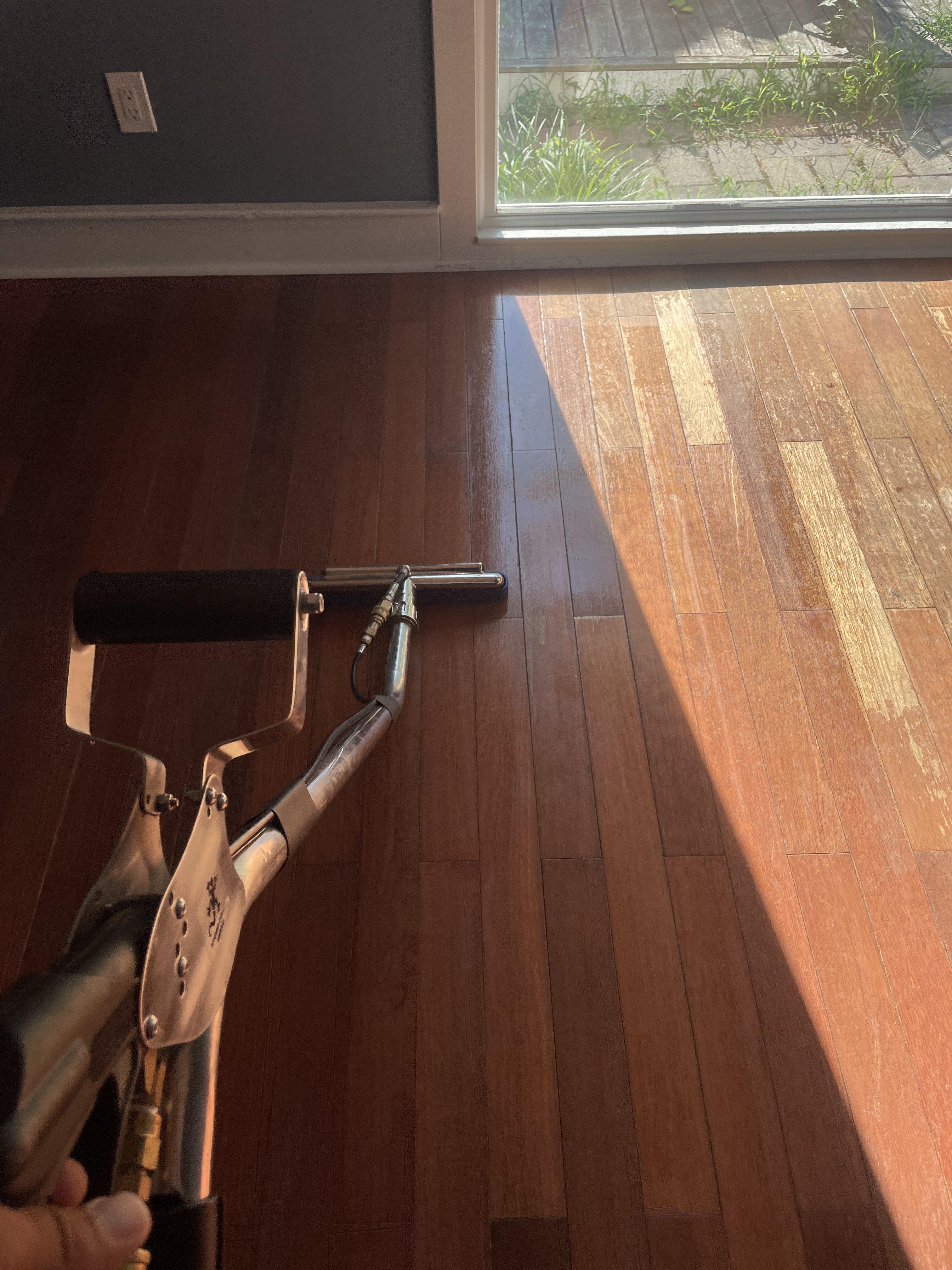

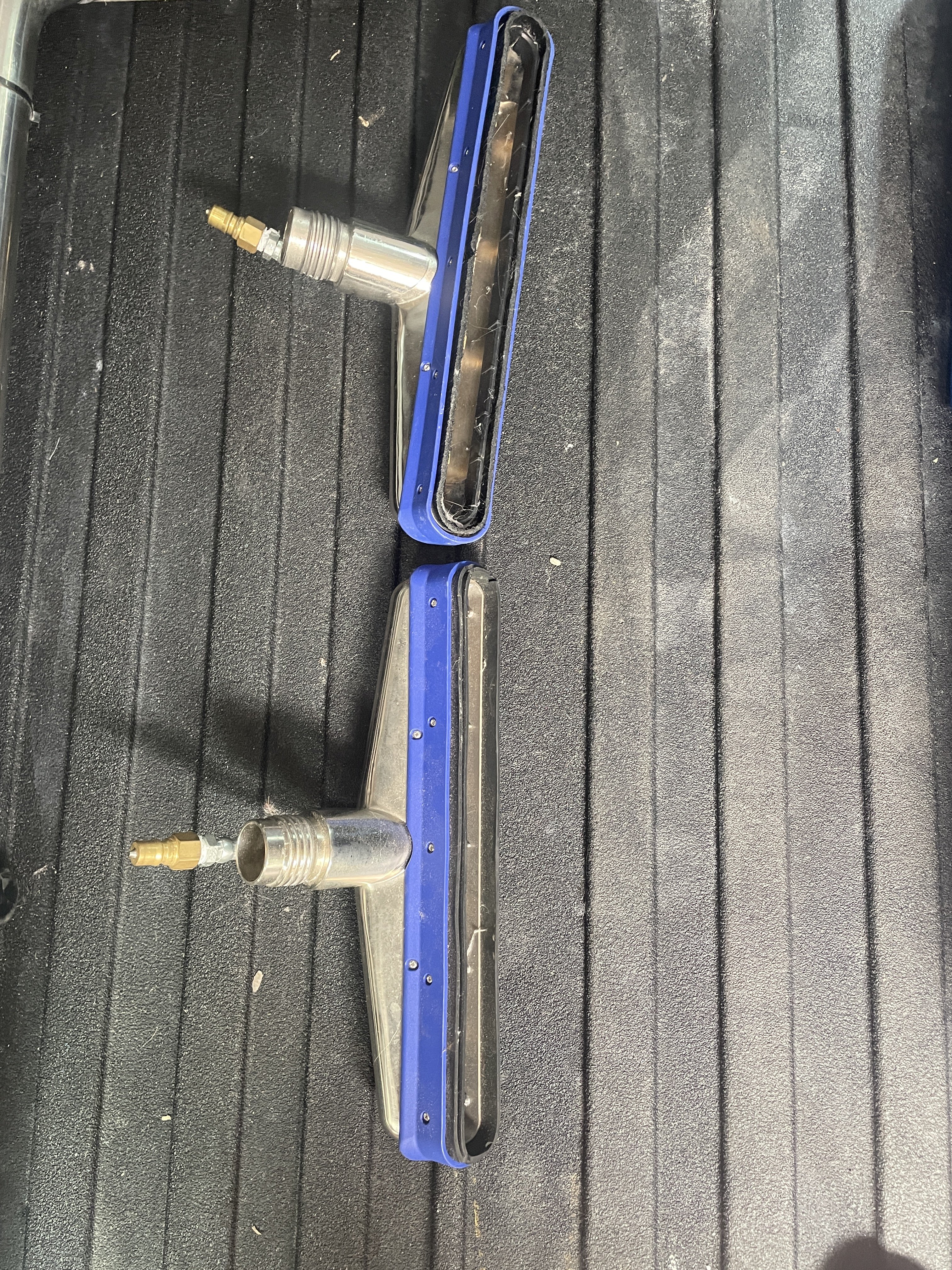

I want to HWE and vapor steam this wood floor. Using the Hydroforce tool with the brush.
Pressure 3-400 psi and go low moisture HWE. I got some Squeaky product (looks) Like windex. I run the HWE and another guy Vapor steams and Microfiber Follow Up Immediate.
Work it in 10 X 8 squares.
What do you think. long time customer moving in to place after a rental trashed it. I took care of the carpets today, the place was dirty.

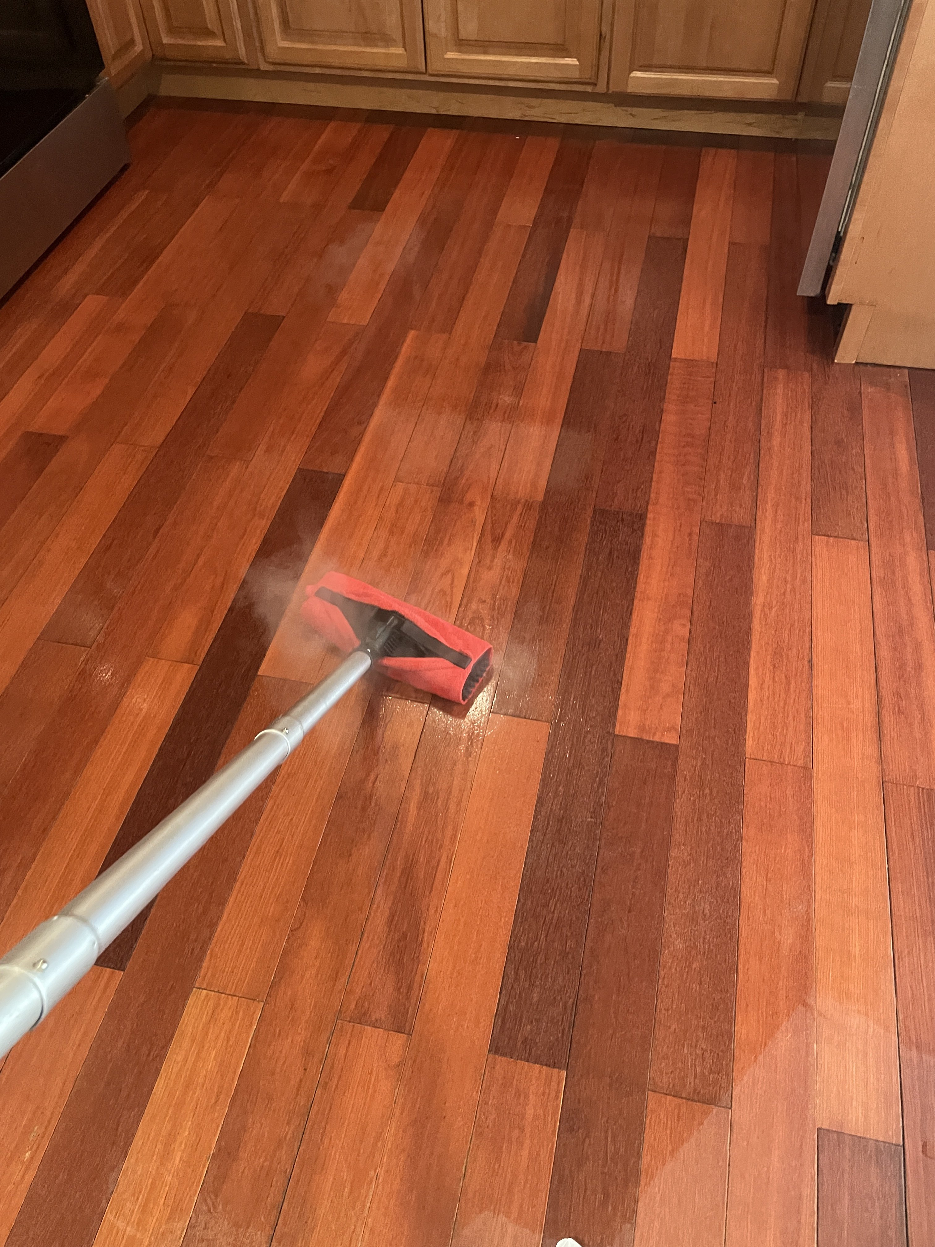

Yes, im just talking getting the grime out of the seams. I have a day off tomorrow and I texted the owner and they are glad to let me give it a go. its a perfect opportunity with no pressure. the place was pretty nasty. I will get before and after pics.

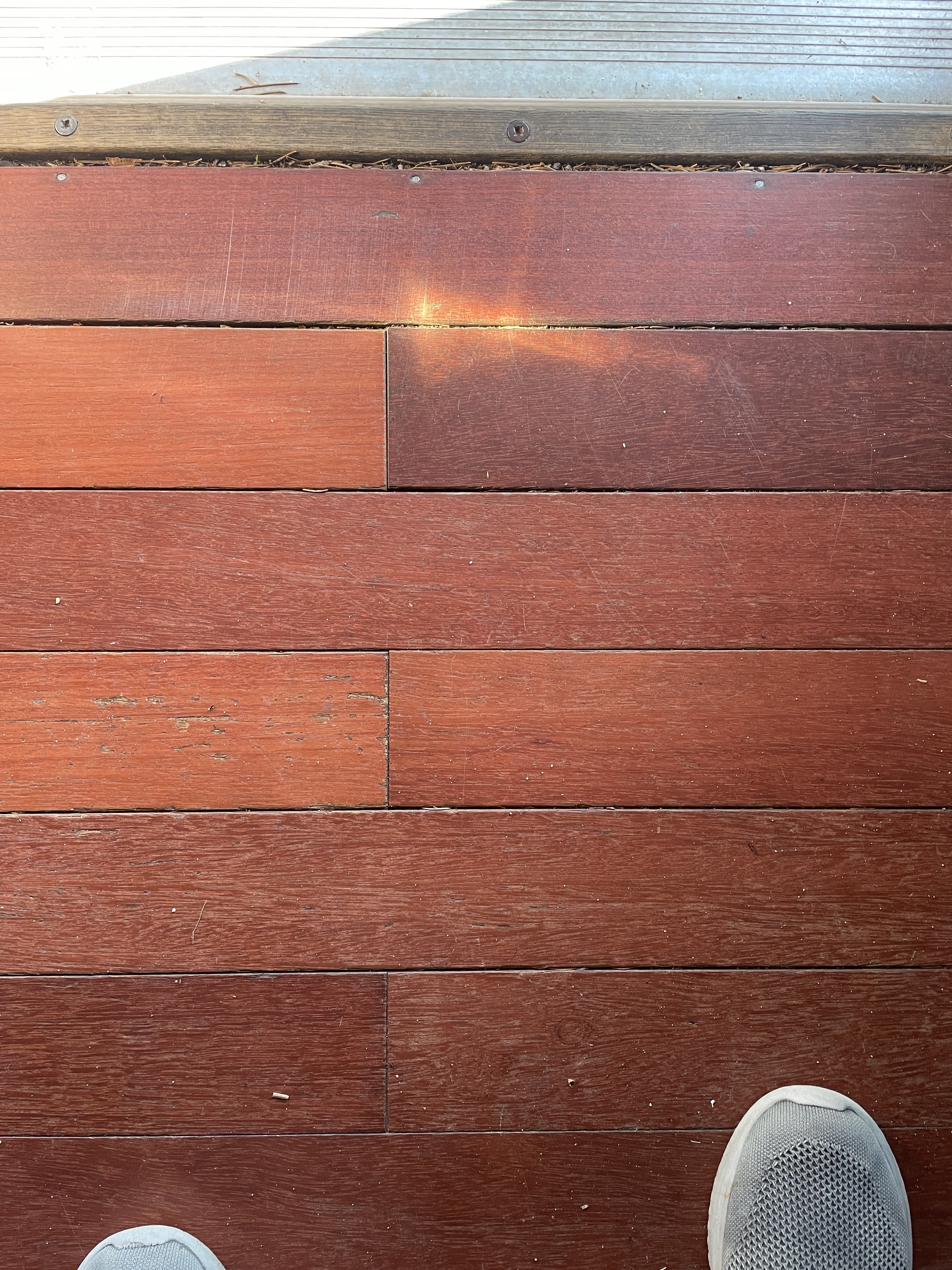

what's with the steam??
light shining by the slider magnified, looks like the seams are already peaking
and it's a Homer install
I got vapor steamers that kick ass. I vaped cleaner floors just because they wanted me too. Its all about quick dry follow up with microfiber. Hopefully I will have some incredible results. 9 hrs away....

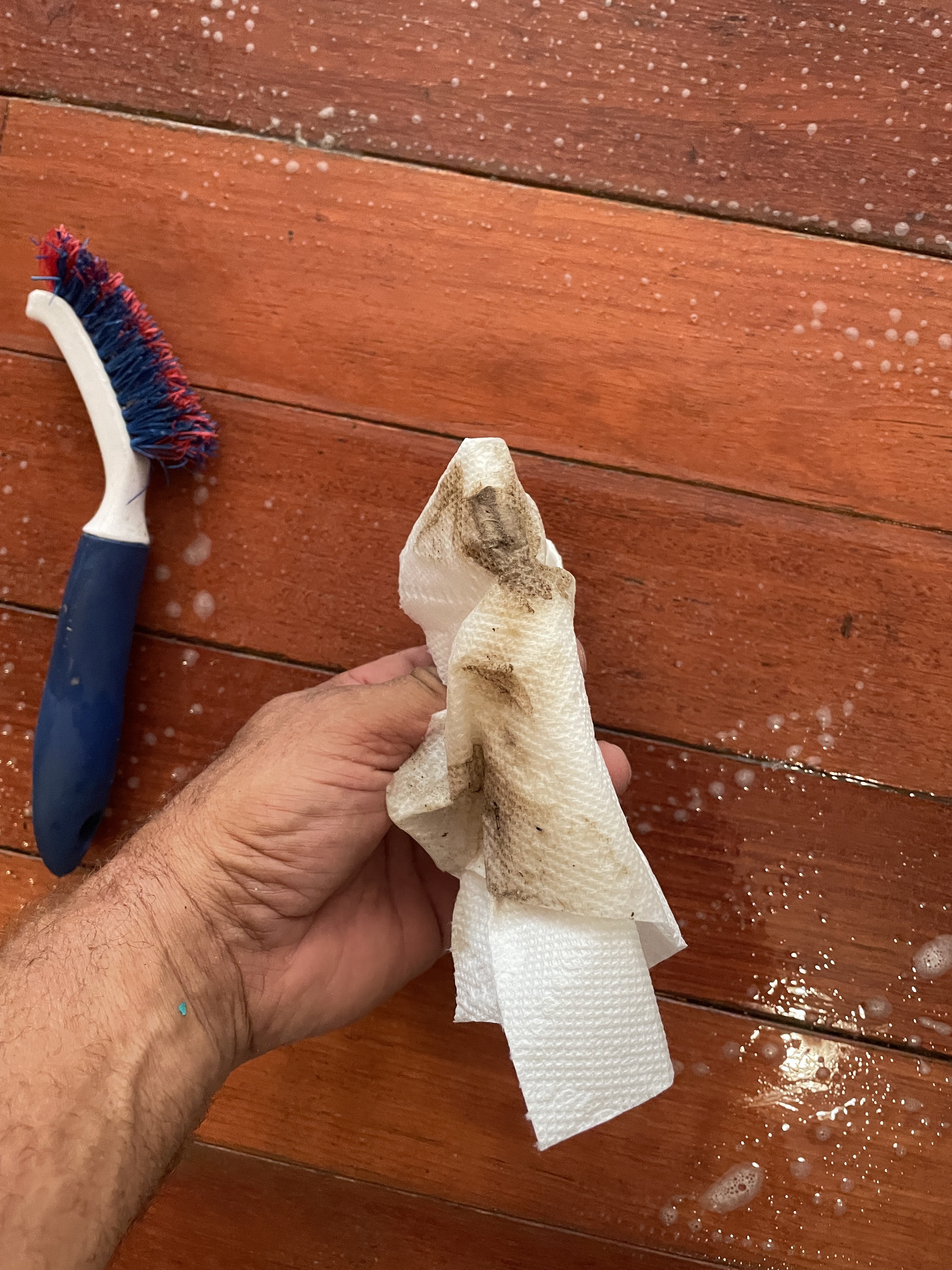

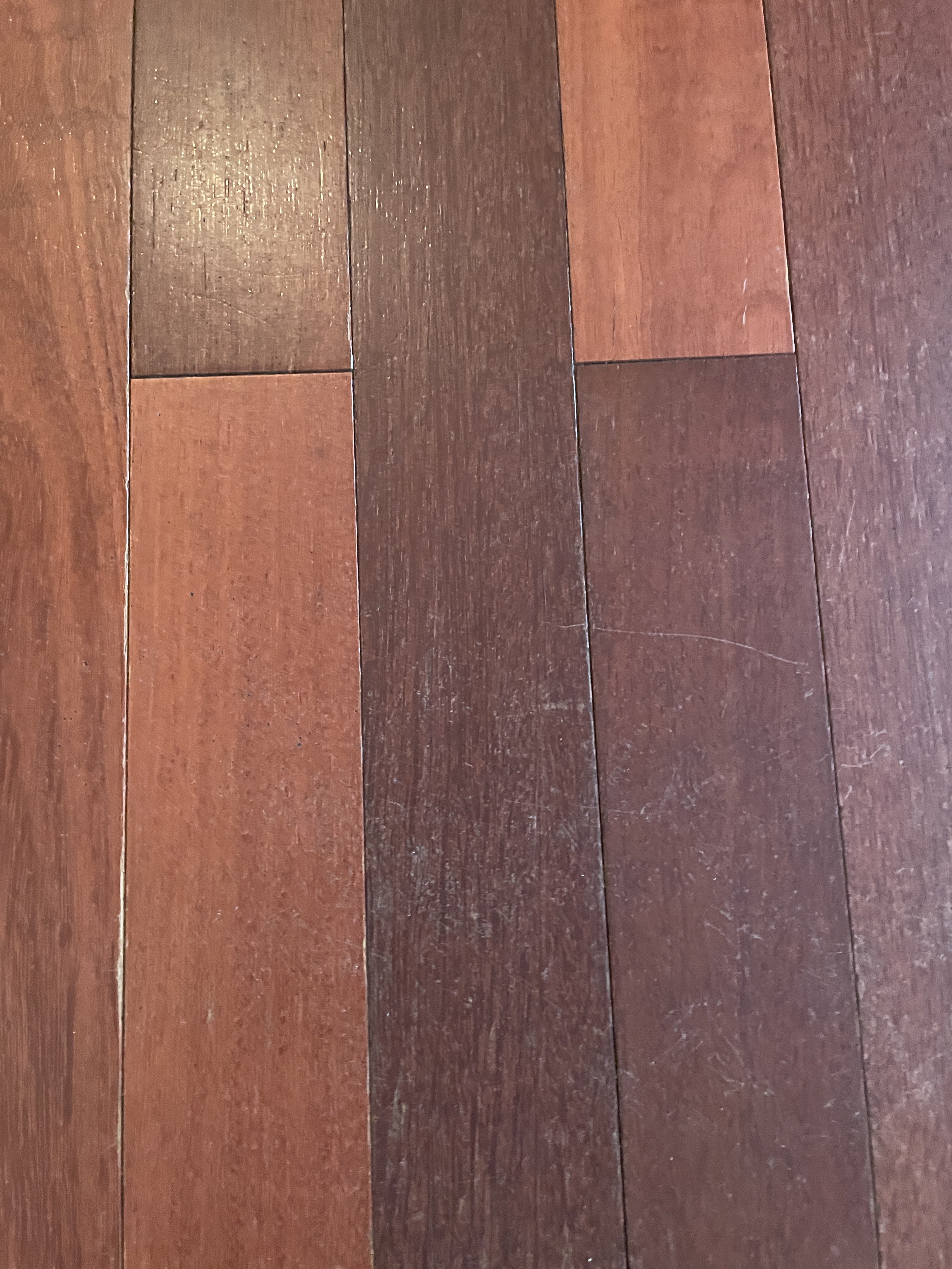

Came out good and clean. Very easy set up made it very easy job.
Before
After
So as long as I don't get a call that the floor is popping off the subfloor, It was a success.
Before I cleaned it, it was sticky when walking on it, now it is clean and can feel the difference more than see it.
