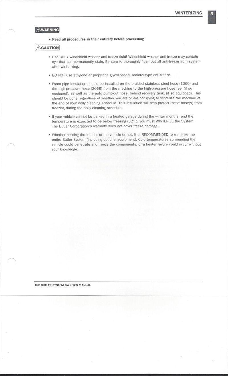

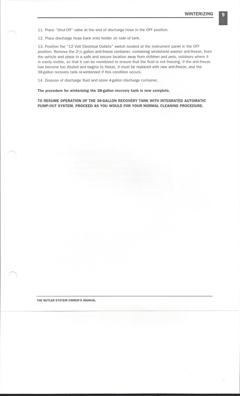

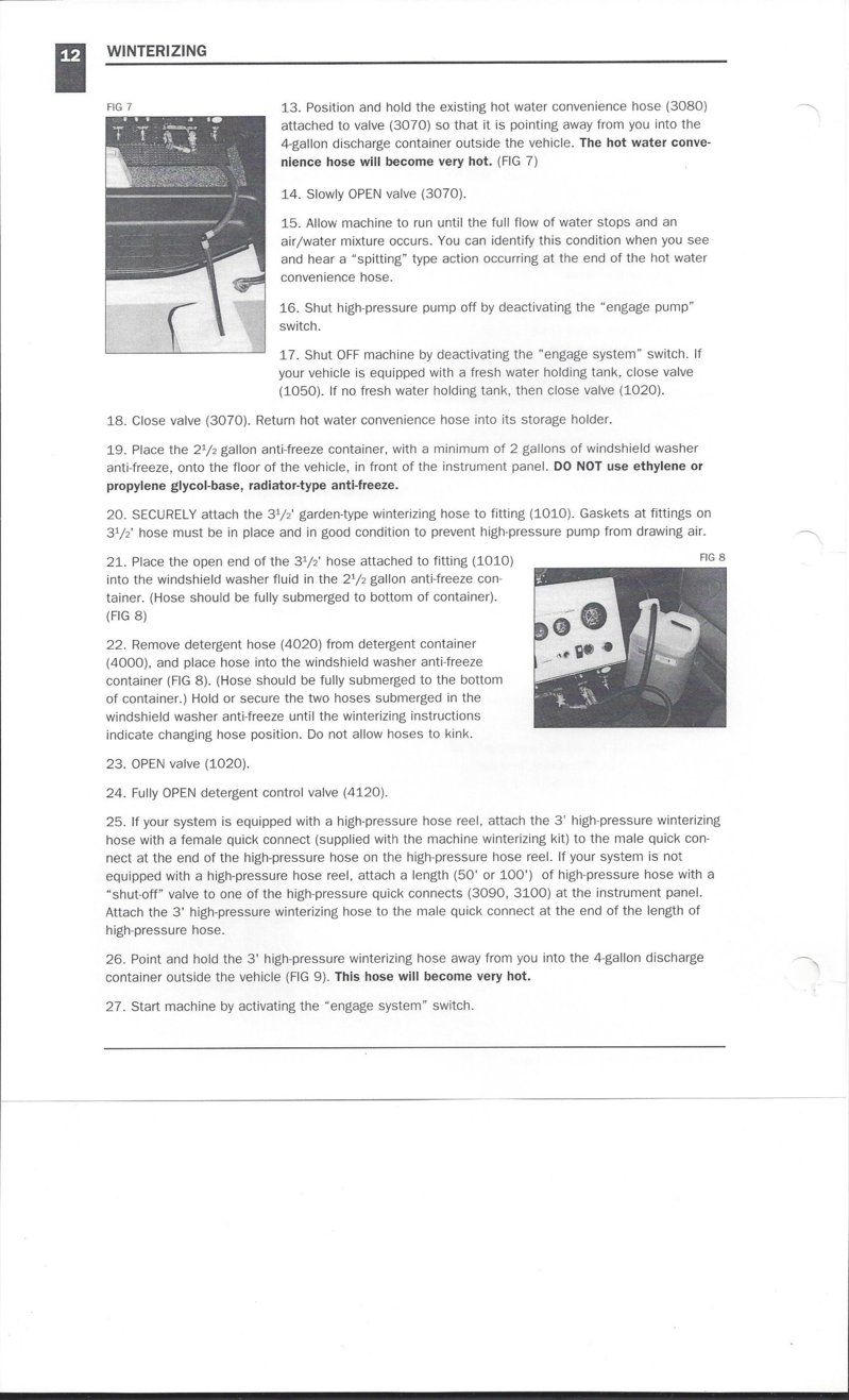

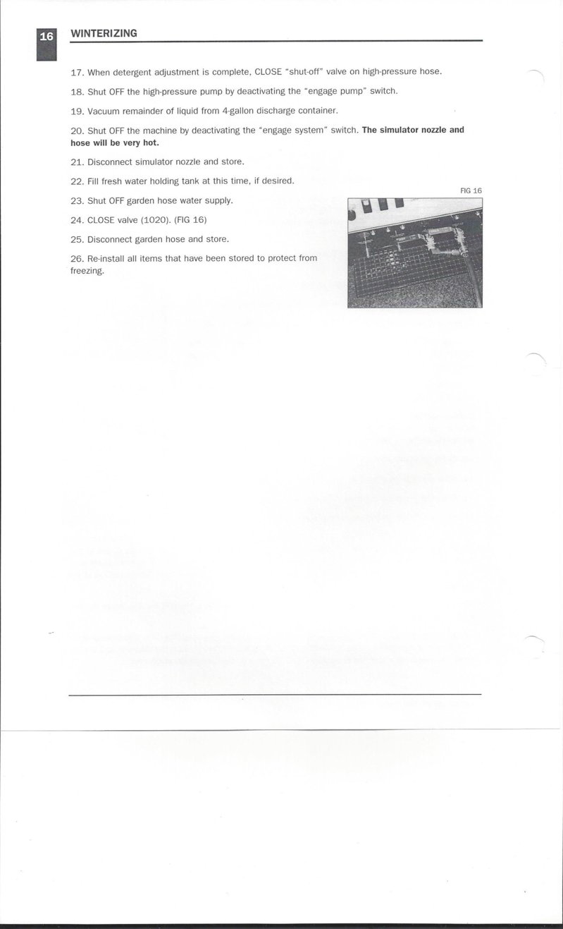

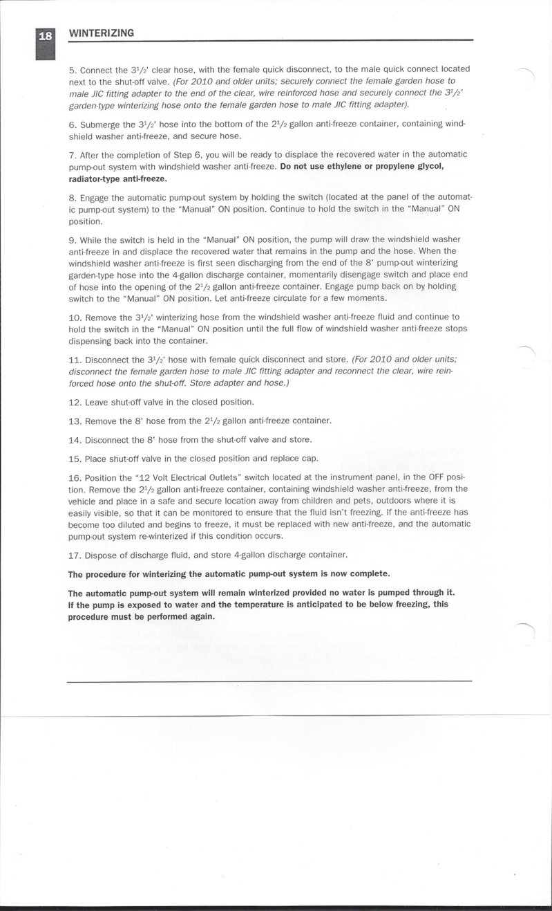

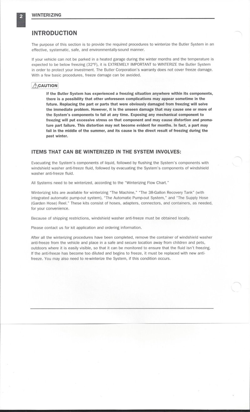

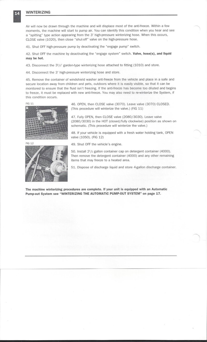

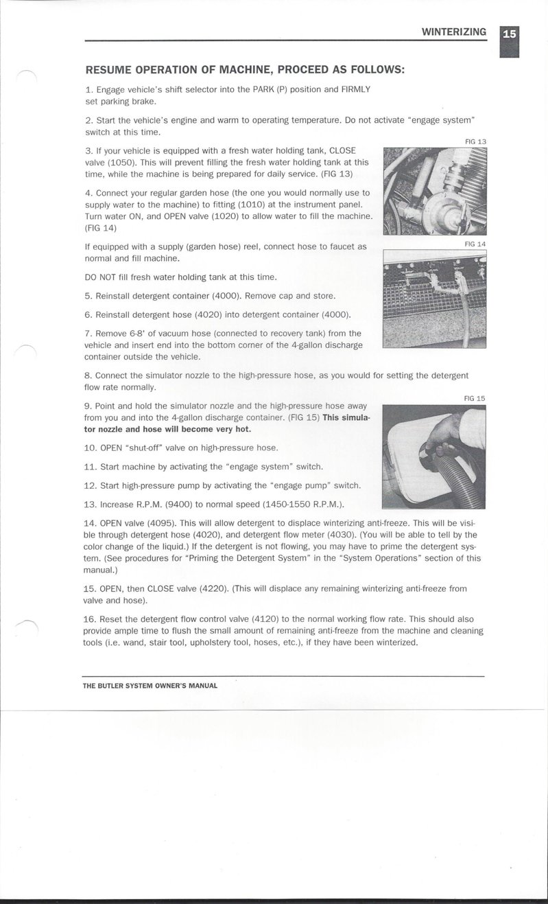

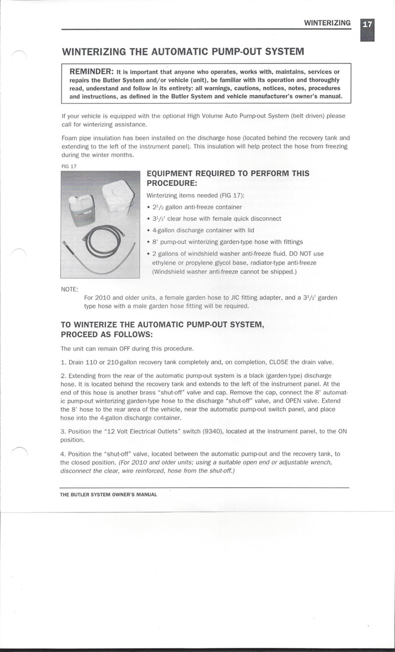

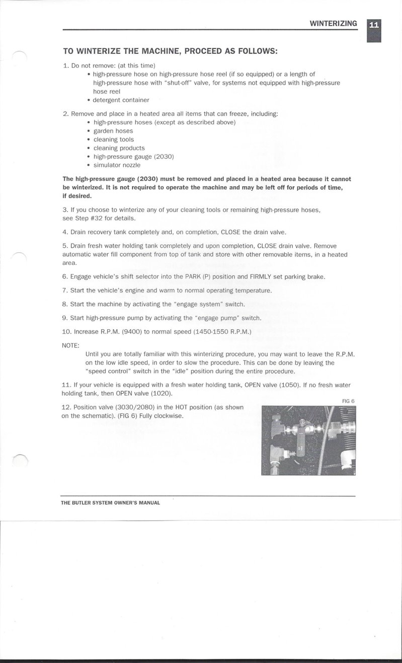

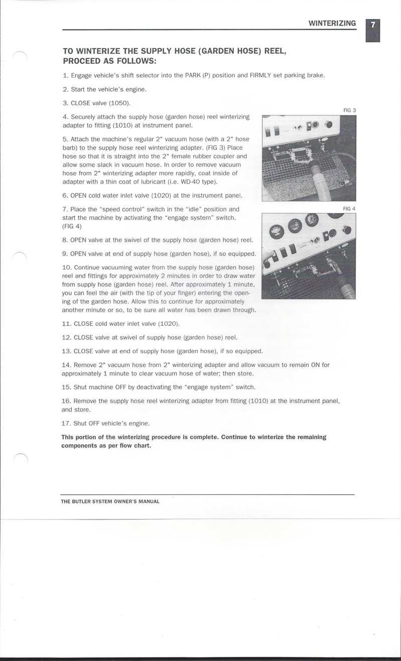

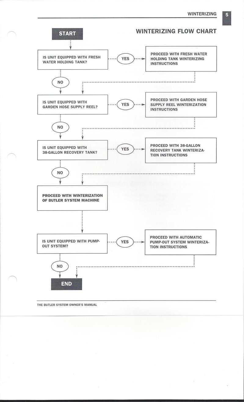

Sorry no video....
I could do a winterization video of how I winterize my Butlers....just takes a garage remote control
But, I have had a bunch of contacts, so this is the best I could do for now....just scanned the Butler Manual...
and I have a pdf file of it if someone wants to send me their email in a PM I can forward out to you.
