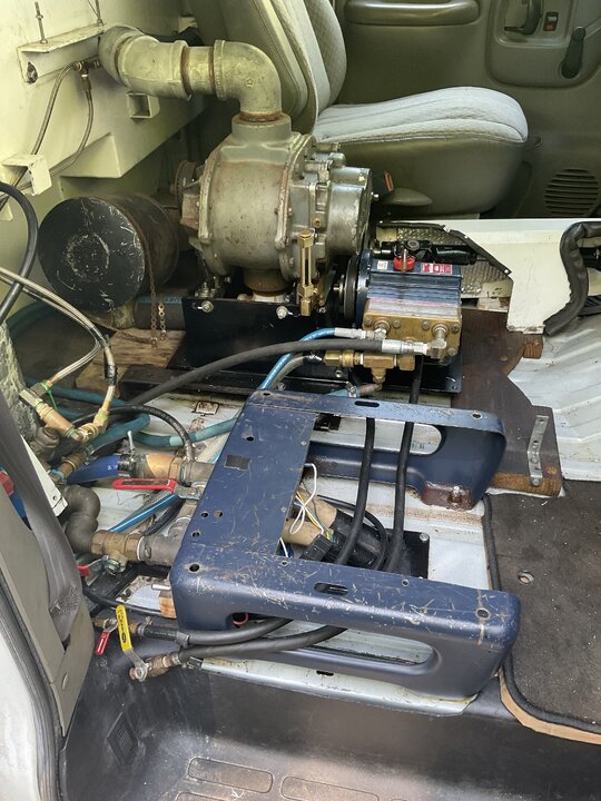

I like the AquaTech set-up. The HydraCell sits at floor level and feeds directly from the fresh water tank.
