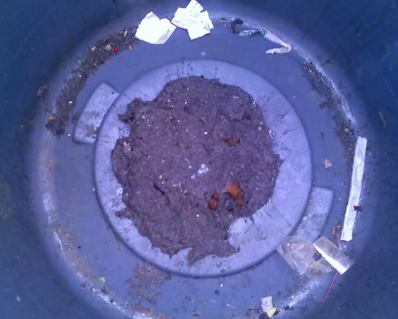

Who says Hole Glides cant suck up crud

You're supposed to clean carpet not the driveway.
How does that paper get in there? I think someone takes the hose off the wand and sucks up crap. ARe you sure the vacuum cleaner is working??

That's a 200 gal waste tank right?
Just think I get half that much with a 120 waste tank.
Question though, are you sure you are leaving carpet there after cleaning. Thats alot of junk.

You definitely are not a snobby high end cleaner but just a simple HACK like the rest of us?
So how many times did you have to punch the holes in your glide to get the crud out while you were using it?
