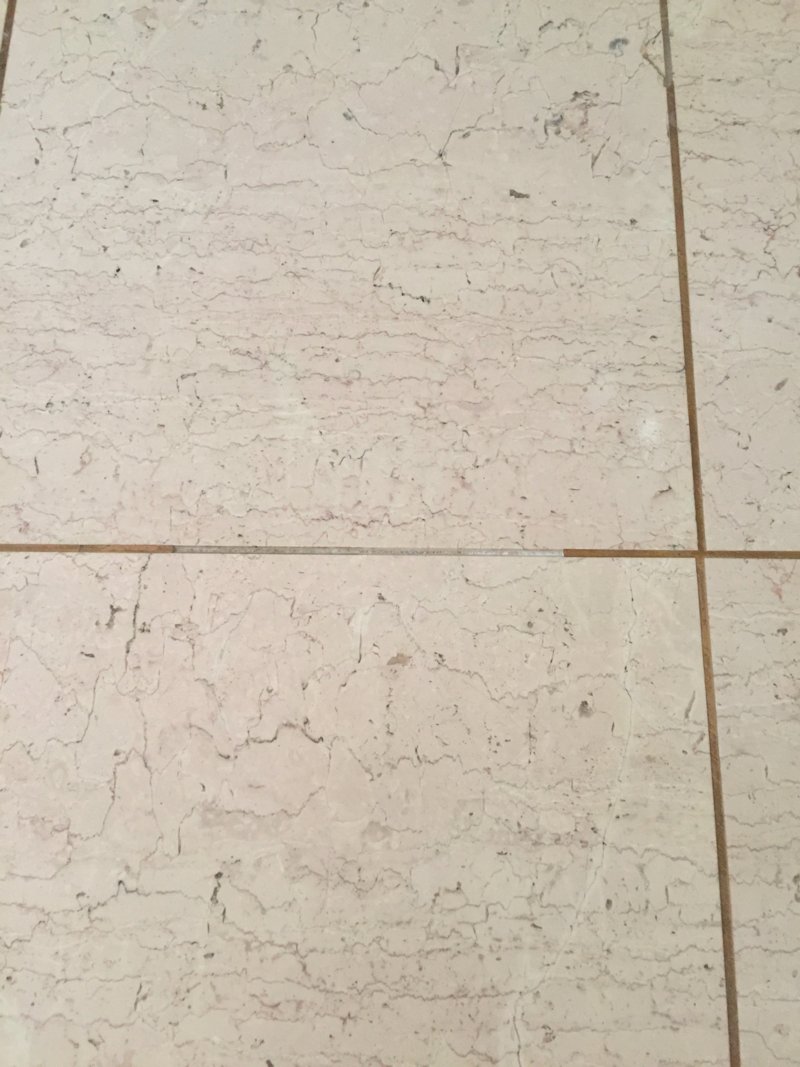

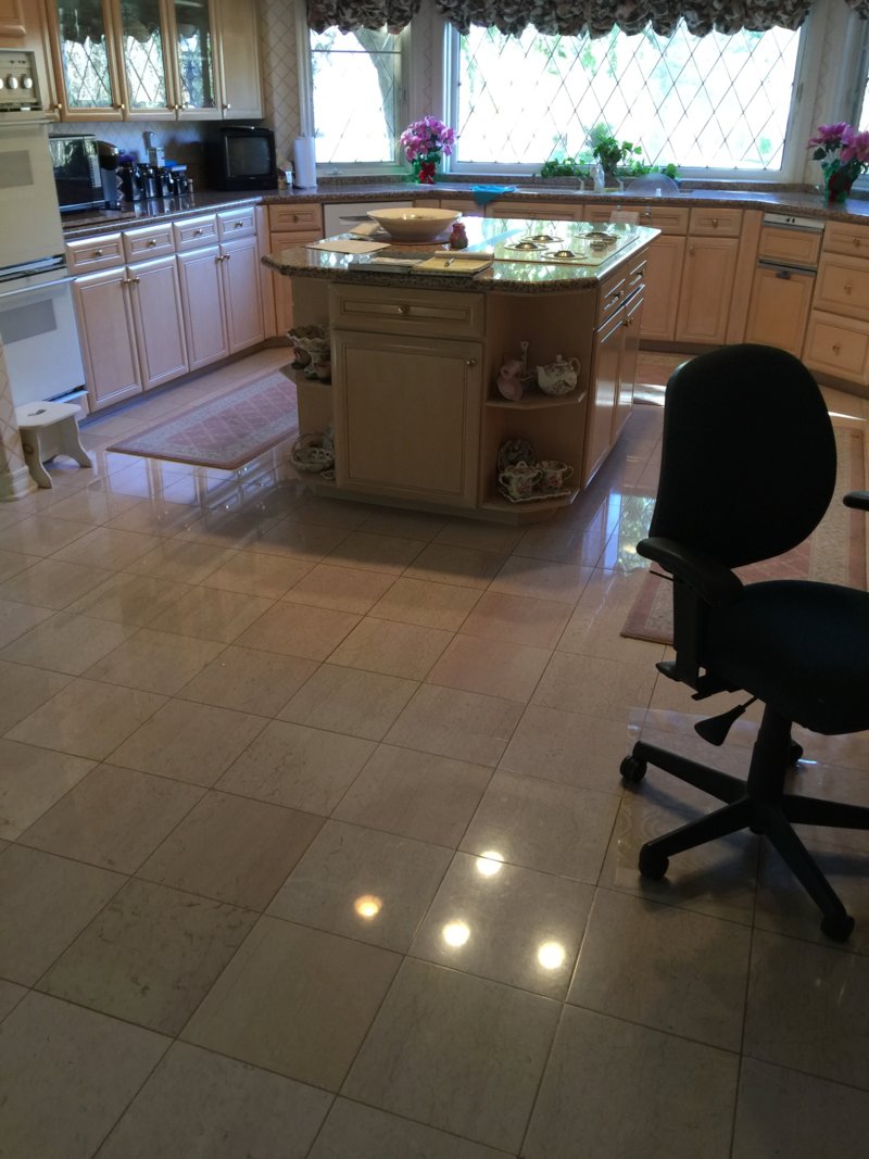

Was supposed to be easy 1000 sqft of re polish until I noticed the wax, good thing I haven't given an estimate yet..stripper recommendations?

They all do not work...
Must test
Worse case you can razor entire floor and remove and regrout
BTW...that is an improper install, that's why grout is failing..
Butt install micro bevel
Plan on remove and regrout if she is wanting perfect grout.. Easy..

If it's VCT finish/wax the ACE Hardware brand or Zep will take it off but after looking on a larger screen just now, yeah that lippage is going to ruin your day.

We could do that job in day. We do all the time. However, this what we do almost everyday.
I still question if there is still a topical...because topical a dont etch.
It's hard to tell from your pics..
The grout lines are not shinny...could be a bad angle
And if topical was applied, most of it probably would be worn off in hi traffic lanes. (Why it etched in traffic lanes?) depending on teaffic and care
Did you test it?
I guess he dosnt care about the grout?

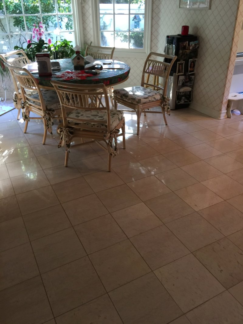

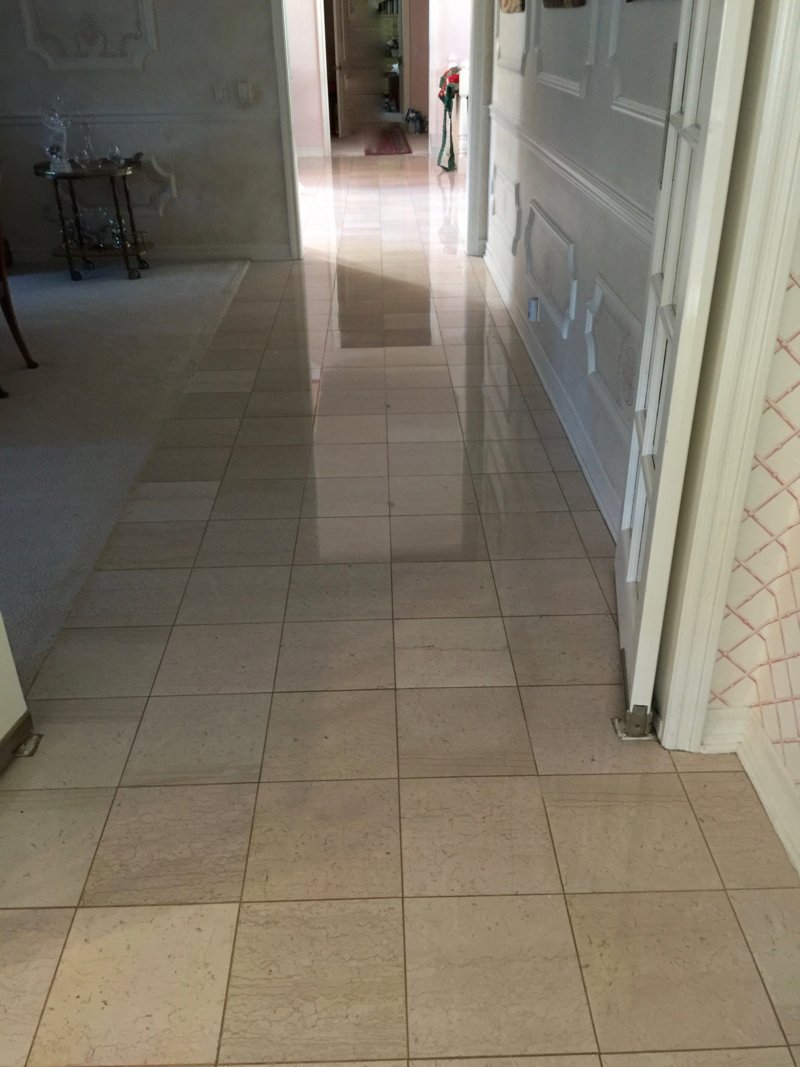

Floor is 25 years old so over the years spills in front of the fridge, sink & oven resulted in about 50 small etch spots, that they have now covered with rugs, there is one large etch spot in the middle of the room.
Wife said wax was applied about 5 years ago, I am guessing more like 8-10, I was able to scrape the wax out of the grout, kind of flakes off.
There wasn't a pantry or closet where I can test an area unfortunately
