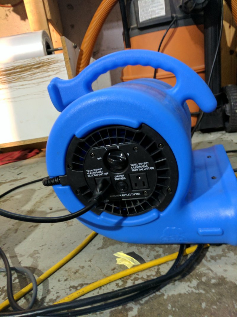

I have this little one that I got at the Vegas show. Half the size of a traditional dryer but very powerful for its size. 3 speeds and 2 additional outlets for daisy chaining. I am going to pick up 2 or 3 more. Won't blow the pictures off the wall. I think it's made by omni. They advertise here. Stackable on its side.

My little minis sure work well.
Thinking I need to jump in on the group buy for a couple more....
We have used them everyday since we got them. Really been impressed with setting them in a door way of a room after cleaning and doing some speed drying.
Very impressed, and again the smaller equipment getting used because easier to handle and take off the trucks....and these have great impact...so win - win
