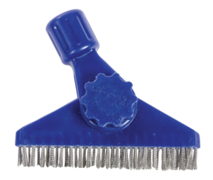

Thinking in these situations I might use one of these brushes with a 13 inch 175. Which should I get, the Medium, 160, or Heavy, 80?

Yes
With caution..
Had seen the banner, but was thinking too aggressive.
Read product description and will order. Thanks.
I read where you use Cobb's acid. Do you dilute?
Stainless Steel Grout Brush
Our most aggressive grout brush yet!
Every once in a while a tool comes along that makes your job so much easier you wonder how you ever lived without it. This is one of those tools. The stainless steel grout brush will easily clean up stains you either thought were permanent or had to use harsh cleaners to remove. Paint? No problem. It’ll cut right through it and won’t damage grout. Embedded oil and grease? After a few strokes the tile will look like new. The bristles are stiff enough to dig deep into the pores in grout and scrub out dirt, yet soft and pliant enough that they don’t damage or tear out grout.
The stainless steel brush won’t rust, so you don’t have to worry about leaving orange stains on grout, and is easily cleaned up.

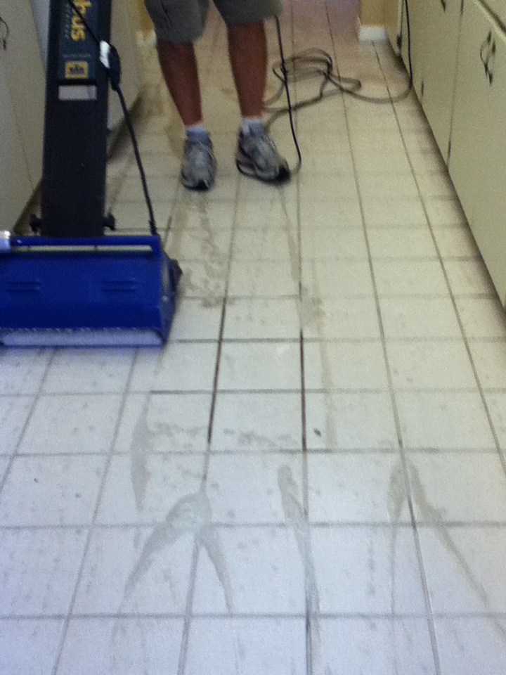

The best brush, aside from manual action or a CRB, is the one used with the Orbot. The brush is cut to actually get in the grout lines.
Great pic by the way. Are you following with a spinner or is this CRB only?
