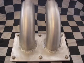

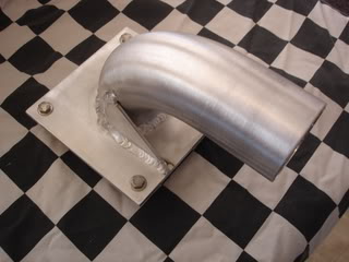

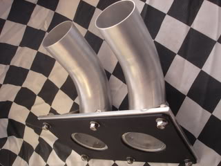

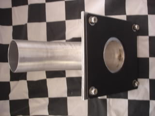

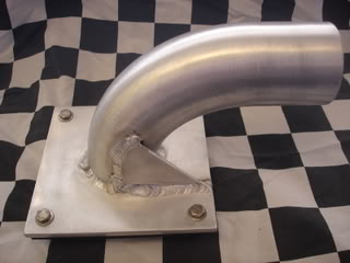

Keep in mind these are Brand New items, I've not even got them refined yet, these pics are of the first 2 or 3 I pulled from the shop bench, I rushed my welder to crank these out as guys were waiting patiently for a long time for the first ones.
We will be making more in larger runs later this month and refining them as we go.
As of right now, the dual ports are on a 6" x 9" plate, and the singles are on a 6"x6", but i will be going to a 5x5 on the next run so more guys can make use of them. I will also make a dual "straight" port version for side tank mounting it will not have the smooth 90º elbows.
These can receive raw 2.5" hose or a Vinyl hose cuff.
Here are the ready for sale pics, including rubber gasket and stainless hardware.
Somebody will ask, the suggested retail with gasket/bolts is $59 for the single, and $125 for the double, avail. soon from any GG distributor.

Most cost effective way to improve vacuum I can think of. I tried the 2 -2"to a y. No comparison to the 2.5" straight off the tank. Plus you can run your 2.5 " hose as long as you want then go to a 2" lead. Much more convenient than 2-2" hoses.
2.5" upgrade. Not just for V/AT's anymore.

I was able to schmooz a single port from Greenie for my Powermatic. I'll tell you this, with a 2" PVC elbow off the wastetank and 50 ' of 2.5 inch, my lift was reading about 8 or 9 inches. When I converted over to the Greenie's set up, my reading is now about 3 inches of lift. That tells me the resistricition point has been removed or reduced and I'm getting net lift now without any outside drag factors.

Greenie's port is bent on a ball mandrel to prevent kinking and wrinkling. Muffler shops don't do this, since it's not too big of a deal on a freakin Ford.
How about the custom 1/8" rubber gasket and stainless hardware? Gonna get that locally?

Mcmaster carr sells the gasket, that gusset looks pretty said with the goober welds.
