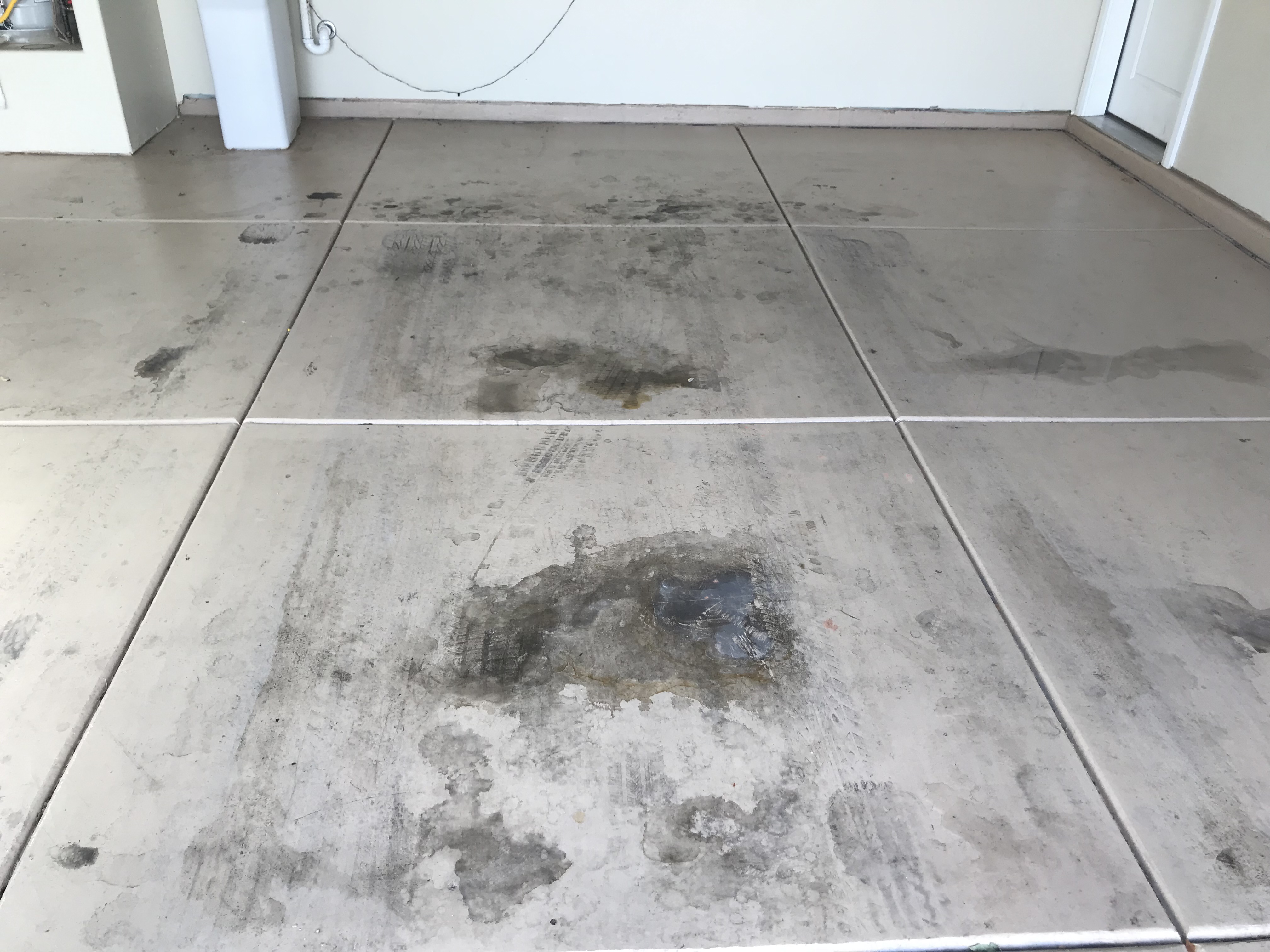

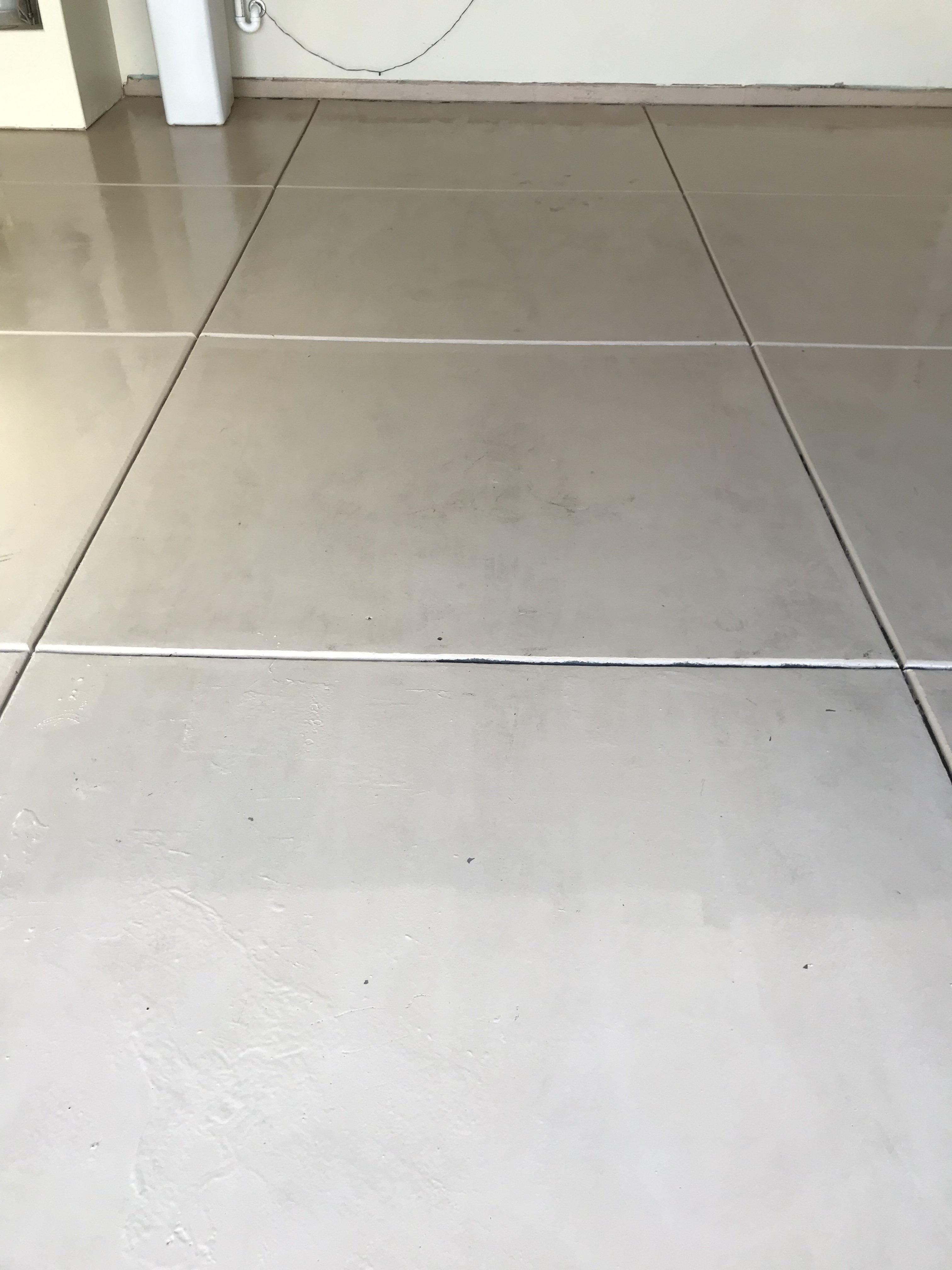

I add it every once in awhile on nasty polys. I boosted my prespray with citrus yesterday for this garage too.
FFD9C91B-594F-4F89-A608-4E779C5F1755.jpeg 98735935-35D4-477A-BADE-101B5E456FA3.jpeg
