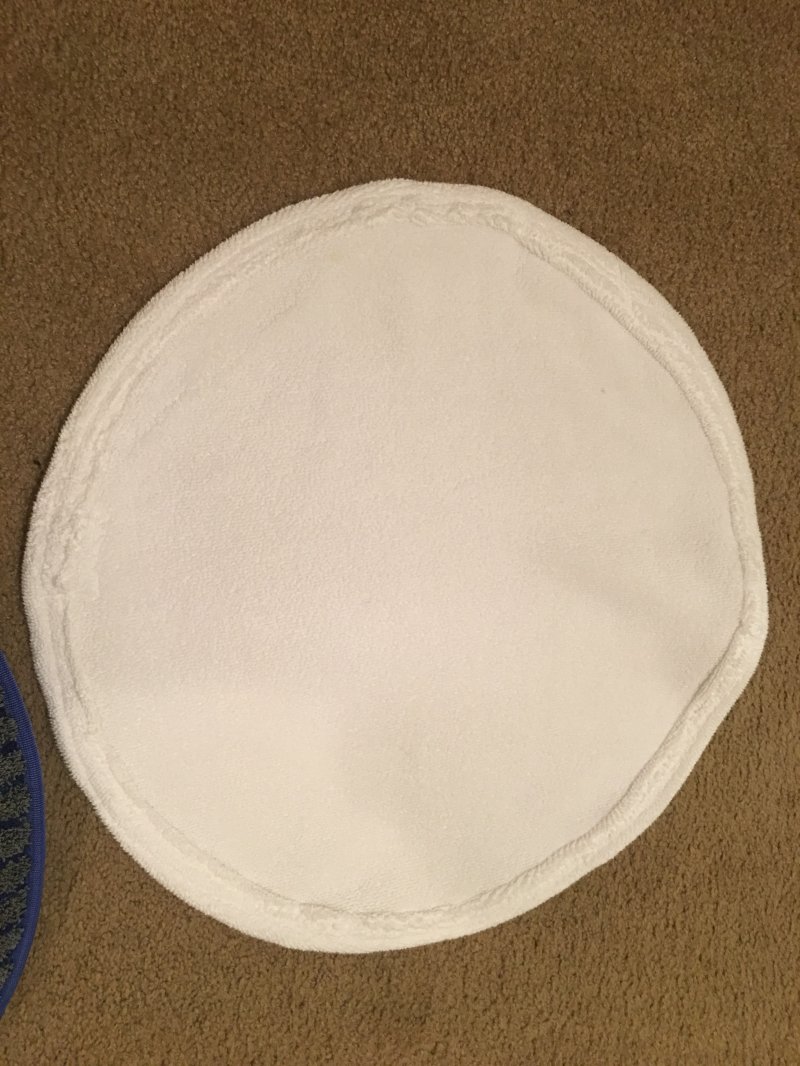

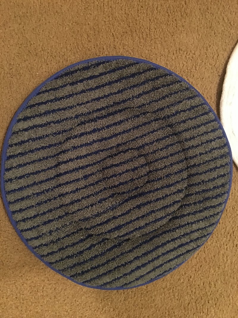

Damon the micofiber works excellent to agitate, loosen and suspend to be picked up with the combo pads. They are more absorbent and will then remove more in heavier soiled carpets.
Not that we won't use microfiber by themselves. We do, but in light soil situations.
1. Vacuum throughly
2. Precondition and agitate
3. Rinse cycle with wet/pads slightly wringed out
4. Finish when need with cotton blend or cotton pads.
Never dry pads, always wet for rinsing and lubrication

I just used my Vibe tonight.. I enjoyed using it on moderately soiled carpets in a Retirement home Lobby... We still ran the TM for the Heavily soiled areas then post padded the areas after.. Worked like a charm..
I may have to source a more aggressive fiber pad than the one it came with.. I'm used to EncapStore brown pads for my Cimex..

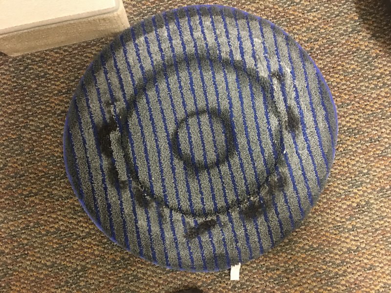

24,051
You must not have kept it wet or flipped it. Try flipping it every 300 feet, then switch to a new pad.
No I didn't flip it. I did wet it then post bonneted with the superzorbs. The carpet came out beautiful. Wish I could say the same for my microbeast pad.
