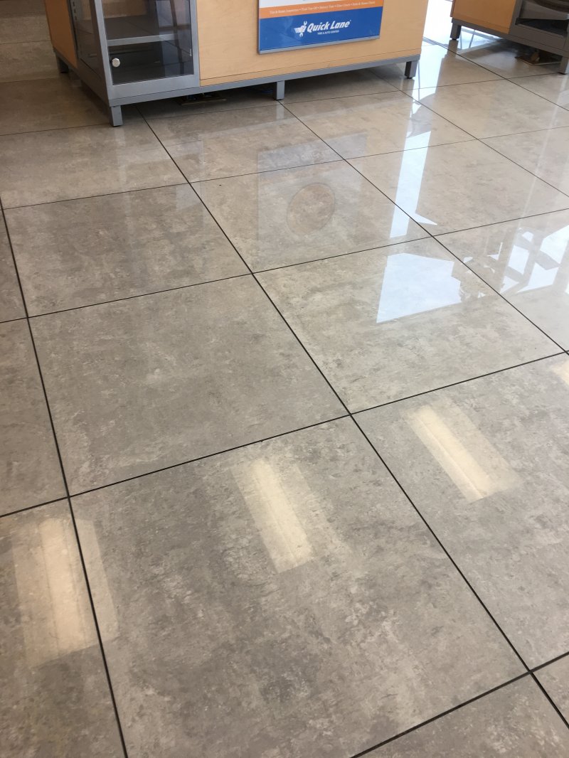

May 31, 2017 #1 BIG WOOD The Timminator Joined Feb 4, 2016 Messages 14,168 Location Georgia Name Matt w. And if they want it cleaned periodically, how should I clean it? Just Hwe? If they want some polishing, all I have is a 175. Would those 3stage polishing pads be something to consider? Attachments IMG_0561.JPG 142.1 KB · Views: 522
May 31, 2017 #2 clean image Member Joined Oct 5, 2012 Messages 970 Location Orlando Name Carl Maddock It is Not stone. Polished porcelain Clean Reactions: BCC, J Scott W and BIG WOOD
Jun 1, 2017 #3 Mikey P Administrator Joined Oct 6, 2006 Messages 116,123 Location The High Chapperal thats what I thought... Reactions: BIG WOOD
Jun 1, 2017 #4 SuperDave212 Member Joined Mar 27, 2015 Messages 72 Location fort lauderdale, fl Name David I agree....you can also use a glass polishing powder to spruce it up Reactions: Old Coastie and BIG WOOD
Jun 2, 2017 #5 Old Coastie Supportive Member Joined Jun 29, 2015 Messages 7,504 Location Heart of Dixie Name Stephen SuperDave212 said: I agree....you can also use a glass polishing powder to spruce it up Click to expand... Cerium oxide for ceramic? It works?
Jun 8, 2017 #6 SuperDave212 Member Joined Mar 27, 2015 Messages 72 Location fort lauderdale, fl Name David no the glass tiles...
