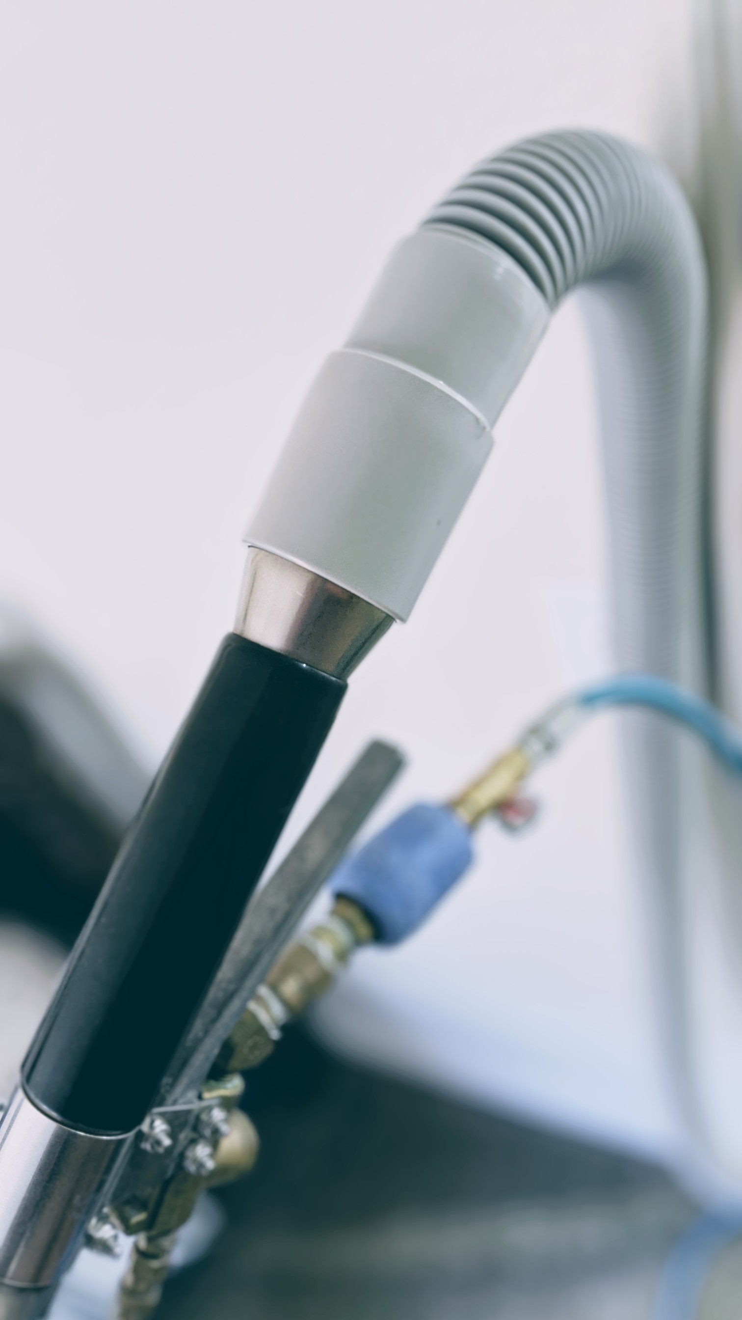

In regards to clearing the head, I use a modified vac hose cuff at the wand coming straight with 2" vac hose connecting to the wand that keeps lockdown from ever occurring. This amounts to smooth, uninterupted airflow being allowed to move through the vac hose, which translates to better water recovery, regardless of which TM or portable you are using.
