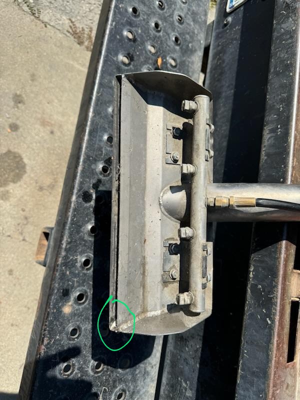

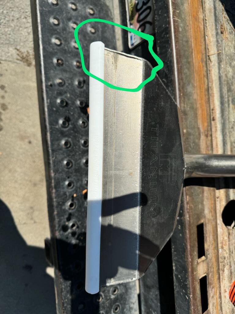

This guy is telling me the internal fit Glide won't fit all the way in, I see a collapsed faceplate and a damaged or cracked weld that's keeping it from doing going all the way in. IMG_20240612_080904~2.jpgIMG_20240612_081252~2.jpg.
I've sold hundreds of these Glides without any issue.
14,144
Just have him trim the internal fitting on that end that won't snap in.
Also, tell him I said he needs to ditch that wand. P.O.S.
-Matt

I always thought the mach wands were awesome, until I used my prochem ti. That cracked weld tells me that pmf quality has went down the drain after seeing that combined with my experience wasting my money on their tile wand, stair tool, and upholstery tool that leaks air terribly

Unfortunately all hand welded wands these days are extremely variable especially after covid.
Fortunately Westpac treats the 530 as a premium product and everything about it is just a little bit better than the average..

What I see is that you are now experiencing the issues that come from selling a new product that has to fit/adapt to a used product that has issues beyond your control.
This is why builders would always rather build a new home than remodel and existing one.
....and why working on old, abused truck mounts in my service shop is nearly always a nightmare.
