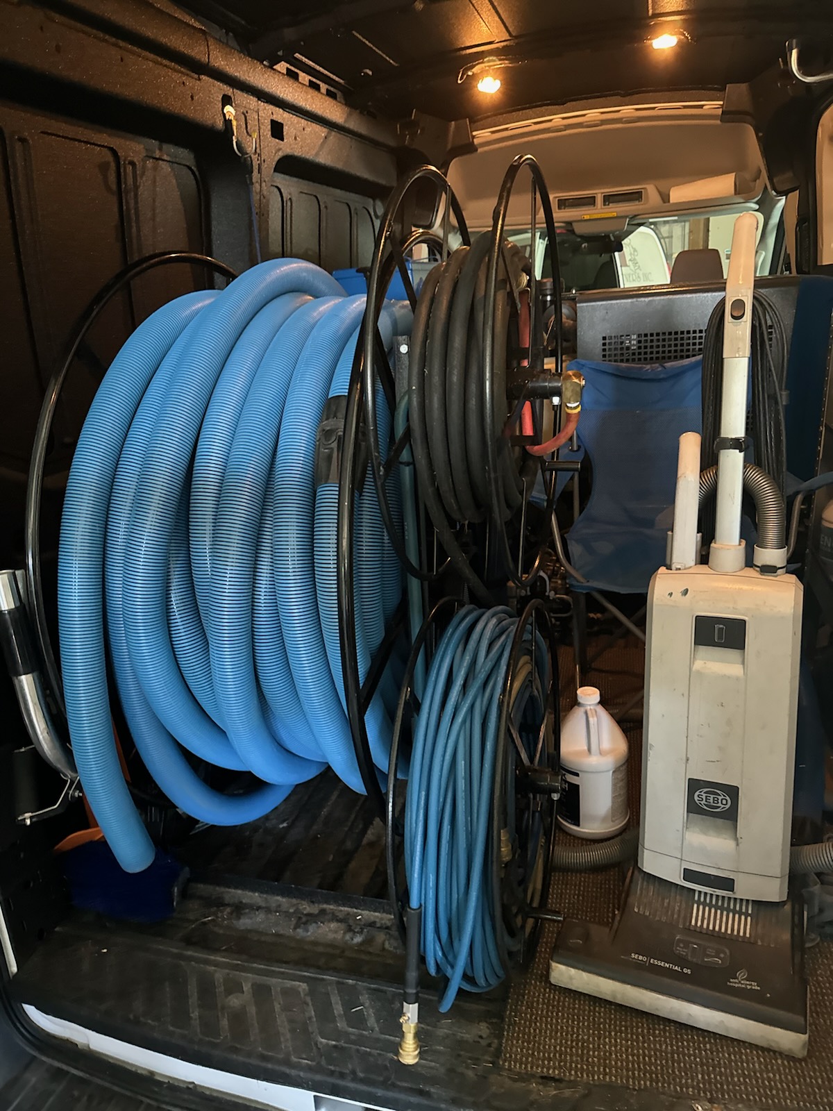

For that setup above, I would look for a tank that can be installed under the hose reels. A bunch of wasted space is in that area
