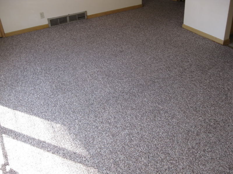

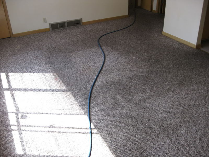

Here are pics (taken with my phone)of just one apartment (Just the living room) only 2 where not this bad
Yikes those where huge fixing the pics then re-uploading them

Powerstrike mixes easy. WAY EASY. I still love extreme clean it is my best selling powder but after this week I have to say powerstrike whooped it and thats saying alot.
George if these had been residential or at least good paying apartments I would have pre-vac'ed and scrubbed but these where student housing apartments that where bid cheap. We were helping out a customer who had to have them done and done now. He has 300+ apartments in 3 different locations that he have a 2 week turn around window. They don't want nor will pay for much more then a spray and suck. They will be expecting a bit more from him now that we performed magic on the ones we did :mrgreen: Actually he does a really good Job he runs a Steam Way 4100 and uses extreme clean and energy and runs prochem's heat wave as his emulsifier. We ran A+ Because I had a bucket that was sent on mistake and ended up with it at no charge. He has used both and really likes the heat wave. Next semester when he needs help again i'll give the heat wave a good go myself.
