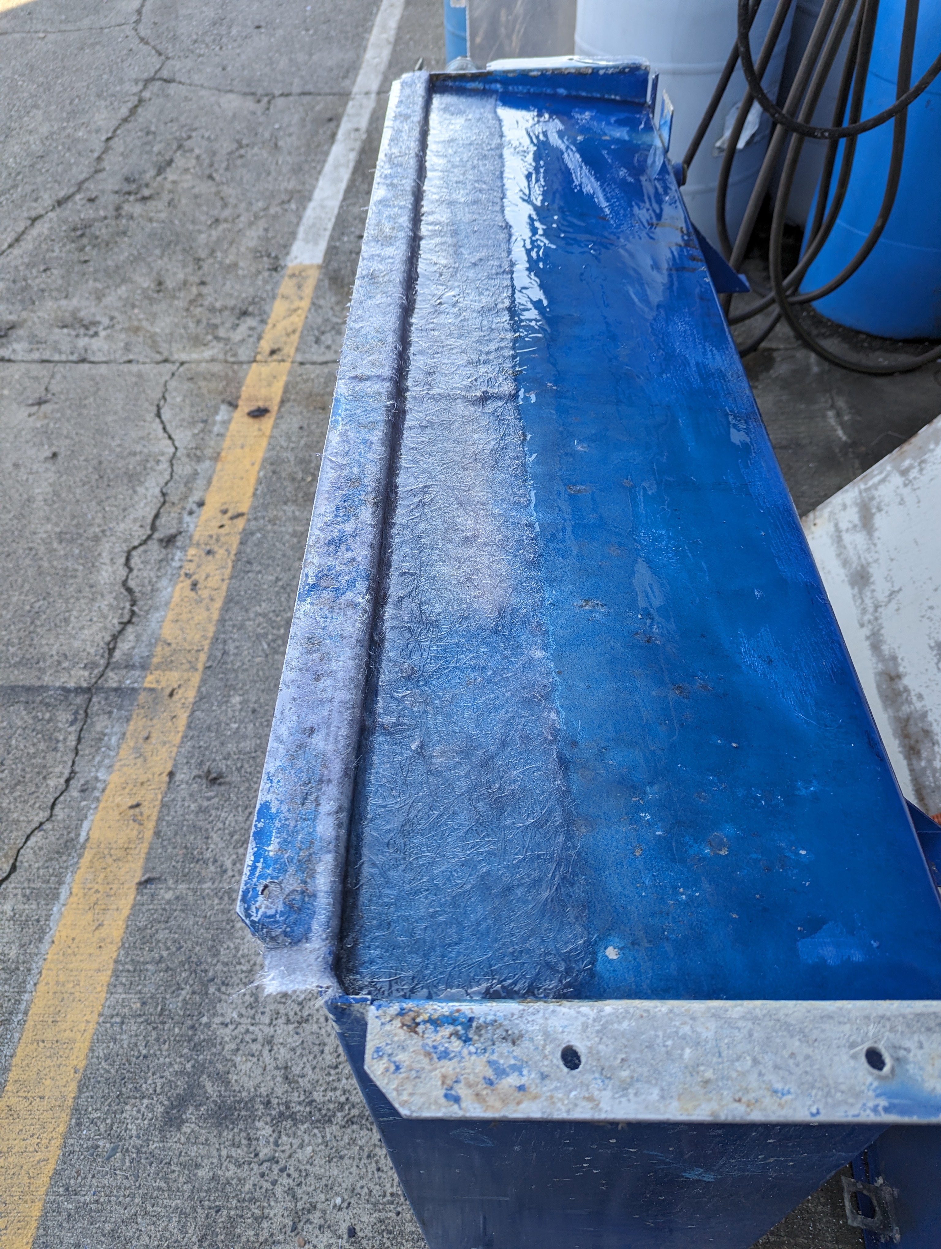

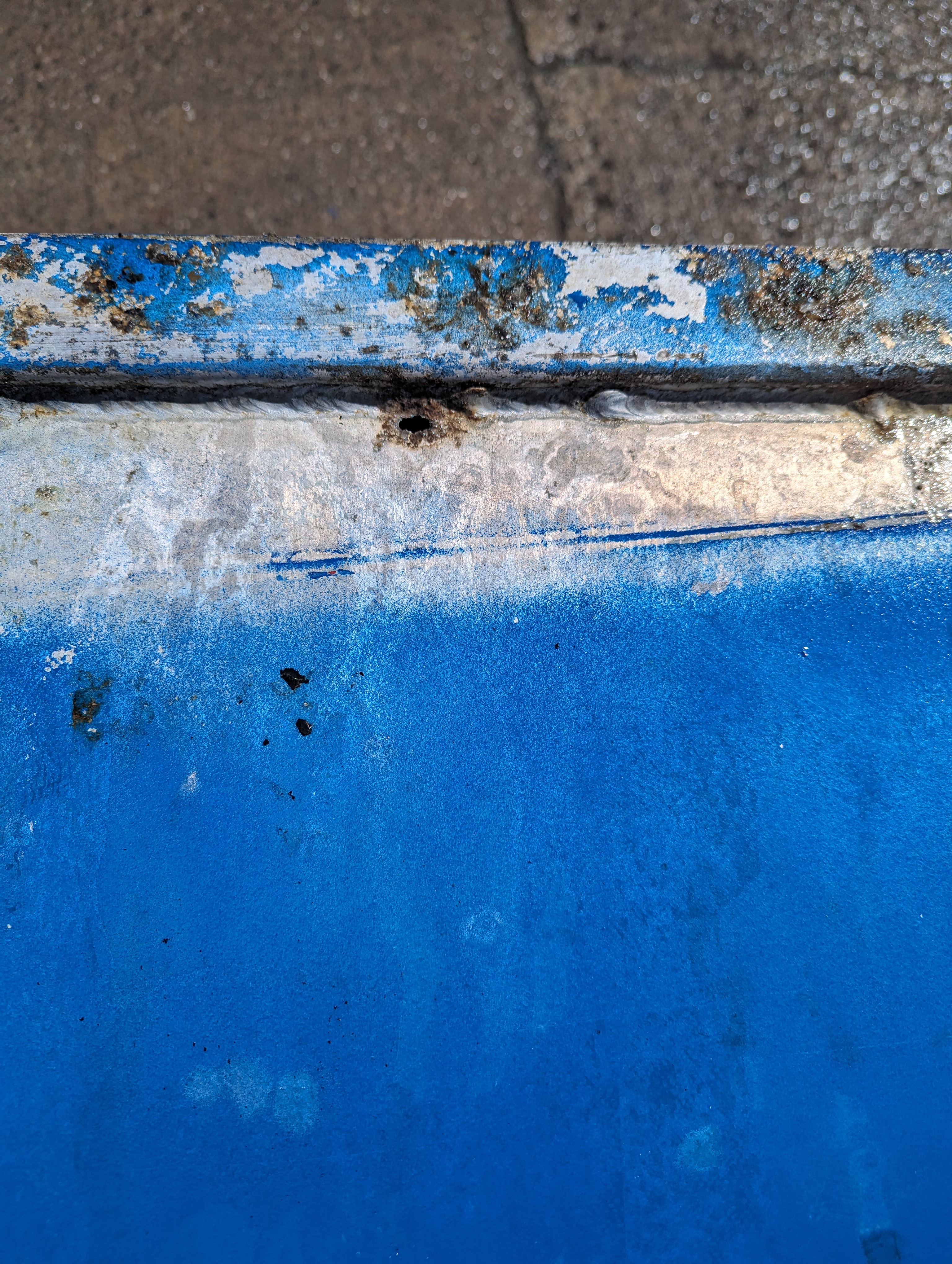

Tearing apart my back up van today. Hydramaster cds 4.2. have a small leak in the waste tank but what a nightmare to remove it. Control panel, heater exchangers and water box all attached to the waste tank. Have to disconnect and reconnect it all. Have to say, the tank lasted 24 years before having a leak. Can only find one so far, leak testing it now. Will patch it and it should be good for another 24 years. At the same time, I can service the pump, blower and shaft.

Can’t tell from the pictures, is the leak on the floor?
Yes, tank is upside down. The leak is where they welded the flange that bolts to the floor. There are a couple of places where it looks weak. Thinking to fibreglass the bottom. My Cleanco was much easier to remove. Much better design.

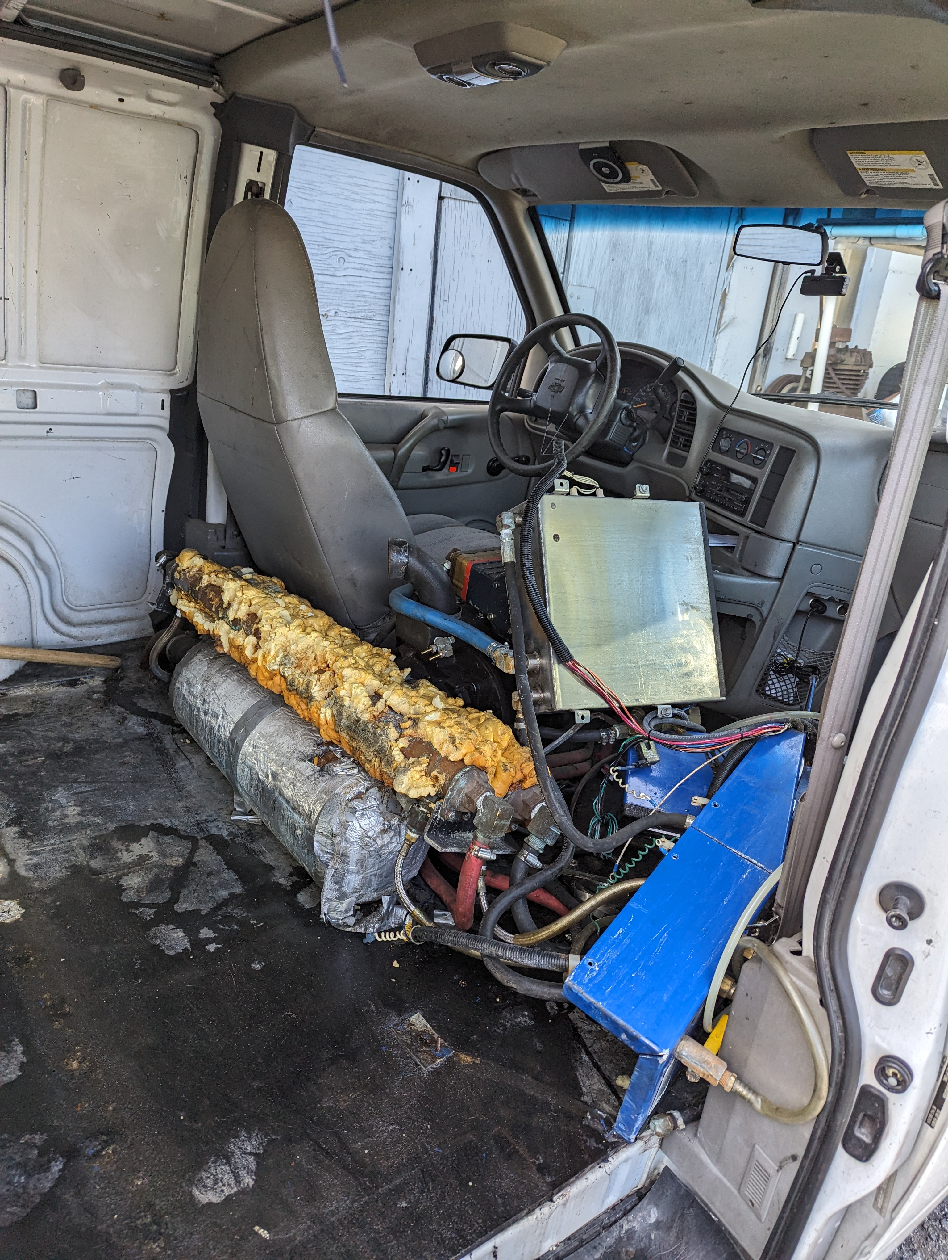

Yeah, is was a flex seal product. This hole is too big for that, it would just leak out. Once I fix it, I would be tempted to try Jimmy's solution to prevent further leaks. Here is a pic of the unit dismantled.

did you put that spray foam mess all over that coolant heat exchanger?

Maybe next time drill it out, then thread a bolt with the threads coated thick with JB Weld into the hole? Apply a little more all around the head, then paint?

It's more than just one hole. The area adjacent to the weld is weak. I put a layer of fibreglass cloth down in a bed of resin and spread more resin on top. I think I'll do a second layer today just to be on the safe side.

@Cleanworks that’ll work for sure. I kinda wondered about the bond between the fiberglass patch and the metal over time. It’ll probably last a lifetime though, I’m sometimes prone to overkill.

Just put everything back together today. The firbeglass cured beautifully overnight. Looks nice and strong. Should last until the life of this van which is maybe another 4-5 years. Hey, no leftover parts.
