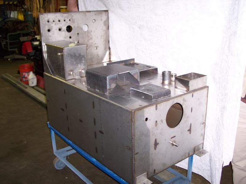

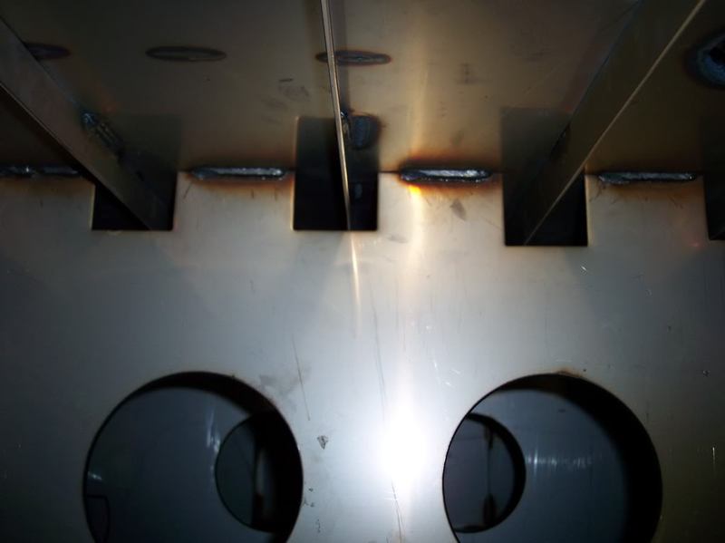

At Judson we do not restrict our vacuums in any way. I guess you could consider our baffling system in our recovery tanks a filter because it does not allow anything large enough to cause any blower damage to get to the blower.
This is a photograph of the inside of a TNT and this is the way it has been made since 1972. There are still hundreds and hundreds of the 1972 TNT’s running to this day and we’ve never had a blower failure due to contamination. The only blower problems we’ve ever had is from people not greasing them or changing the oil on a regular schedule.
By running the blower unrestricted, we allow the blower to produce the CFM it was designed to produce. A lot of truckmount manufacturers will give you blower airflow performance numbers of the blower specs, not the actual CFM being produced where you, the operator connect the vacuum hose. Running a blower unrestricted also allows it to run cooler and this contributes to the long life our units have. I would recommend an inline filter on your vacuum hose just to make cleaning the recovery tank out not such a hassle.
I agree with Mike on not removing the filter in your recovery tank because your tank may not be baffled enough to prevent something from entering the blower.

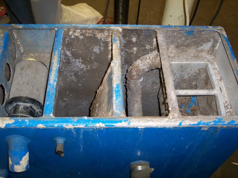

This is a photograph of a typical waste tank with a filter system. Notice the extreme restriction of airflow with this design.
Hey, I told you not to post a pic of my waste tank...... :evil:
:lol:

The inside of my steam action waste tank looks almost just like that judson baffeling.
