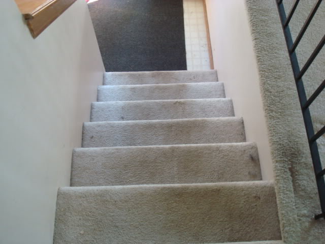

A rental job.
Scott Rogers
1,033
Chris, Stairs look good.
If you take a bottle with 40% (your fav encap) and 60% water a quick spray and brush on the edges will clean those filtration lines right up.
Scott Rogers
1,033
Hey Mikey, there is some pretty substantial fiber damage there. I was thinking it was probably that and lighting giving it that look.
Pictures can be pretty deceiving compared to the actual finished job.

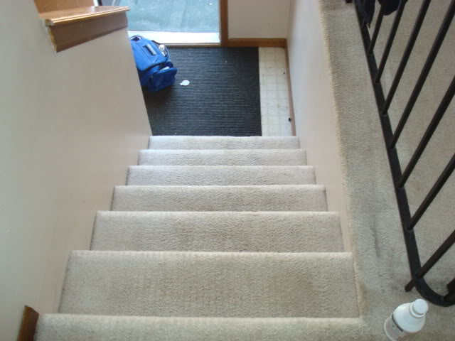

breathe72
Oct 18, 2007
355
Greenie said:
Is that vinyl on top of that carpet at the bottom of the stairs?
Its one of those cheap runners Greenie.
I pre-vacced AND pre-scrubbed these, lol.
This place was so disgusting, I had to.
If you think the stairs cleaned up like shit, then you would have really groaned when you saw the rest of the house.
Its a rental that belongs to a lady who teaches with my wife.
