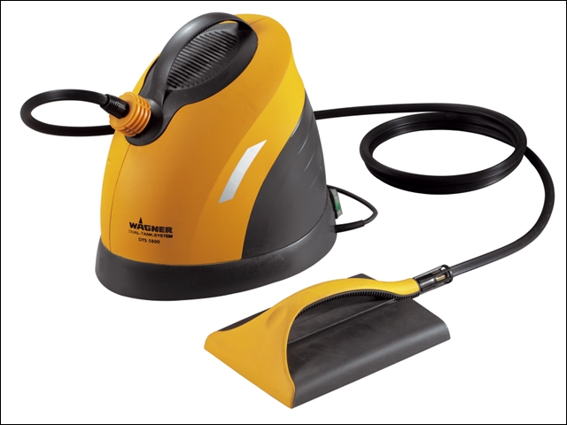

Does anyone use the Wagner wall paper steamer for removing carpet stains ??
If so, how were the results please ??
