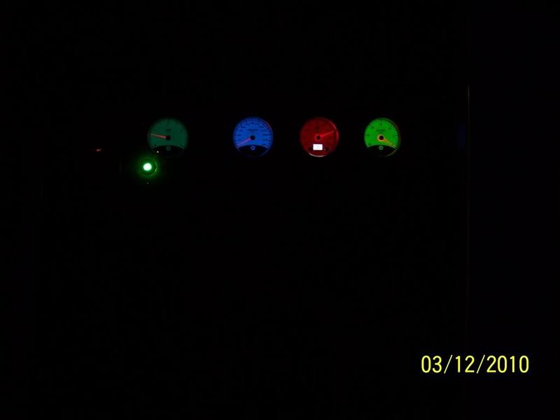

Bill, I have had no problems with the gauges, they have acted up a couple times, but it ended up being a poor ground on the machine. I like the color coding, it makes training much easier and looks really cool at night. :wink:
