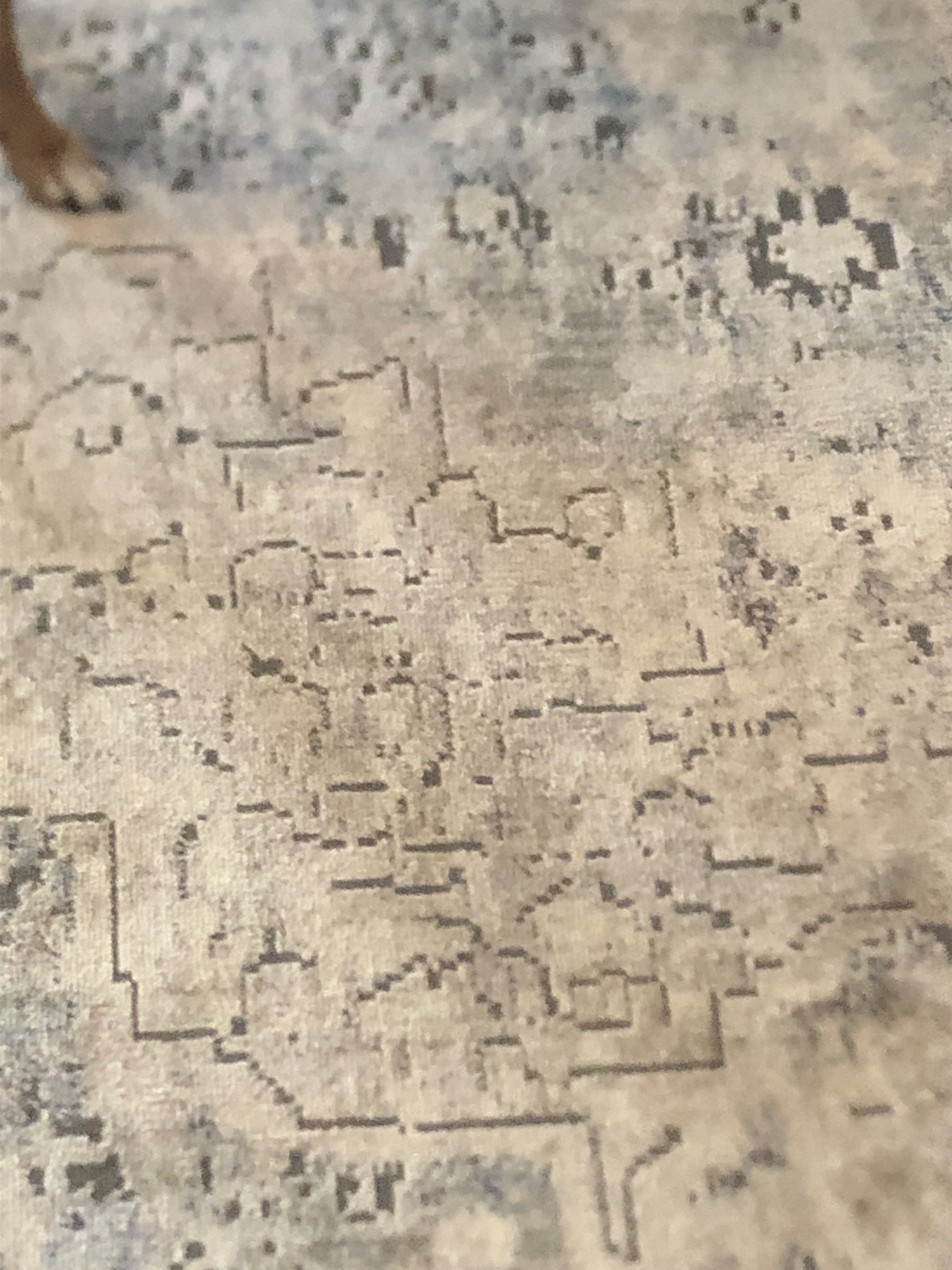

We've cleaned some that turned out great, but always do an extensive pre-qualification with the customer. Never clean one on-site.
Hard to tell from a pic, but that one looks like a print. I wouldn't clean a printed one.
