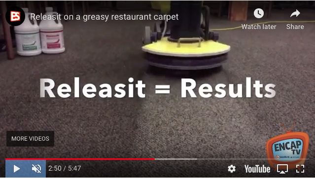

Video: Releasit on a greasy restaurant

Now he should use HWE to rinse out the grease, encap punch, and encap clean for a healthier clean.

That’s an option. Not a very practical one. But it’s an option. HWE it’s not always the ultimate solution in a situation like this.
15,250
Ne
Looks good for now
But all of that greasy residue is still.........there
And will look like crap sooner than you think
And where was the vacuum step?
Wasn't all that greasy to begin with anyway

We used to service a chain of Sweet Tomatoes restaurants. At first we performed HWE. Occasionally there would be a complaint but overall they were satisfied. Then we switched over to straight encap. Initially, I figured we may still need to do some HWE every once in a while. But in fact, we were able to continue to provide excellent results without needing any HWE. Monthly encap alone kept this restaurant chain happier than when we were cleaning with HWE. No more wicking. A good encap program was capable of keeping the carpet looking great!

The transition is pretty visible here...
116,245
The temporary foam makes it look brighter than it really is Rick, the preceding pass has already darkened...
Here is a much better example of greasy being broke lose with a shampoo...
