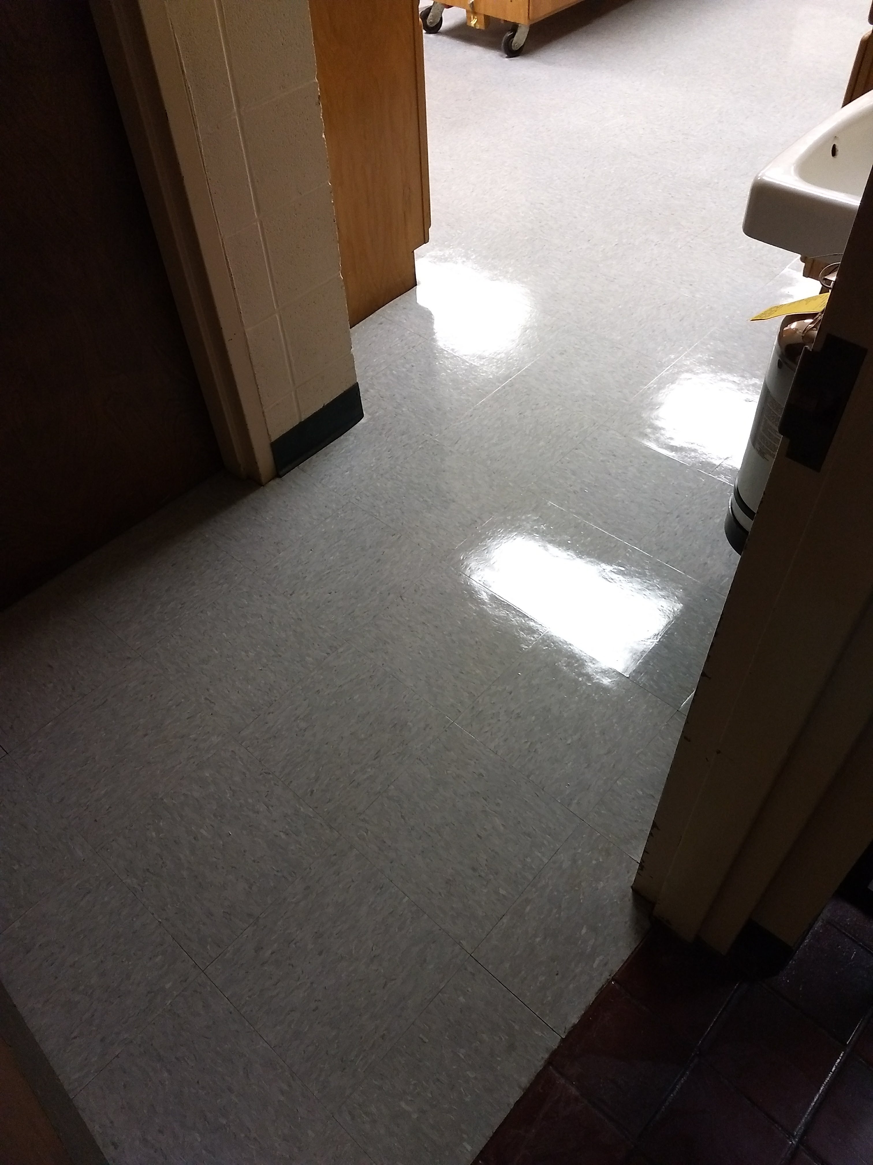

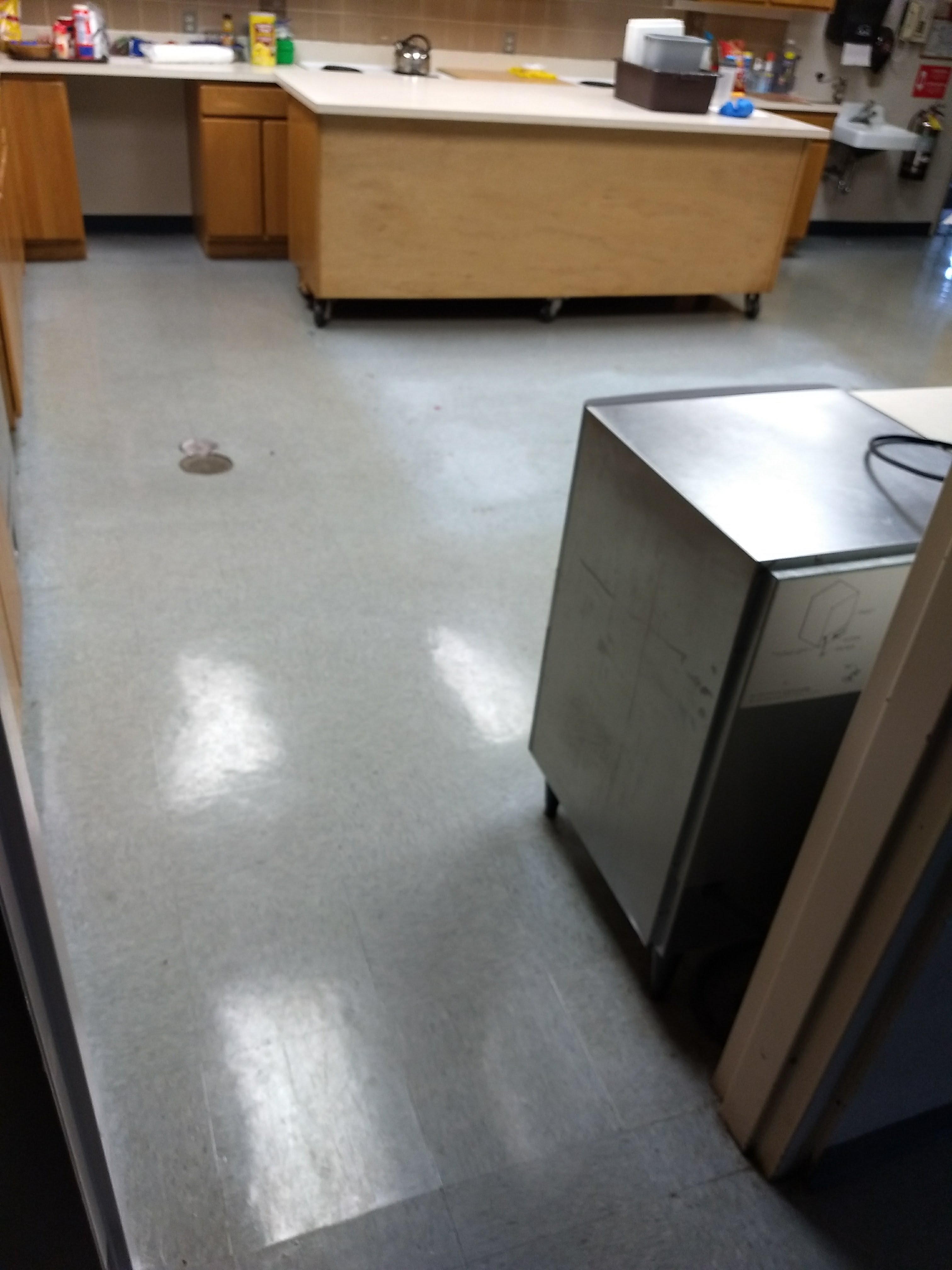

I have only done one VCT job so far. So I am a complete rookie.
A church wants an estimate to clean their kitchen.

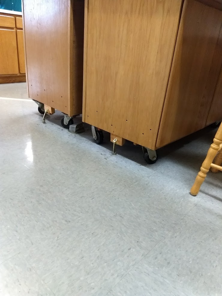

They have these big cabinets on wheels. I am wondering how you would clean this job.
Would you just move them around while you stripped and scrubbed?
Would you strip on area and move them over before waxing? I am concerned about scuffing or dirtying up the tiles with the tires.
Or would you move them, strip, wax, and then move them back?
Any input is greatly appreciated.

I would see if you could move them out before doing the job.
The problem is that no matter how you move them arround the wax you are moving them on will not be set up enough to withstand the weight.
If they don’t really move that much you could move them to clean under then move them into their place and wax arround them. You could also come back the next day, once the wax has set, move the cabinets and wax under; but that would require a second trip.

Good advice above. I would try to move them out. Let someone at the church replace them the next day when the finish is hardened. Clean the wheels while you are there so they are not pushing dirt into the new finish as they get rolled into the room.
If you can't move them out. Move to do the floor under them. Push back into place. Do the rest of the floor.

If the cabinets don't get moved much the floor underneath might not need much work. Most of these floors don't need stripped unless they have been putting down mop n glow or some other garbage sparkle juice. If it is not in bad shape and has conventional floor finish it might just need a deep scrub with a blue or green pad, a couple of rinses and 2 or 3 coats of finish.

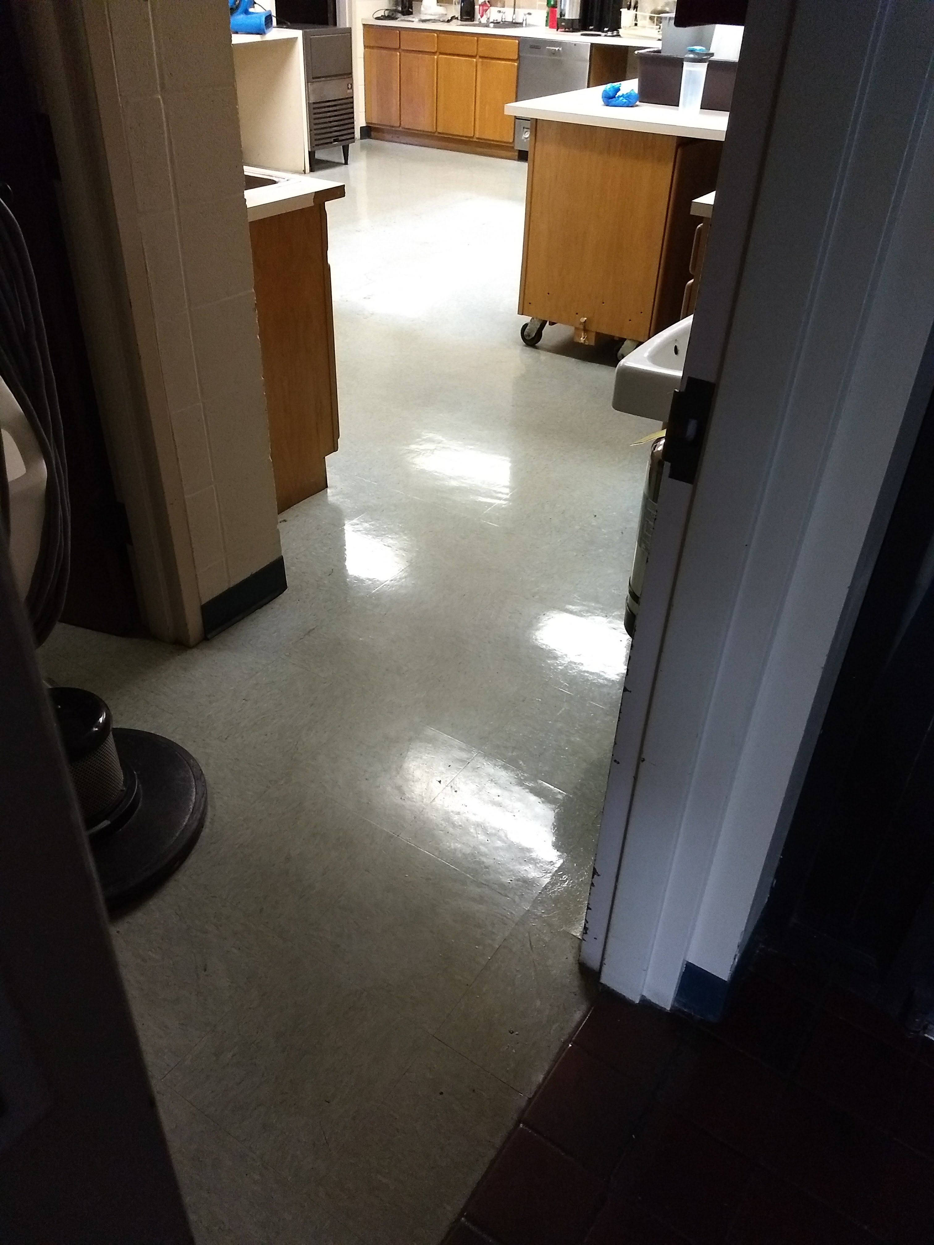

That's one of the things I am confused about. When to strip and when to just scrub. This is a kitchen in a church and I don't know if they have used mop n glow or not.
The other thing I'm confused about is when to stop stripping. How can you tell when all the wax up up?

Ask them how they are maintaining the floor, or check the cleaning cupboard for any mop on topicals
It looks like there is a topical on there from the reflection, I'd strip it back if they want more finish applied as not all products are compatible.
If you can scrub it back and there is no remaining discolouration then you dont need to strip it, provided you are reapplying the same finish

I would just move them. But in the case I couldn’t, I would square scrub dry strip and move them from side to side. In the event I couldn’t move them at all, I would square scrub around them.
Went back today. Could not find anything besides fabuloso. Not sure what they are mopping with. I may hear from their custodian this week.
They do have a few gallons of finish. So you think I could take say a green pad and scrub the floor. If I am not using a stripper would I use a neutral cleaner? Scrub the floor until the darkness disappears and then apply a couple coats of their finish. Does that sound logical?
The only other one I did I stripped with a hi-pro pad. I got everything off that floor. I guess I will need doodle bug pads of the same color as my circular pad.

I measured today and I can move one of them out. The other will have to stay. I am thinking of scrubbing underneath, moving back, and then finishing around it. The only areas that would not get extra finish would be under the 4 wheels. They don't seem to move but a little bit over time just from normal use.

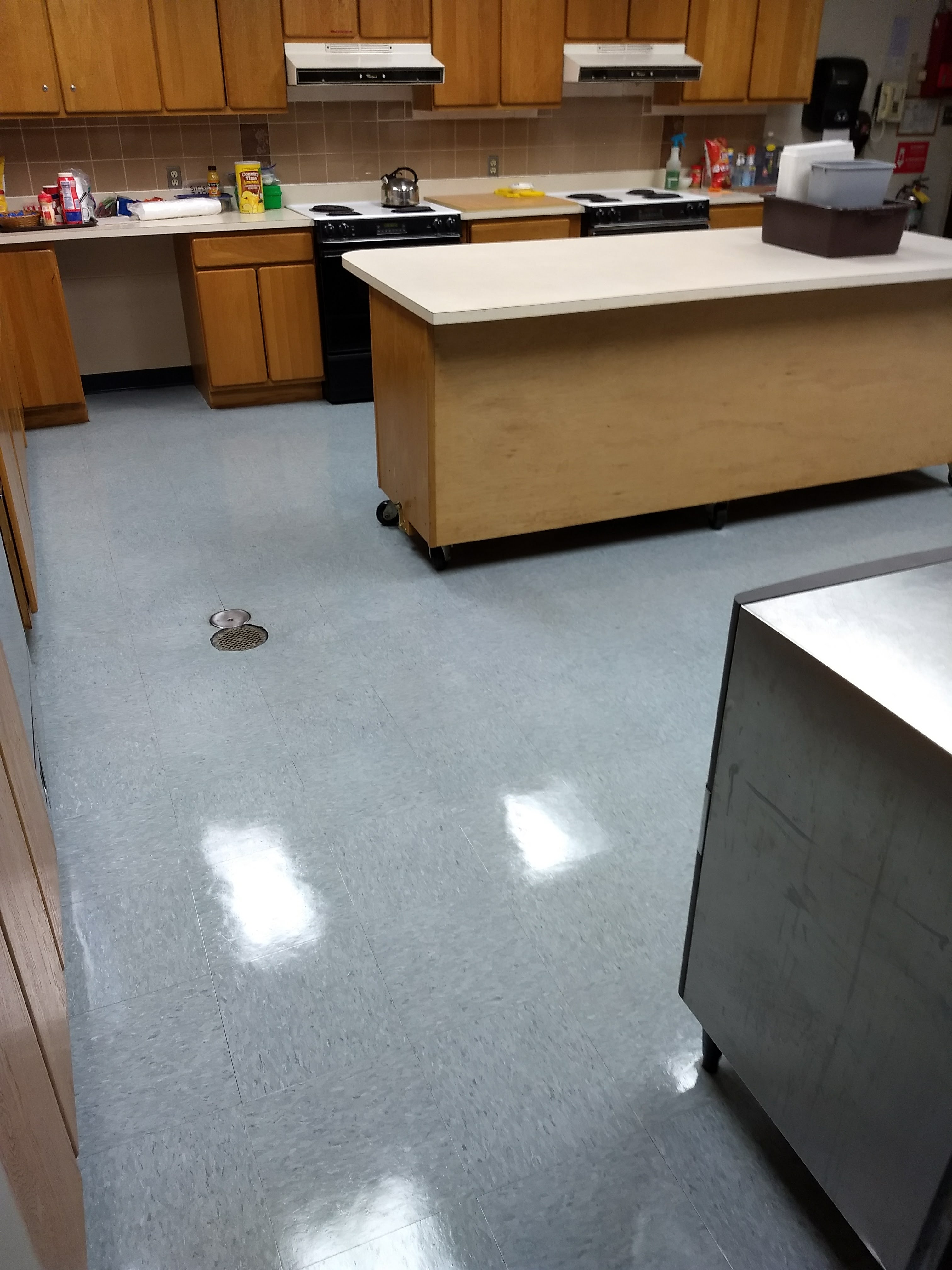

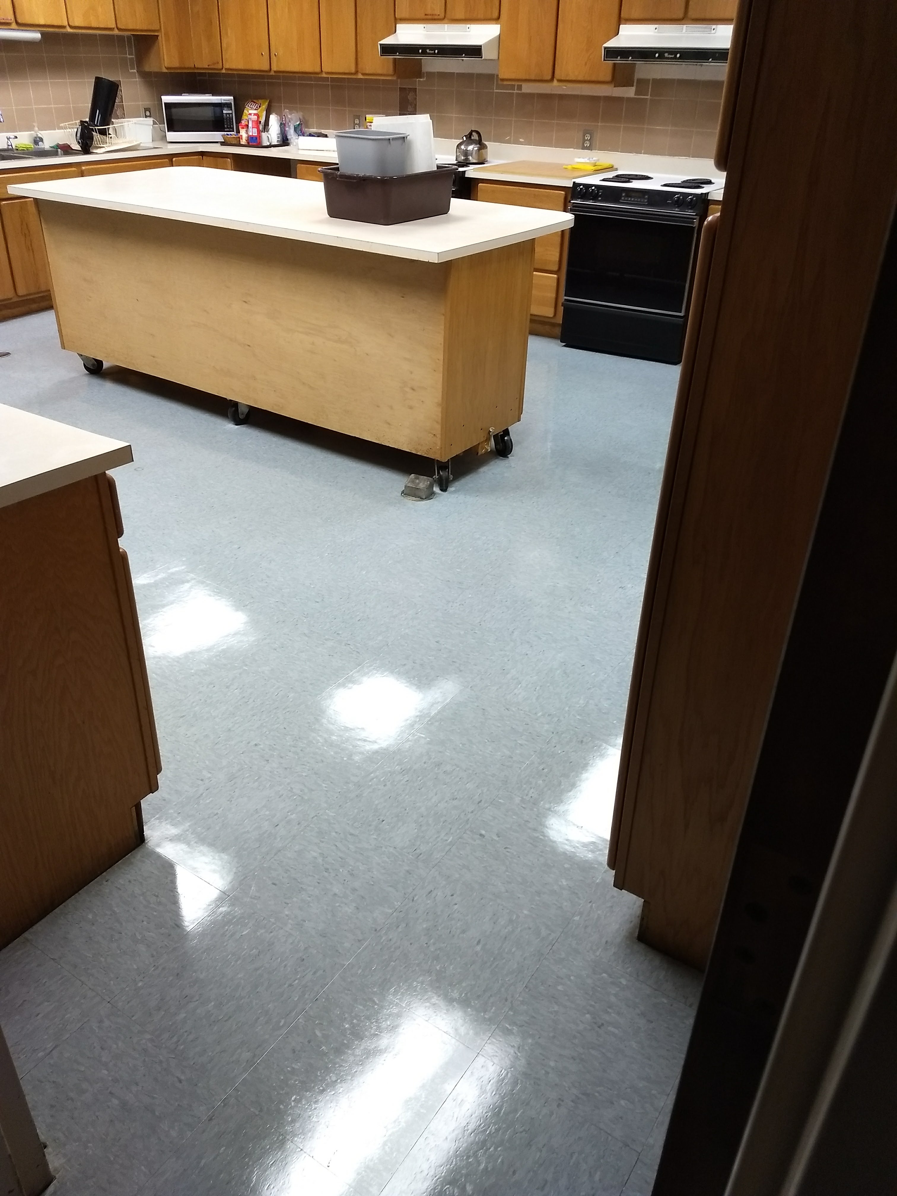

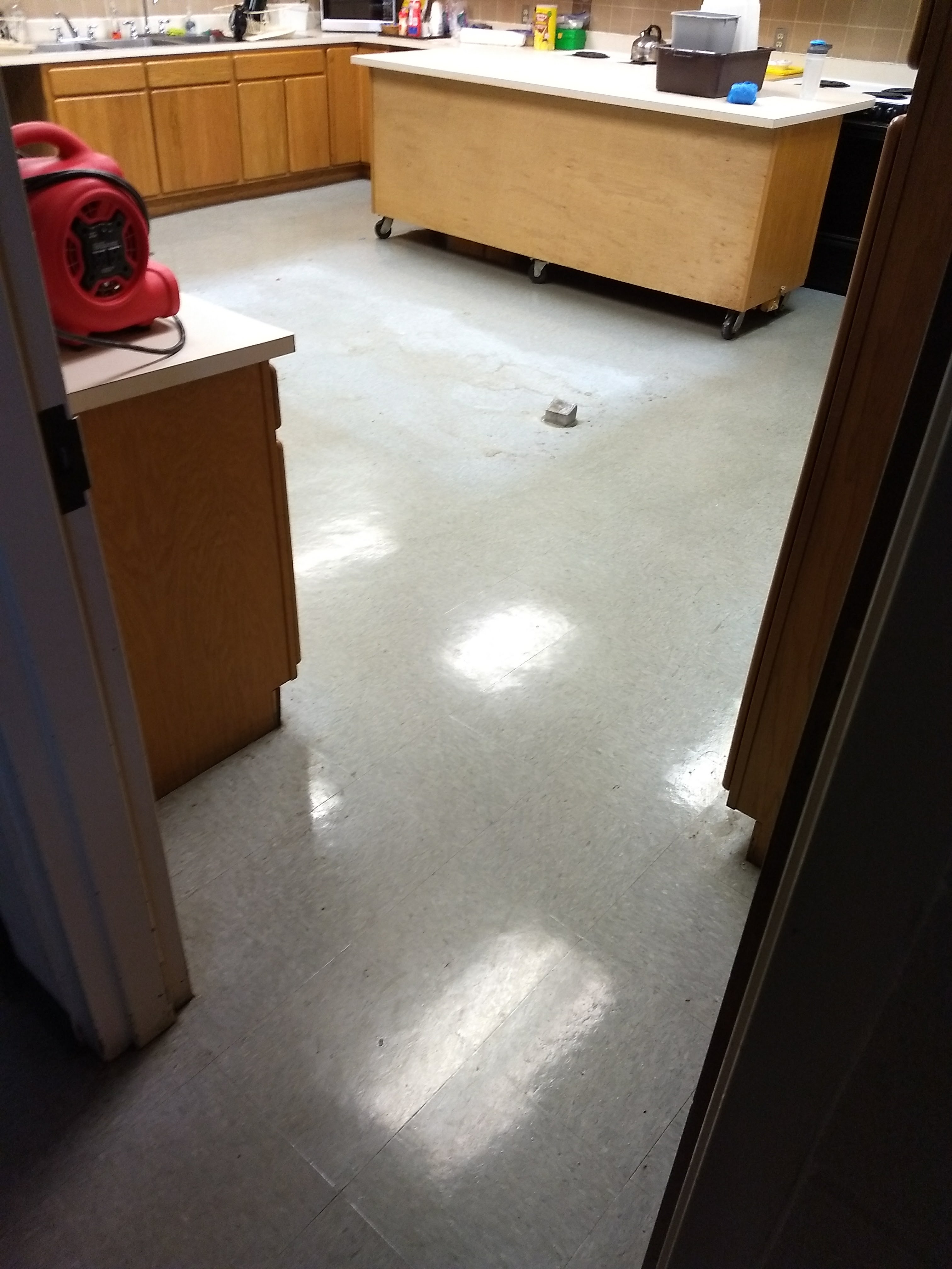

Thanks again for all the help fellas! The job got done today.
With all the time and effort I put in I was expecting a brand new floor. I could not get all the old wax up. I kept scraping and scrubbing and it was a no go in some places. It looks better though and I learned a lot.

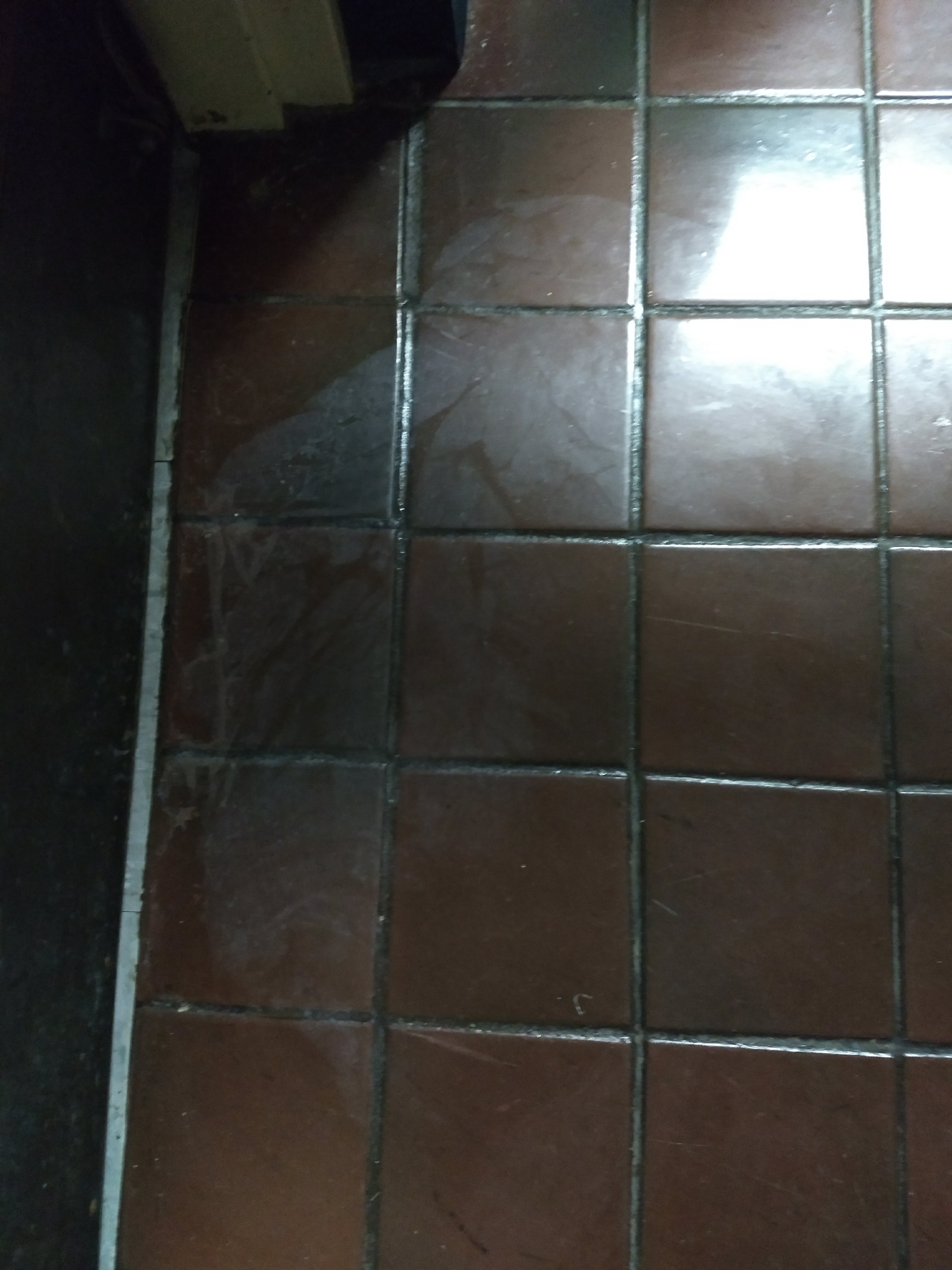

One problem I have... I got sloppy at the end and I got stripper under my tape/drop cloth. I didn't realize it and about 2 hours went by before I pulled up the tape. This is what it looks like.
Is there anything I can do for that without making it worse? Or should I try to find someone who can fix it for me? Is that "quarry tile"?

They're all a learning curve if following someone elses work :biggrin:
sometimes less stripper is more on a stubborn stripping job, mix below max dilution ratios so the old finish can mix/lift more easily and rely on dwell time with agitation
looks like there is possibly a topical on that tile?
