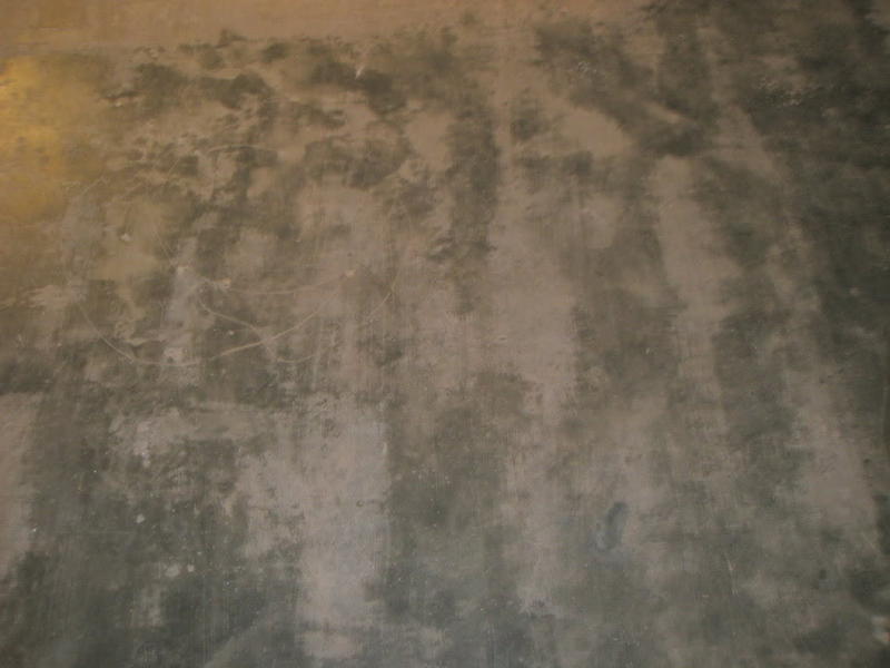

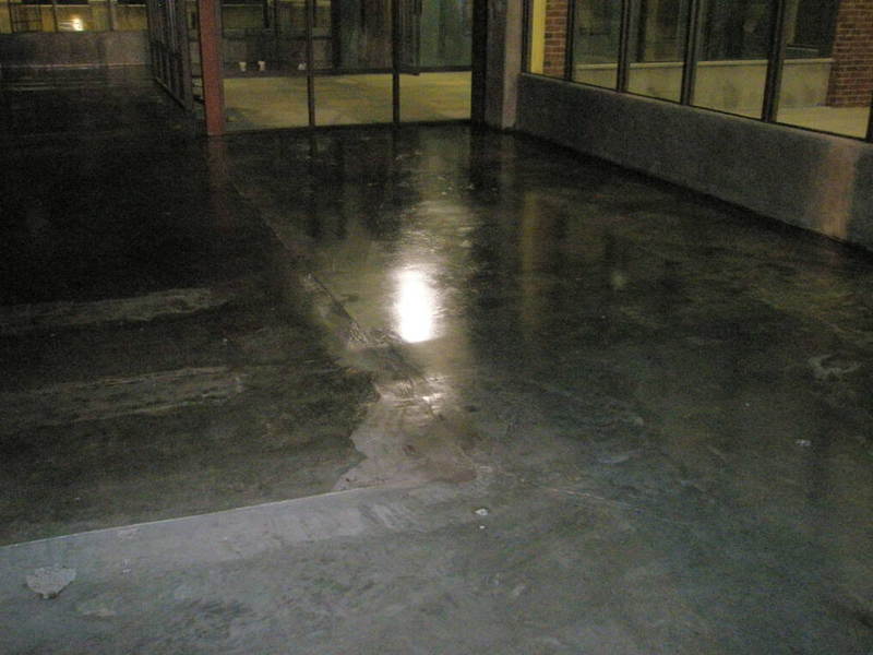

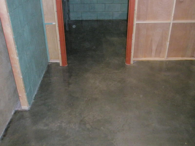

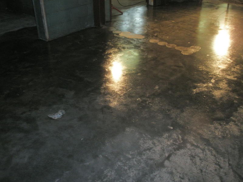

dont beat me up to badbut here goes
albums/dd138/69ron/P9280442.jpg[/IMG]
those are before
after
wood eye do that.... :twisted:
kind of tough to make that floor look "great"
it's shinny though...
BTW, you missed some CRUD in the corner :mrgreen: :mrgreen:
