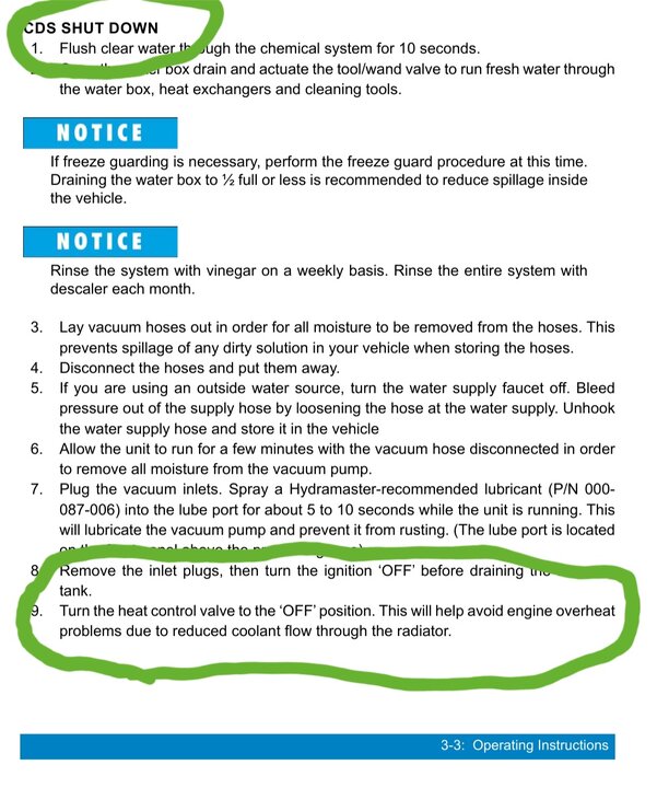

I didn't read it on Google AI originally, I think it was mentioned briefly on one of Hydramasters maintenance videos. But they recommend leaving the coolant valve closed while driving as to not overtax the engine coolant system. I assumed they meant it would overwork the water pump but I never thought about it much and just closed it every time I drive. Anyways this came up on Shmoogle AI for what it's worth:
"Based on information found in HydraMaster manuals and forum discussions, you should never leave the coolant flow open while driving, as
this is a potential cause of overheating. The HydraMaster CDS (Clutch Drive System) is designed to operate only when the vehicle's parking brake is engaged, and the control system should shut off the unit if the van is put into motion.
Here is a breakdown of why this is important and what can cause it to happen.
Risk of overheating
The HydraMaster CDS uses the host vehicle's engine and coolant system to operate.
When the unit is on and running, it places an extra load on the vehicle's engine and cooling system...."

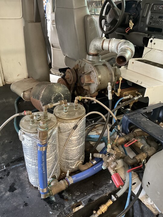

If you look closely at the diagram and can read / picture the flow youll see that my system is paralleled. A paralleled system can be closed off whereas if it were in series it couldn't be shut off without effecting what ever else is up or downstream

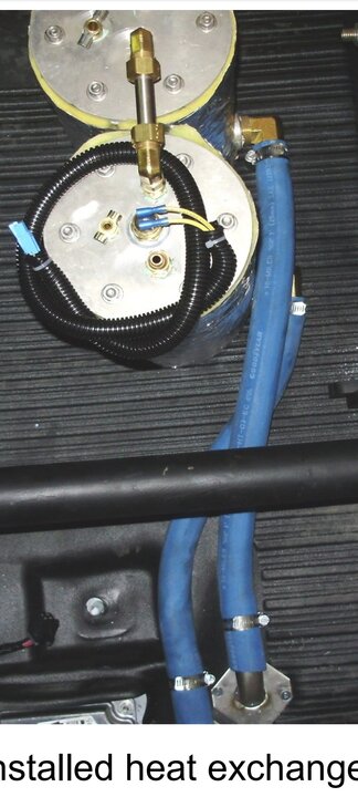

From the diagram it looks like one HX in your setup receives coolant from the inlet side of your engine, and the other HX receives coolant from the outlet side of your engine. And yet each HX flows into the other HX directly. Its like a big engine coolant party you have going on there Dwain-o. Forgive me I don't understand the difference between parallel and series setups. I should because I learned about that in DC electrical when I was setting up solar panels on few RVs and a cabin. Maybe that was completely different though...

No it recives heat from the upper radiator hose going from the engine to the radiator and it returns spent coolant back into the engine thru the heater hose in

Like i said i don't know how your system is plumbed. Ive never had to shut off my coolant on any pto ive had. I dont think cleanco or butler even have a valve to shut it off. (The diagram i sent you is cleanco with no valve mentioned)
If they say shut it off id call them and ask how important it is to do that. It seems to me that coolant flow is more critical when the van is stationary that when moving. From what trouble shooting you have explained according to you valve open temp fine valve closed temp varies. And that and how my machines run is all i have to go on to base a recommendation

How do folks tune down their heat when cleaning cellulosic fibers if there is no coolant shutoff valve on their TM? Does their setup just have an adjustable valve for fresh water to bypass the HX instead?

I dont run into many instances where i need to turn down the temperature i do have a separate quick connect that bypasses the salsa unit and only uses engine heat. But to be honest, i installed that because mixing chemicals at idle the salsa unit cooled the soulition too much to properly dissolve powders and i needed a way to bypass it to get more heat not less
