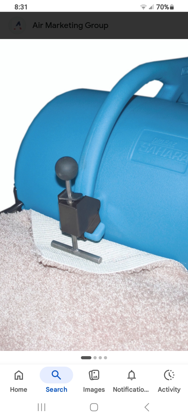

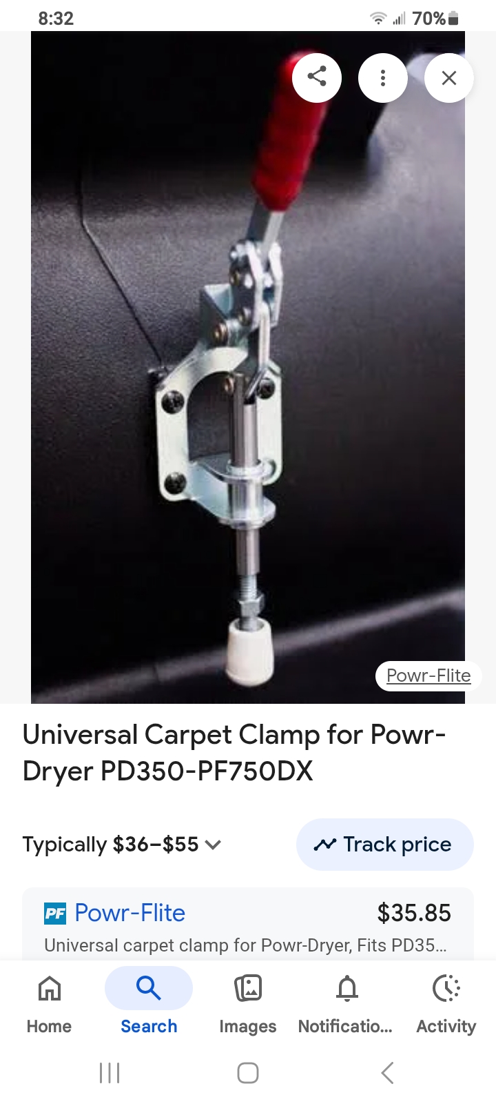

- Rugs dry in the shape you leave them.
- Do not leave flat on plastic without airflow.
- Elevate one corner and place an air mover beneath to create cross-ventilation.
- Use clamps if needed to stabilize airflow.
