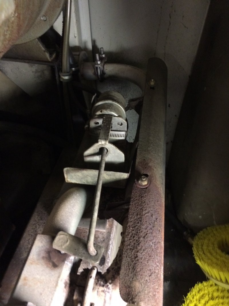

I'm trying to source exhaust diverter vacuum pods for my White Magic Pro 1900. Anybody have any info on where I might be able to find one? This is what I am looking for. IMG_0163.JPG

I bought Vac Pods for my CDS from the auto parts store but they didn't look like that. Do some digging at NAPA or take one in and let them look through a catalog. Someone has them but it might take a bit of legwork to find them.

I think I see the Vac Pod that you get from Napa in the back of the pic, it looks like it held in by a worm gear clamp. I would need a different picture angle to see for sure. The Vac pod at Napa are used for for cruse control on older cars.
