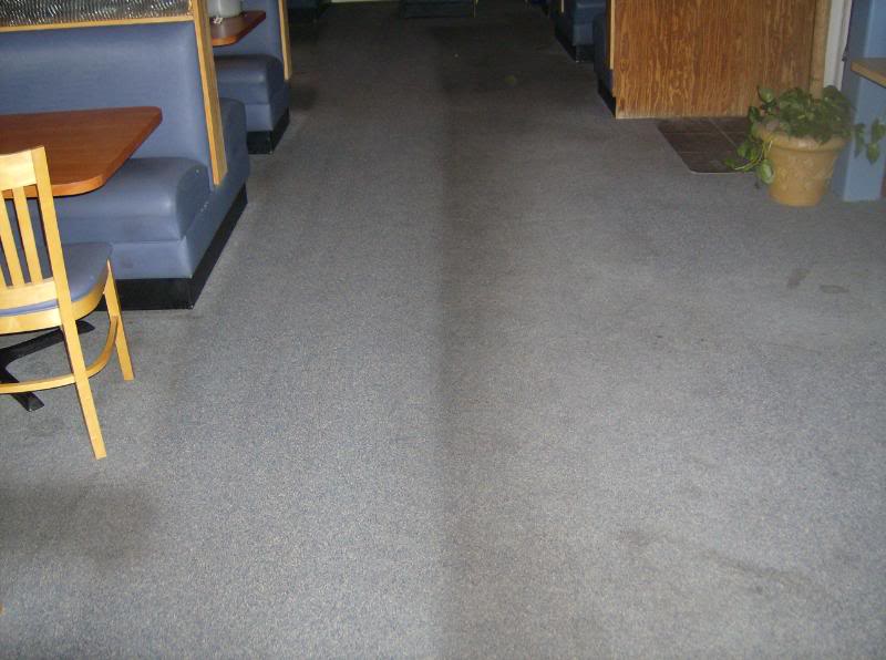

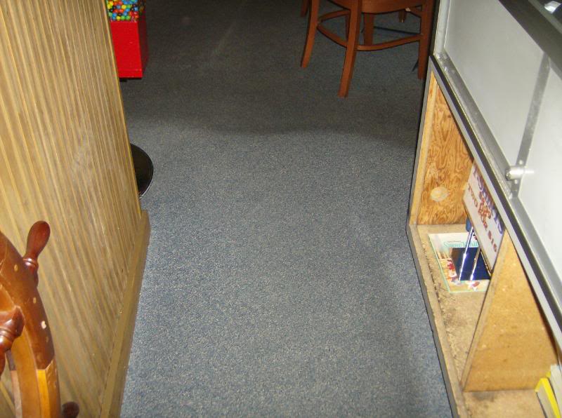

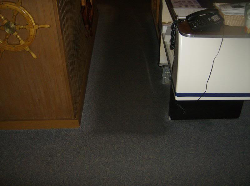

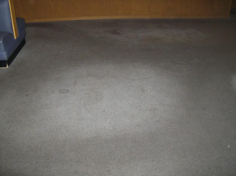

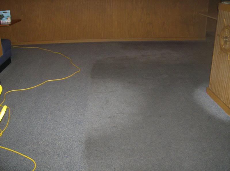

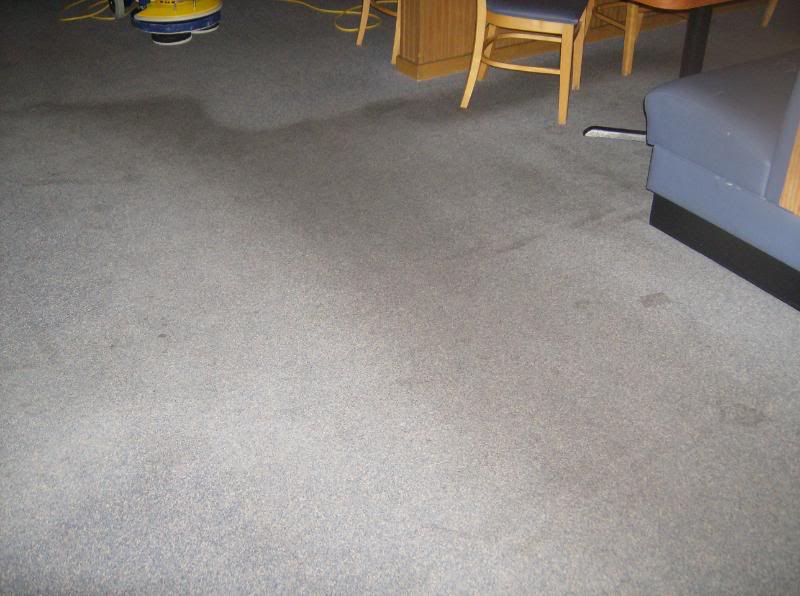

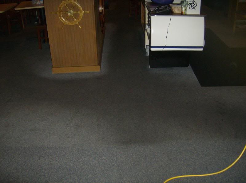

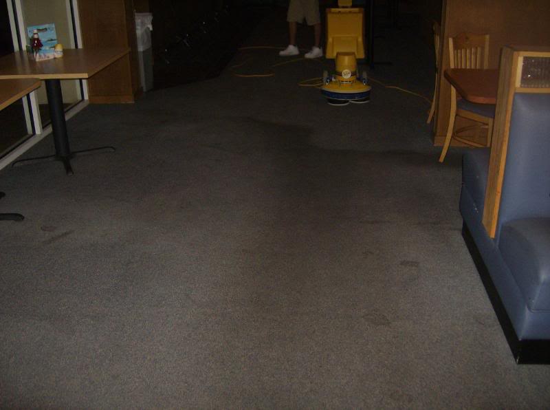

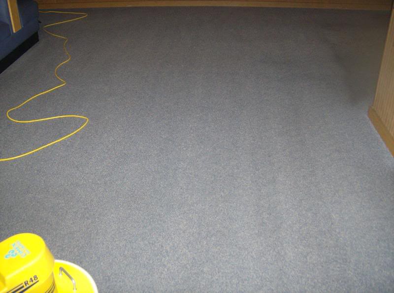

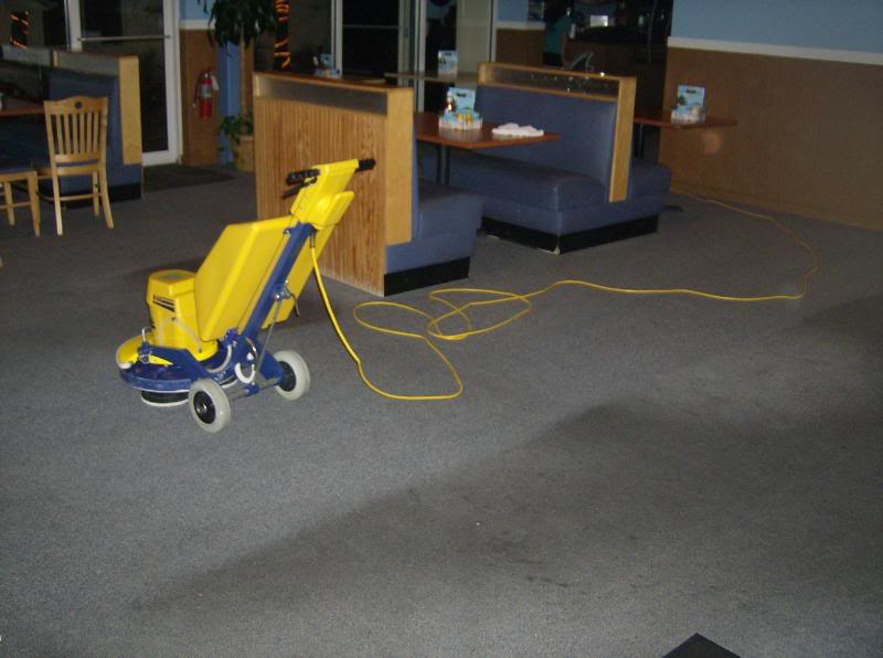

it is a seafood joint that i quoted about 6 months ago..i was too high so he kept getting it done by cheaper cleaners..it looked like crap, they had it wet for 2 days after the cleaning and it soiled back up in 2-3 days..he finally called.
i decided to bring the cimex along for the ride just to see what it did. i was ready to stick it but a few passes with the cimex and bam!!! it was awesome.
i went a little heavy with the Releasit ds..instead of mixing 4oz per gallon i was mixing 6 oz per gallon. super hot water and away we went..
excellent supply was great with the tips and were dead on with their info..
here are the pics
i will try to put them in a before and after order..

not in my pocket with the money..the owner asked how i was able to get it clean when 4 others had not even come 1/2 that close to denting it..
i told him it was a old Chinese secret and i would have to kill him if i told him...he laughed as he handed me my check..i will be doing it every 6 weeks, i will have to figure out when and how often i will stick it to give it a rinse out..

i am pretty sure it was a lot of residue from the others..it was pretty black in areas but only a few times did it act like it was a solid surface..
the restaurant is 1280 sqft and it took us 2 hrs, but we moved all chairs and tables.

All that black from the before pics is now down in the carpet. If you would have wiped the carpet with a white towel, you would have been scared. You got paid to clean the carpet and you didn't. I love the mex, but only were a tm won't go. I am not going to debate this and I am glad there is a new open spot in the top 25.
