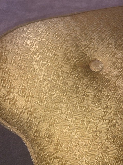

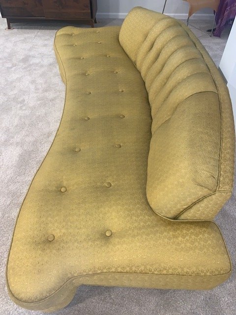

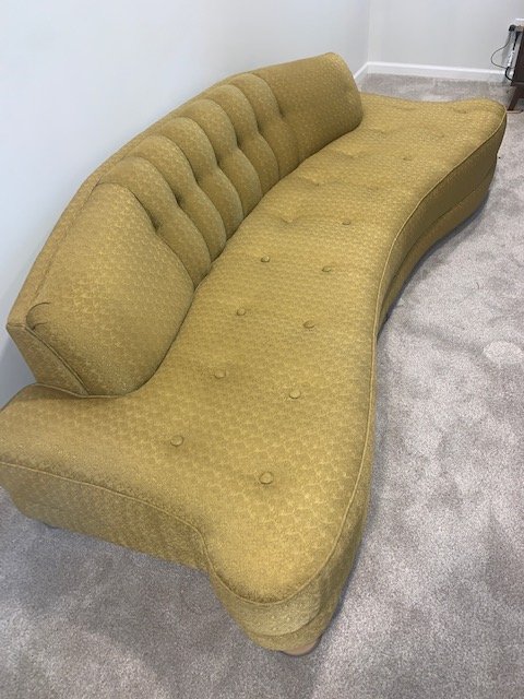

Cleaned 2 sofas yesterday, one was pretty clean and I cleaned with All Fiber Rinse. The second one had some ground in grunge and I soft scrubbed with BP Fabric shampoo and rinsed with All Fiber Rinse. Went back last evening after leaving dryers on them and I was not pleased with the results, the customer was OK but I am not.
Any ideas how to get this sofa on the right photo looking acceptable?

It looks okay in the photos-- but If you are not happy- just clean it again the same way you did the 1st time.
It's an old sofa, probably stuffed with unfinished cotton, and may have decades of embedded crud in that stuffing.

The top photo is the clean one and the lower photo is the one with grunge. I will go back with the Encapuclean O2 and see if I can get it to brighten up.
