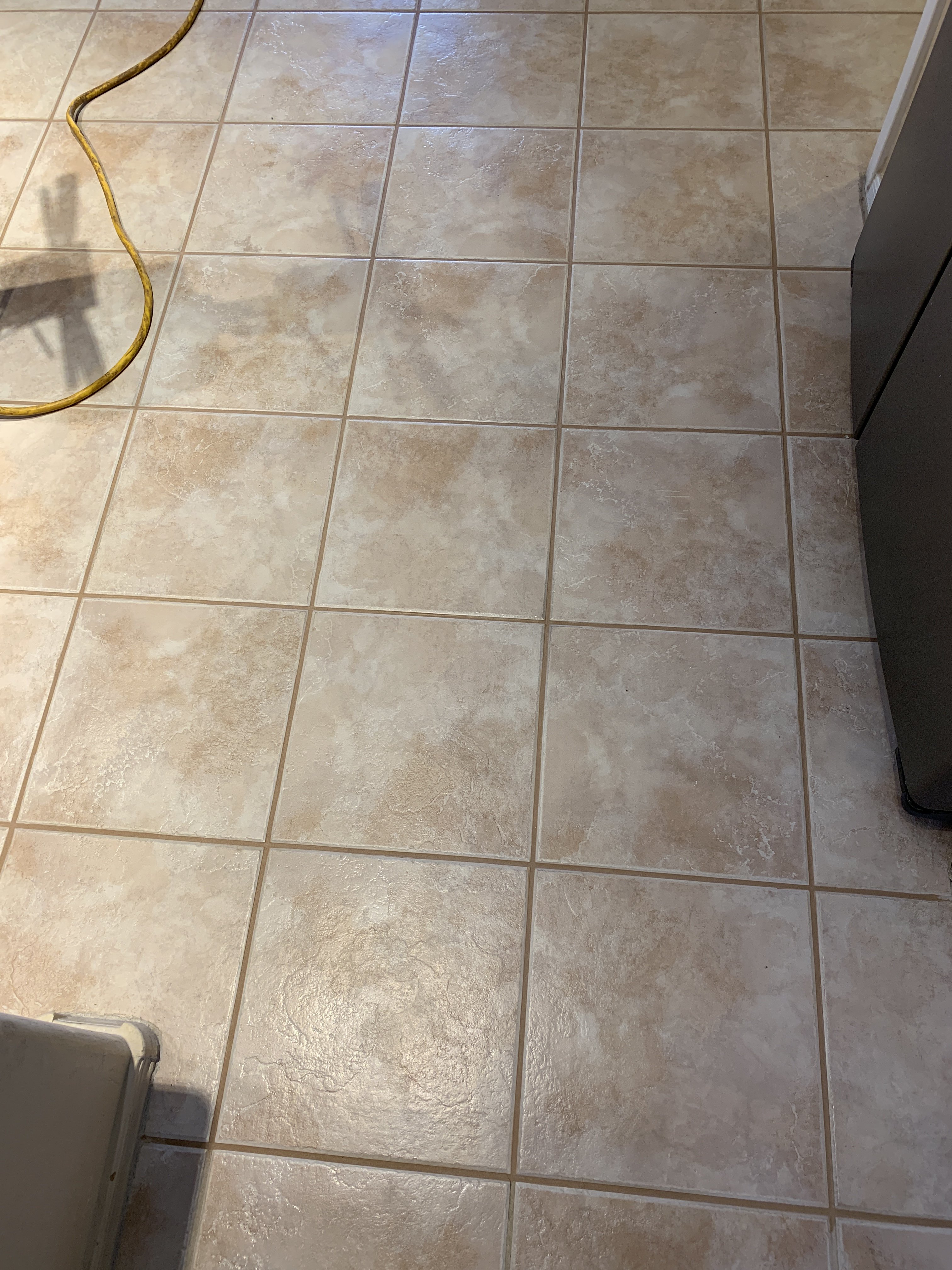

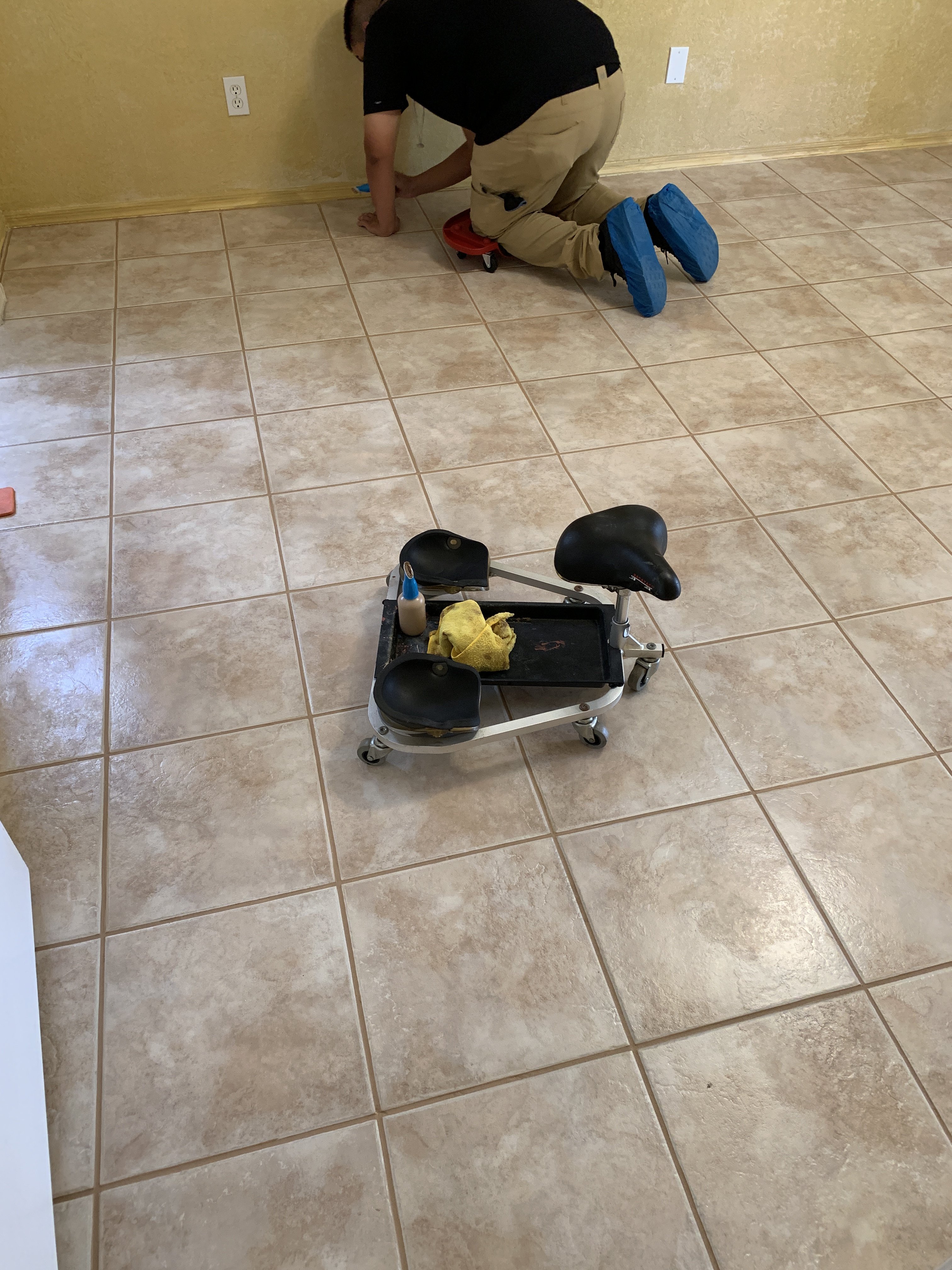

Just tried these turbo seal. Made color sealing much easier, anyone that has color seal jobs coming up I recommend buying.
