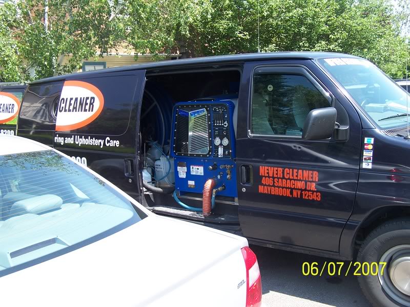

I looked at Billy's econoline and I liked the way he had the hose reel and the tm out the side door. I like that it will leave the back completely open. I have a project now for christmas break. Billy did you like it that way?????

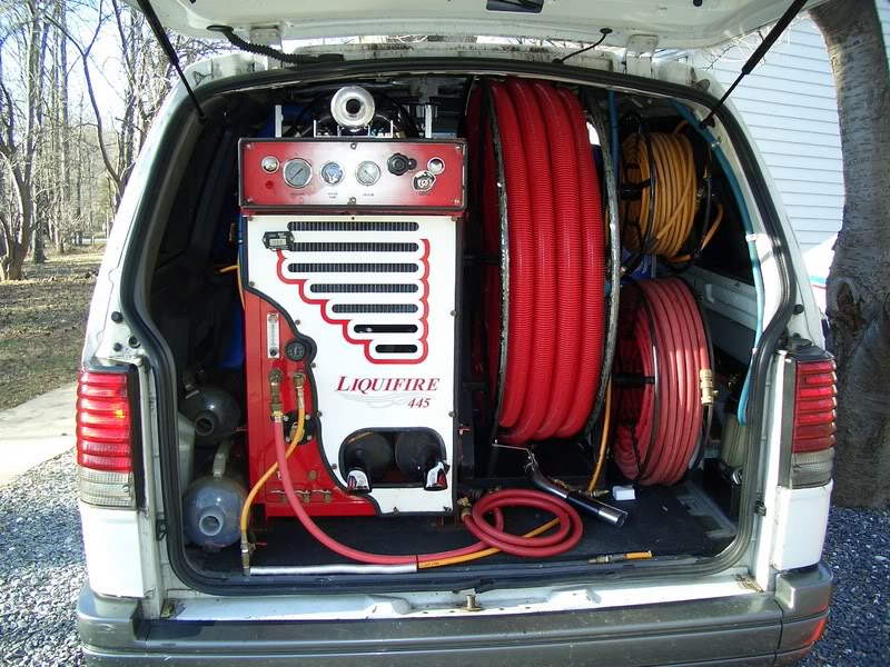

FastEddie
Oct 19, 2006
435
Doug Cox said:
In what world are you going to fit a TM AND a hose real next to each in the rear of a van. I want to see that happen.
Rear for me, and to answer your question, it can happen.
[/img]
Billy
Oct 8, 2006
792
BH
Mister Sir 8)
Thanks we used it that way first without the sub mount water tank then with a side mount water tank & finally with the custom designed & made sub mount water tank.
It has been great to work out of I designed it the way I did so that I could have as much usable space as possible. I also wanted to cary allot of hose, equipment etc.
One note it isn't a standard E250 it has had suspension work done due to an unscrupulous salesman telling me it was more than enough before I knew anything about vans.
If you have any questions or need any help with it just let me know or feel free to give me a call. If you decide to go this way you will like it allot. Very easy to work out of for a van setup.
