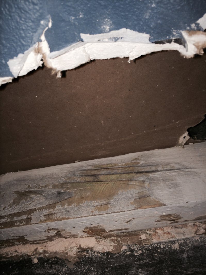

The sill plate? or up against the wall.
What is beneath the board? If against the wall is there foam board.
Any pictures?
Im not sure the technical term. I think technically its a bottom plate as a sill plate refers to something that has an open cavity underneath. This board is flush into the concrete slab floor and there is nothing behind it except the foundation of the house. This picture is of the same board along the same foundation wall in the water closet. This area did not have mold remediation. The framework and foundation is identical to the ones on the bedroom that share the foundation wall and bottom frame board. The only difference is the walls in the bedrooms have insulation and sheetrock. The sheetrock has been cut all the way to the wet insulation and all wet stuff has been romved. Plenty of air flow.

I agree with Fred. Take a knife and scrape a little of the black coating off then use a delmhorst or other pin meter and take your reading. Compare it to a dry standard reading from an unaffected room. It could be the coating has some metals or something elses allowing to conduct. This would give you a false reading.

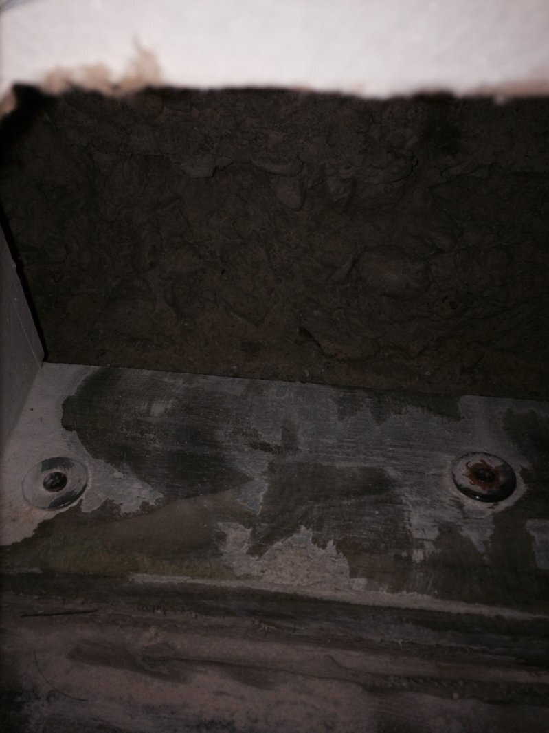

The board in the picture was treated/coated with something. That board is now reading 8%. That same type board in the bedroom where the mold was previously has the same green thing on it but was also painted white. The studs going up are also painted white. We decided today that there must be some type of moisture barrier in the paint/finish that was holding moisture. We used a wire brush on an angle grinder to remove the white paint/green stuff in a small area. The wood beneath that was still pinning out all the way. So we determined that it was not a false positive. We grinded the white paint off of the studs running up the wall in a few test areas and there was no "green stuff" there and the wood beneath the paint was dry. So the wet area was only along this bottom board that had "green stuff" then painted white. We grinded it off enough to hopefully let it breathe and dry quickly. We had never seen this before and neither had the adjuster. Just wanted to put this out there for everyone so they could add it to their notebook. I originally thought it was moisture from slab or not enough airflow or dripping moisture from the pool above/behind foundation. Im pretty sure we are spot on now but will confirm tomorrow.

Do you think its false reading if I grinded down to what is for sure wood? I took my test area down about an inch just to confirm that it wasnt still touching some sealer and giving false positive. But if they put something that penetrates wood with metals or something then I could be off.

Looks like pressure-treated lumber to me - if so the green stuff will be all through the wood - not just surface treated.
So the moisture came in from below & behind when not coated and became trapped by the coating?

yes, the water was 2 inches or so high for a few days so got below/behind the sealer and the sealer is now trapping the moisture. opened up the boards hopefully enough to breathe but even when you take a chunk out of the wood the green is still in there. i feel like it will breathe though as when first grinding it had a plastic smell and when i got deeper you could smell the sanded wood aroma
Pressure treated wood? Can you pressure treat wood once its already installed? Because most of the other boards are not like this. Only the areas that were in the mold area have this green stuff. Im not certain that they opened up all the walls during mold treat or not but will ask the homeowner in the morning.

No, PT wood comes that way, but it's typically used where it comes in contact with concrete, I see it used for bottom plates a lot below grade.

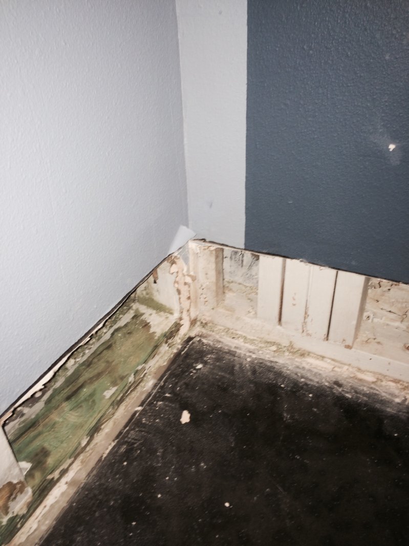

The picture I posted was from day 1 when the guys were extracting water. The board in the picture is also not the one giving me problems. It was just the only picture I had on my phone. All of those bottom boards running against the slab have some green stuff sprayed on them previously. The bottom boards behind the bedroom walls had the green stuff and then white paint on top of the green stuff. That combination created a very thich texture almost like gum and was holding the moisture in the board. The bottom boards that just had green were drying and the bottom boards that just had the white paint were drying fine as well.
I am heading back there shortly to confirm what I finally figured out. I will take some pictures so everyone can see what I am talking about. Hopefully this will help some people in the future. The adjuster was a seasoned adjuster dealing mostly with water damages and he said he had never seen it either. I also spoke with some friends in the business and they had not seen this.

Just checked it and moisture is coming down quickly since I sanded the goop off. Down to 25-35% already so should be dry soon.

The bottom pic is a good one to see the difference. Wall on left has the green AND white. Wall on left is just the white paint.

BMS usually supplies crews with Zinsser Bin Primer/ Shellac... I'd reapply it and test it before closing in the wall, if your doing the repairs.
