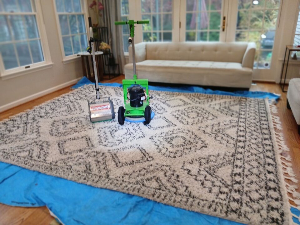

Yes Odyssey is very easy to use and easy going up and down stairs
Before you go into customers house make sure you practice on your carpet
It does have some vibration so you need to be careful around walls shelves and tables
Some bonnets grab carpet more than others and can cause more vibration
Make sure you use a good sprayer and put down enough solution to clean and lubricate fibers. Not enough solution can cause bonnet to grab carpet and cause more vibration
I don't like 10'' CRB's because they are too light to scrub with and too slow but for Area Rugs and to groom carpet after cleaning they work perfectly
I used 10'' CRB to scrub and groom and light blue Microfiber Bonnet with Odyssey to extract on that Area Rug

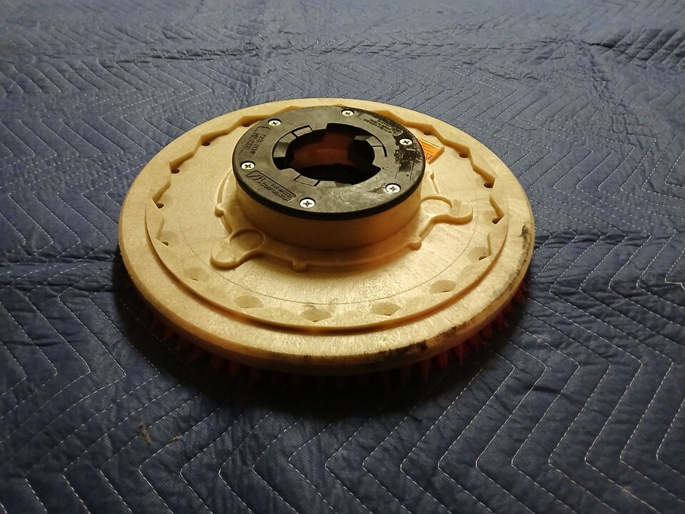

My friend who went all VLM also has the 13 inch Hawk but he ordered it with the big wheels like the Swirly, which is made by Hawk. He likes it but find it small when doing large empties. I'll let him know he can get a larger driver. He also has a CRB, Phoenix and cimex.
You need to put a riser on the driver to lift machine up so it doesn't rub
My Hawk is a 175-300 so it's powerful enough to use bigger drivers
If he has a small motor on his Hawk it might not be powerful enough to handle bigger drivers

I would always use a riser for my Clarke 17, so I could run a 19" black stripping pad. It was the perfect size for a stripping tool. It didn't take long
to upgrade from the 13šŸ˜‚
28,277
I think his is the 1hp. Might not be powerful enough.
