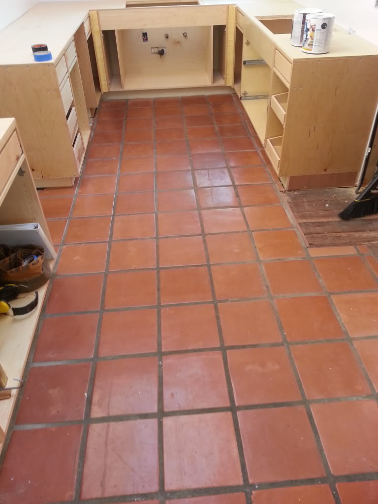

today's Saltillo Job
116,175

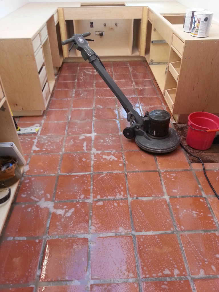

just these 70 or so feet took 2 hours to strip.

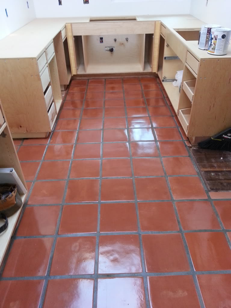

I'll go back tomorrow to apply 4 coats of wax/ finish
pretty much have to charge $10 a foot to make carpet money stripping Saltillo tiles.
20 plus year old floor, never dealt with..

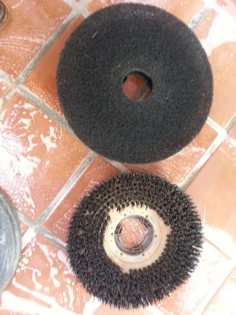

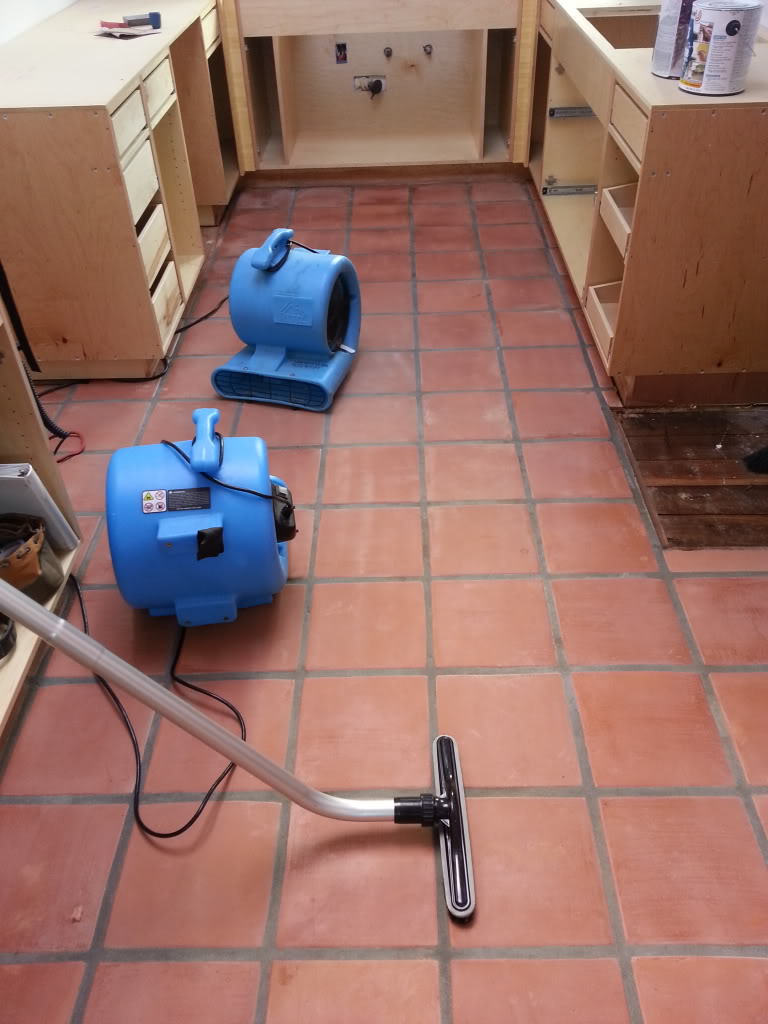

soaking in Zep stripper
Went over and over and over with a Malgrit brush and a black pad..

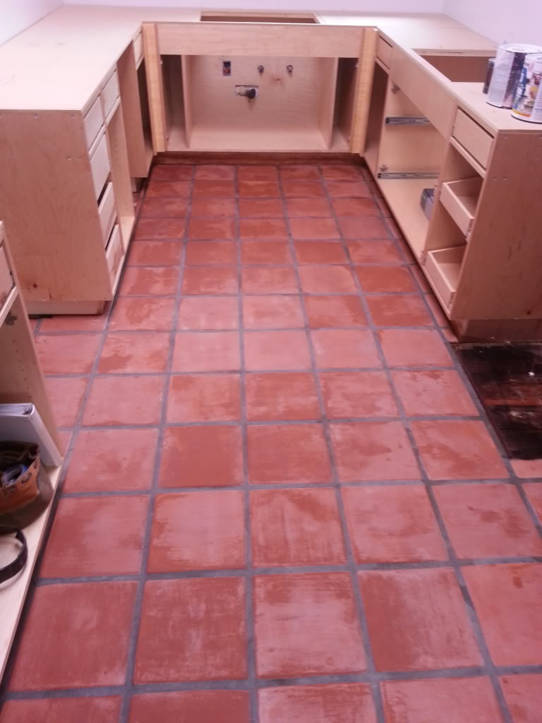

fully naked and drying..
more pics tomorrow..

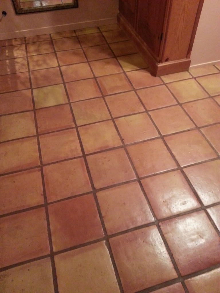

she paid us $650 (75 sf) and that was $300 more than her budget called for.
she does have another 600 feet of it that looks awful funny now...

I wish I had fred in my back pocket. Mike I'm not knocking the floor, but with a better finish it would have looked better.

flat mop it on Dave.
good finishes self level and dry in 10 to 15 minutes.

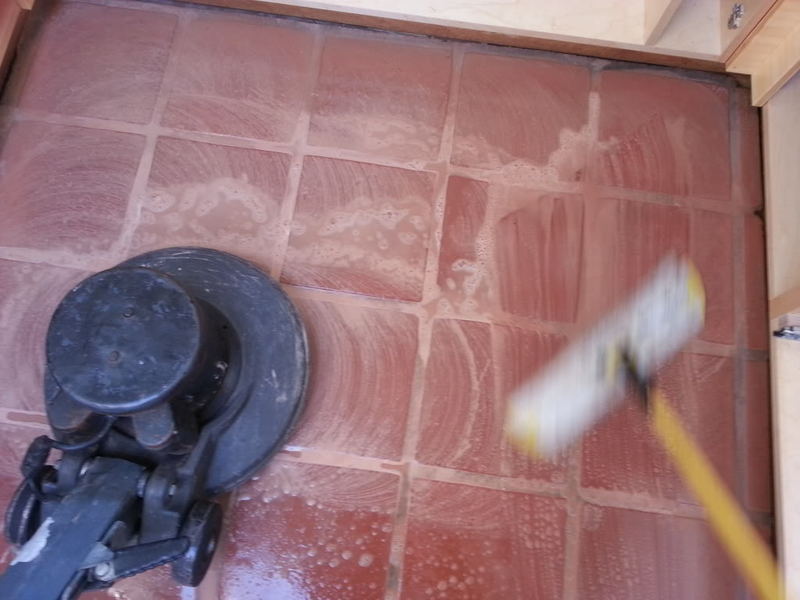

getting the old stuff off can be a nightmare, especially if different products were used over time. If some idiot put an epoxy or lacquer finish on it, run like hell.
strong stripper, scrub scrub scrub rinse repeat...
