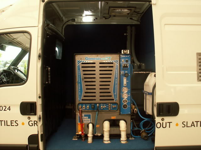

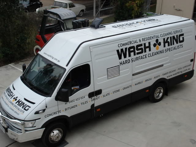

Your right Shawn, it is difficult, but not impossible. We have done it a few times with great success. In this rig below, we have done it. Since some of our competitors also read this board, I will not show the completed setup. But bear in mind that it is quite hot over here, and this is a big PowerClean Genesis which not only needs a lot of air to feed an engine of that size, but also generates a lot of radiant heat that also must be dealt with.
Again, there is a lot more to it than the photo's show, but a lot of people over here have seen this unit. Evan seen it at a trade show a few years ago when he was over, along with a lot of people in our industry over here. It is as quiet as a CDS or PTO setup. Shawn and Greenie are both correct though, it is NOT just the motor that needs attention.
But it can be done..... 8)

It looks like a nice cooling setup with the side & roof vent.
Have you taken any temperatures for warranty approval ?
Our engine manufacturers want oil temperatures & air temps running full RPM @ 100° F air temps for application approval.

Jim, that is a nice set up. Will be interesting to know more about how you did it and how well it is working for you.

I always share pictures and comments, and answer A LOT of PM’s about a variety of machines, but this is something that hasn’t been done in our country, and I am not sure it has been done in yours either. Since it cost us a lot of money and man hours developing this unit, I think most business people would understand where I am coming from. I do see your point though Brian.
Larry Cobb said:
Have you taken any temperatures for warranty approval?
Along with other things, yeah. We had to do an extensive amount of R & D to keep the engine and other component manufacturers happy here in Oz. It has been running fine for over 2 years now. There isn't a huge demand for this type of vehicle over here, but we like being asked to do unique fitouts and installs. And to keep a Genesis running cool over here in Australia whilst locked up in a van is a bit unique!
