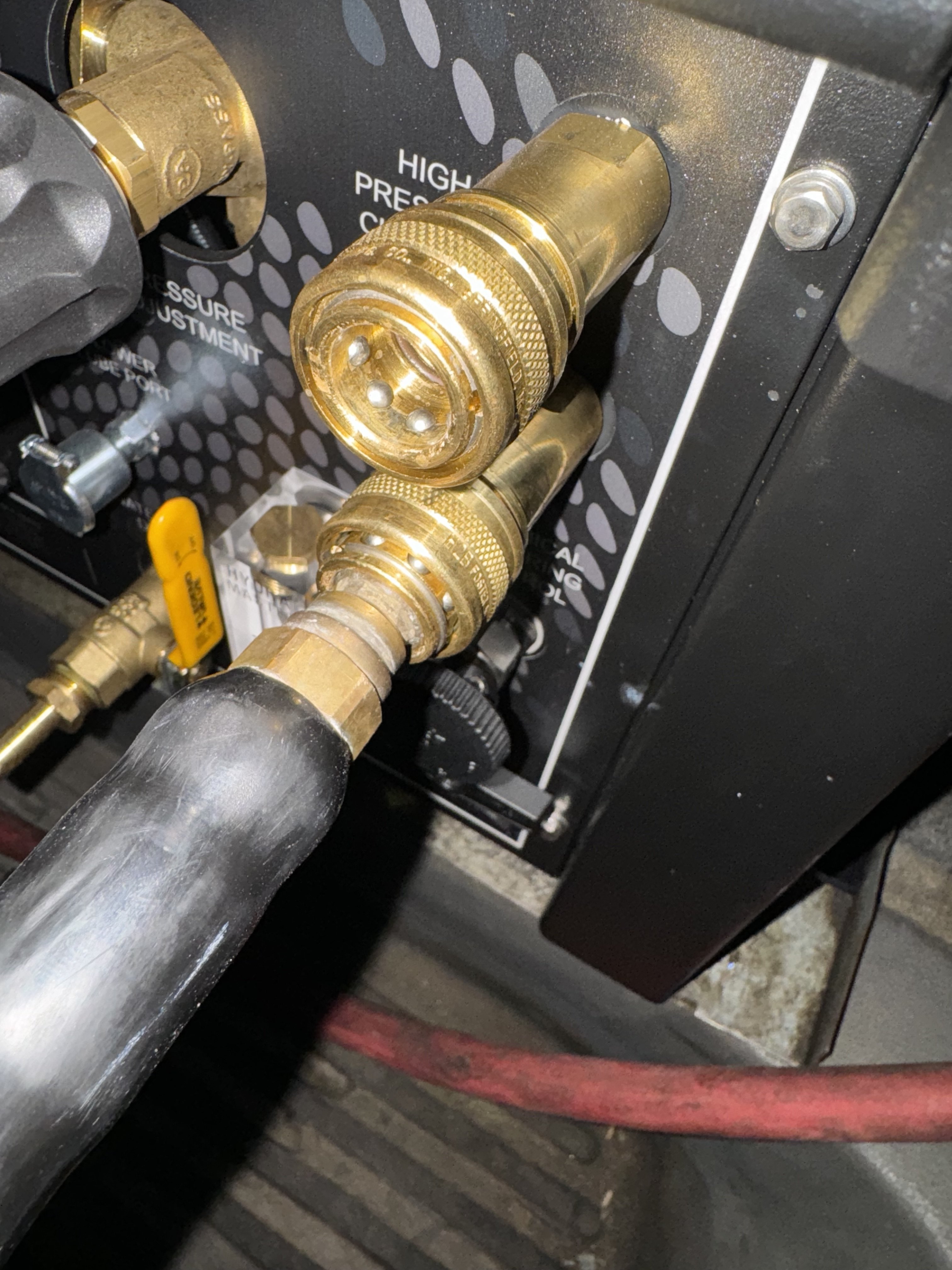

Hello, i recently purchased a brand new titan 575. For some reason the solution line will not hookup to the hp outlets on the front of machine. Feels like theres pressure built up in the outlets themselves. Is there a way the bleed this out from the machine?

push harder
use open quick connect/hose
If you have an extra male quick connect put it in there and smack it with a mallet
unscrew quick connect from panel
release pressure before disconnecting
*assuming there is a check valve maintaining pressure and it can't be relieved by the unloader/regulator

Take a pair of channel locks and remove a little brass from the male end one turn should do it.
The male and female aren't playing nice probably not a pressure issue
