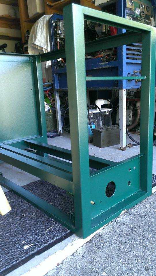

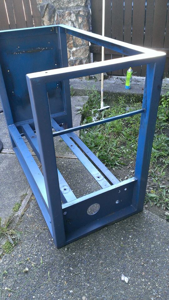

Designed a new frame. Built a prototype out of wood and took it to a fabricator, told him to copy it using. 1/4" plate on 1/4" 1.5 tube (top rails) 3/16" tube everywhere else and 1/4" aluminum face plate.
primary concerns.
1. large enough to fit bigger blower and engine when time comes
2. ability to mount virtually any type of pump
3. pump and plumbing must fit completely inside the frame 100% of the time (no pump hanging unprotected off the side of the frame)
4. everything easily accessible.
5. engine mounted on slide plate to make easy belt and coupler changes.
turned out great and rock solid
